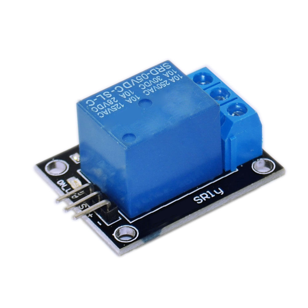

                  So, on to your project. If you are looking to simply turn the fan/light on and off and not worry about any speed control, you can simply do a one or two relay node (two relays if you have a light and a fan to turn on and off). A good place to start with wiring and code for this is the relay node in the build section of the site. This project shows how to build a single relay node with a relay module like this:
                  0_1494039288501_upload-94cb595e-9445-4d5d-8235-d627dcc9e778
                  That code can easily be expanded to use a dual relay board like the one below which could be used to control the ceiling fan and the light.
                  0_1494039367471_upload-cf0f14d7-2a05-4711-bb6f-89631aa15375
                  Without knowing a bit more on how your system is set up, or how you plan to set it up, I won't be able to help much more. For selecting a gateway (if you haven't already), I can only help with the serial gateway, as that is the only one I have worked with. There are plenty of GREAT people on this forum though that can help you with ANY issue you have. Don't hesitate to ask if you have problems or questions.
