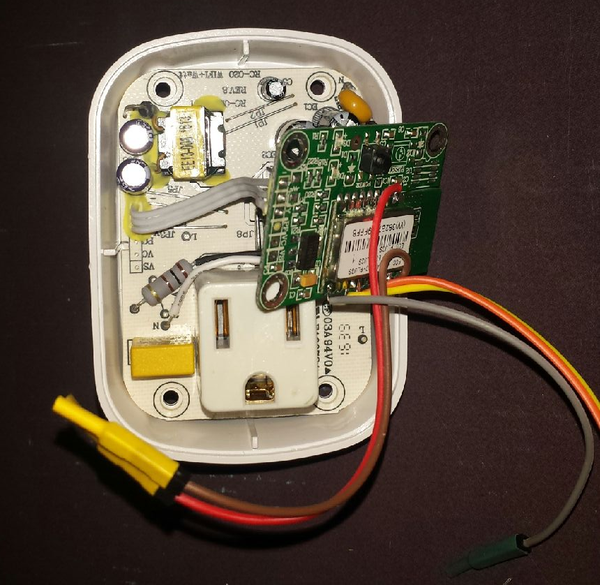

    And here is what the guts of the device looked like. This is with dupont cables connected to the module from when I reprogrammed it.

    Most of my setup for MySensors uses an nRF24 network, and based on the fact that I was having some trouble getting some of the devices to work, I thought I'd give a shot at converting these to nRF24L01+ nodes. I cut some proto board the same size as the inner module and drilled identical holes to make it fit the same as the old 8266 controller. Space was a real concern as I needed to get a pro mini and an nRf24 radio inside the case. I used a 3.3v pro mini with the radio connected to a harness so I could tuck that around the plug socket for space. Here is a picture of the first new test assembly next to the old original controller. I was able to incorporate a micro-switch and an LED to show the on/off status of the relay. The switch works with the front power button on the cover. The radio is hanging underneath the white board with the colored wire harness.
    0_1486800436701_upload-5bc3fdbb-8674-4df2-84a2-f894965fb9ae
    Since the board connected to the main power board with 3 wires, it made it easy enough to connect. The 3 wires were GND, +5V and relay signal.
