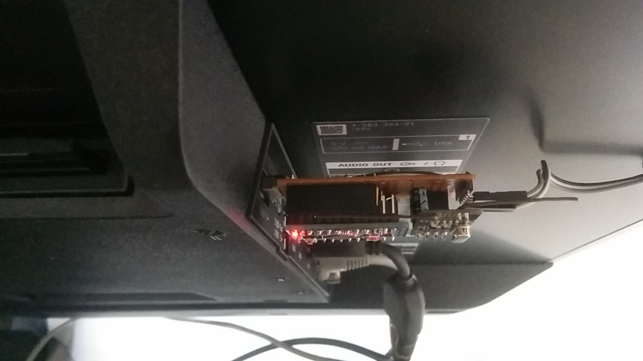

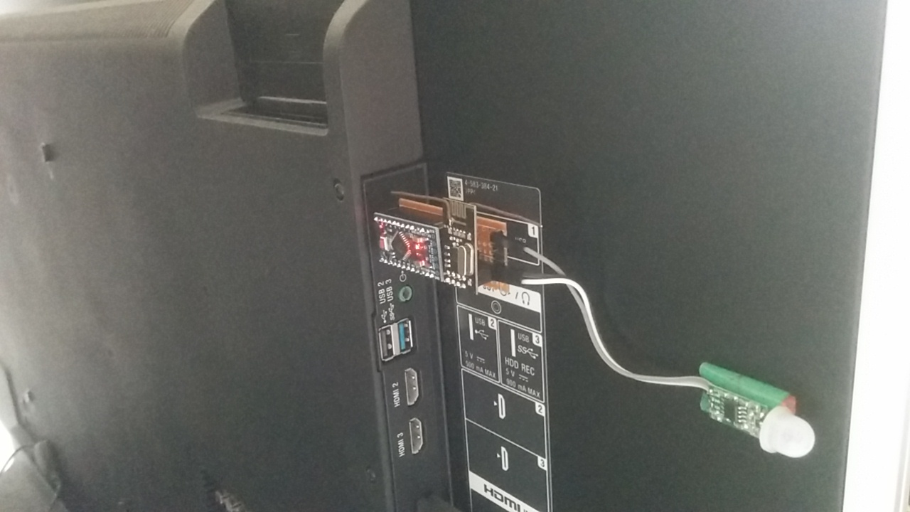

  • I guess this thread should be in the hardware forum.
    But if someone find this thread i can share some pictures and the idea with this node.
    I built it as a USB-stick with a USB-connector on a prototype PCB.
    Not good looking but when i get my TV up on the wall you can't see it.
    I use it to turn on light in the bathroom at night if my kids visit the toilet.
