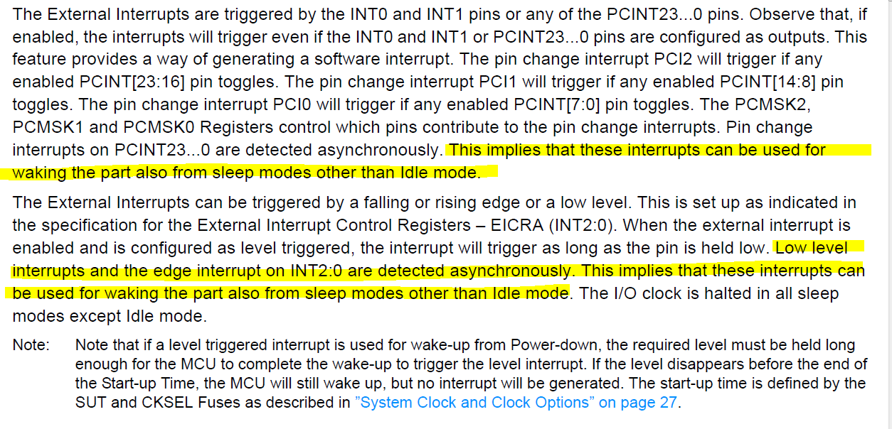

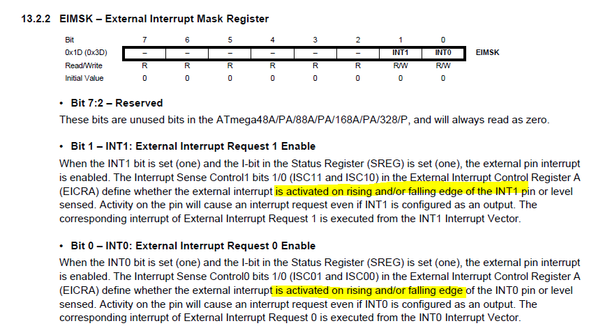

                      @gohan @AWI I understand, so the main issue is that CHANGE does not work. I checked the datasheet and INT0 and INT1 can also do CHANGE so it's a bit weird:
                      0_1493197213711_upload-fce2880a-1075-44e0-a230-4ed6d513d5db
                      Of course you're limited to the INT0/1 pins then.

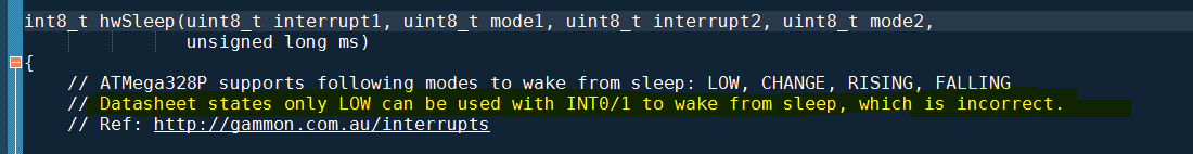

                      But also:
                      0_1493197914736_upload-f3abb58d-503e-4bfc-abd2-611463f2e019
                      So PCINT is just not implemented in MySensors? Code is probably based on an old datahseet:
                      0_1493197957731_upload-0d9666b3-298c-4435-b0a0-8ae72415c10a
                      Because that's just wrong...Looking at hwSleep for AVR it looks like it's just using attachInterrupt with the passed through mode. I'll test later because in fact I'm working on a project with a MPR121 touch controller that wakes up my Pro Mini on FALLING so I change it to CHANGE and see what happens...
                      Anyhow, @kk02067 I'd use INT0/1 pins if you can...also, just measure the current consumption und unplug the nrf to see how much it changes. My mentioned MPR121 project consumes about 0.5-0.9mA in sleep and ~18mA in awake (MPR121+Pro Mini+nrf) just to give you some ballpark numbers. Consumption went to 5mA with nrf unplugged.
