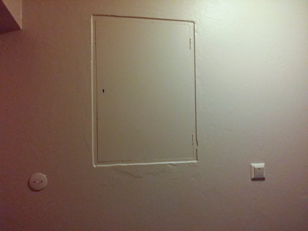

                    • D
                      D
                      dakipro
                      Then I might "steel" thread a bit :)
                      I want to monitor/count pulses from a power meter. But the thing is that we live in the building and the power meter it is in a "common" metal box (one more meter in it). I can place a device inside and write on it that it is a monitor, but the problem is that meter is inside the completely metal box, with only two wholes, both filled with main power cables. So no holes, no option to get the antenna sticking out of the door, no option to plug it in the power even, it has to run on the battery.
                      From my understanding, that box is a dead hole when it comes to external communication. Or? Use the box somehow as an antenna? Telepathy perhaps? :)
                      One "ironman" idea is to clamp around one of the main cables inside the box, to somehow send the signal from "around the cable by injecting microwave signal nano particles" and then from inside the apartment which is 4-5m detect injected signal and send it to the gateway.

                        • D
                          D
                          dakipro
                          wrote on last edited by dakipro
                          What do you mean by powerline adapter?
                          All the main switches/fuses and the meter are in the same stupid metal box. Cables come "magically" into the apartment. Thing is that they belong to the "building", and I can only touch things in the apartment (i cannot install 220v socket inside the box f.eks.). All (almost, except for one) the cables come trough the walls and are not accessible
                          I could make several non-contact (with the clamp) monitors and attach them around huge appliances, but... that is a plan d (and I do not have plan b or c)

                            • D
                              D
                              dakipro
                              yeah that poweline was the one of the ideas (variation on the particle injector from above)..
                              I will ask electrician next time he comes if he can install one powerplug inside the powermeter box.
                              If he can do that, then I could use it to send data trough the cable to the inside of the appartment, and take it from there.
                              I can see daily usage on the power company portal, was hoping to get something more of a real-time-ish

                                • D
                                  D
                                  dakipro
                                  If I understand you @Sushukka correctly, you have a esp that connects on wifi in completely metal enclosure, and it connects to your wifi?
                                  That might give some hope that I can do the same, perhaps with a repeater that can be located ~2m from the box, bein separated by 1-2 walls. I tried directly connecting to the main node, but it didn't work.
                                  I understood that Nrf24l01+ uses same frequency (or does it?) as wifi so it should work as well.
                                  I will take a photo of the electrical box, but it is basically like this one
                                  and it is built into the wall in a hallway, sort of like this (ignore these numbers, I just googled for a photo)
                                  (but I can live with rechargeable batteries[hell yeah I can live without the pulse meter, but "I need one" :) ])

                                    • D
                                      D
                                      dakipro
                                      thanks, I will try it soon when I grab some time/motivation.
                                      Photos above are from google, here is the actual box in the common hallway
                                      And it is common box for two apartments, so no drilling possible, batteries only :)

                                      • Nca78N
                                        Nca78N
                                        You could still try a PA LNA module with ipx antenna and bring antenna outside of the box, metal should be flexible enough to let the cable get out on one side. And no need to activate pa/lna mode so it can live longer on battery.
