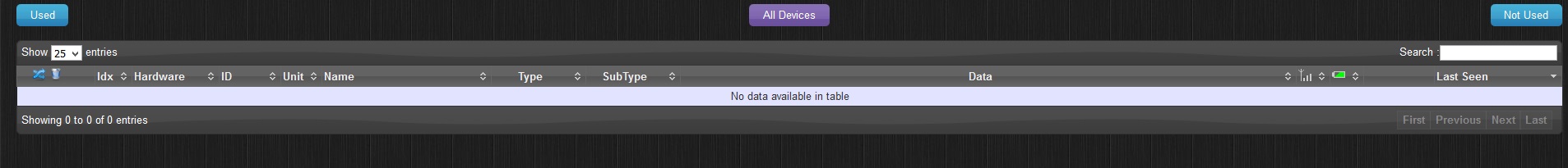

    Hello Everyone.
    I'm rookie Arduino user.
    I've got some problems with my DHT11 + sketch from MySensors website.
    https://www.mysensors.org/build/humidity
    The only change I've made is added line:
    #define MY_GATEWAY_SERIAL - (since I am connected via USB cable)
    Sketch loaded to Arduino UNO
    Arduino connected with Raspberry PI 2 B with Domoticz installed.
    Sketch compiled ok - serial monitor screen below
    Domoticz Hardware seems to be ok - named DHT I can see some data.
    Problem starts when I get to devices - basically it is empty.
    Please help - where is my mistake ?
      try to comment out the MY_DEBUG

        Commenting MY_DEBUG solved the problem.
        Could You explain please what this function does ? should I always comment it/ delete ? or there are some reasons for using that ?
        Thanks in advance.
          My Debug is for debug, it adds extra info into the serial output and those info are not handled by the controller and it starts acting weird
