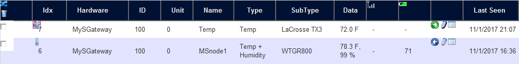

              Device:
              0_1509622126601_upload-542e3994-aeb2-4d17-b8fb-92b9e1c3609b
              Note the "LaCrosse TX3" entry that only reports temp - this is new. I am at a complete loss here.

                If you look around you might find one added device with combined Temp/Hum and two single devices 1) Temp 2)Hum
                This is because Domoticz wants to incorporate two devices (HUM + Temp) into one. If the values are presented in a certain order they are combined into a single node. If the node does not update regular they will be read as two different devices and not updated on the first one.
                This is according to Domoticz not a bug but a feature.
                Have a look if this is the case... (it looks so in the image)
                To avoid this I use two options. Present the temp/hum/(baro) as child ids not close to each other (1-2 and 2-3) or you have to update all values in the same time (ie. you cant use, if value is the same do not send it).
                W 1 Reply Last reply

                  @sundberg84 Not sure I follow but will try and answer each item.
                  I only see these two devices listed. The Temp+Humidity was created before the upgrade to 3.8666 and was last updated at ~4:30pm yesterday (although the Hardware view of the nodes showed updated (and different) values up until my upgrade of Domoticz. The other device is Temp only and was last updated (actually the first time seen) at ~9pm yesterday and not updated since. No other combined devices from MySensors nodes present (there are others from Weather Underground).
                  Again, the node does update regularly (about every 5 minutes if a value has changed). Look at the Hardware view - it shows that both temp/hum were updated at 7:11am this morning but Device view says only temp was updated at 9pm last night or combined temp/hum at 4:30 yesterday.
                  I will look into how to present two different child IDs.
                  The values are updated at different intervals from node. In the code on the node I test if new measurement for temp is different than last measurement - if so I send, if not I don't. Same for humidity. I can alter this to send temp/hum value if either one is different.

                    @wergeld said in Hardware shows node values updated - Device view does not:
                    The Temp+Humidity ... The other device is Temp only and was last updated (actually the first time seen) at ~9pm yesterday and not updated since.
                    This could be your problem. If the node first reports Temp/Hum Domticz will make one node of the two values. If for some reason the node only reports temp (say hum is N/A or some other error) or your node have a reset Domoticz will start updating the single temp instead,

                      @sundberg84 Okay, but why would it not report updated values for Temp then when Hardware view of the node shows updates?

                        @wergeld - that is a good question. Is it the same value being sent in? Did you comfirm with the log from the node?
                        Could it be the hardware view is update everything when one variables gets to the controller? Sorry... many questions, no answers.
                        If you made some update it can be you see a old child in the hardware view but new childs in the device view? Can you see anything under "not used" ?

                          @sundberg84 No, it is a different value. In my image above you see that the Hardware shows 15.6C (which is 60F) and the Device shows 72F. When I view the log for the gateway I see that roughly every 5 minutes (which is what I set in the node as minimum send rate) there are new values - and they match in Hardware view of the node. My view of the Devices is for All devices. The only one under Not Used is that "new" Temp only item.
