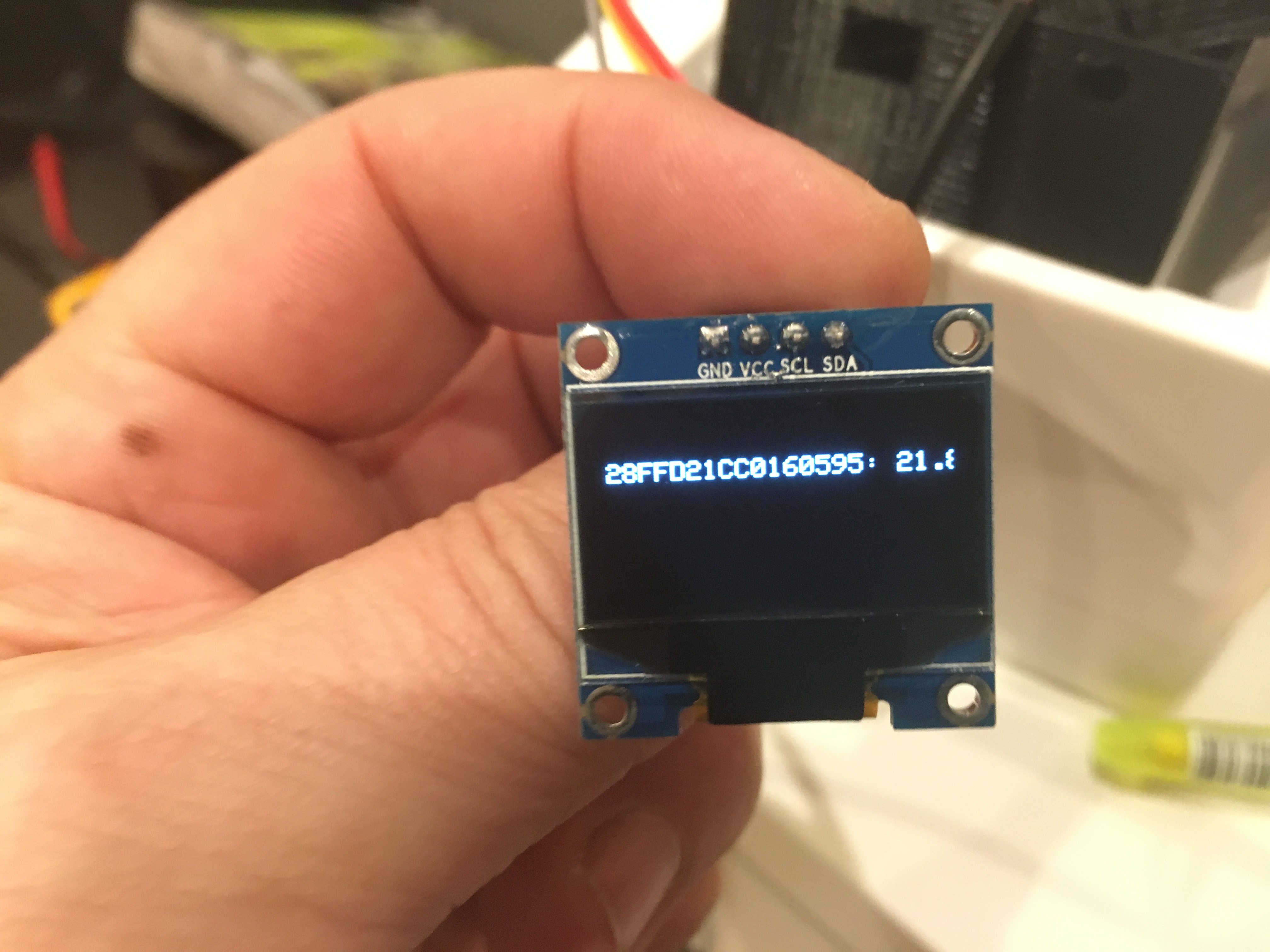

      Hi, I've downloaded the latest version of NodeManager, V1.7. Works really well based on what I've experienced so far. I especially appreciate the option of presenting results from nodes locally via LCD displays. I have tried making a simple node with a temperature DS18B20 and a display SSD1306, and it works well, but I would like to change the presentation of the child to another format/name that I choose myself, 0_1522263759748_IMG_6388.JPG Is this possible? For me, it looks like the child is presented as a MAC address.!

        @getz99 thanks for the feedback! By default each sensor/child prints on the screen its description and for a DS18B20 is its address, this is why you see that strange string :) Of course you can change it in before() with:
        ds18b20.children.get(1)->setDescription("Whatever you like");

          @user2684 Thanks for your explanation, works great now!
