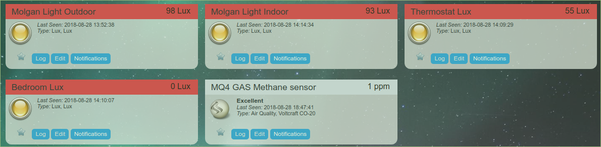

          I've updated my domoticz to this latest stable version. But now all my light sensors (photo-resistor sending V_LIGHT_LEVEL numbers) are not working.
          I can see all of them sending the number in the Setup tab. But on my devices the reported light is nomore updated and only the last value (acquired before the update of Domoticz) is displayed, as in the image below.
          Do you know any reason?
          Thanks in advance!

            Hi
            I upgraded as well, and did not have any problems. So this is a wild guess....:
            It seems that you use a using a different skin than standard. I remember that I have read somewhere that sometimes different skins can cause strange problems.
            What if you revert back to the original skin and reboot - what happens then?
            /F

              @lemme I've tried to change back the user interface but without success...
              Which version of MySensors do you use? the latest one (2.3)?
              Thanks!
