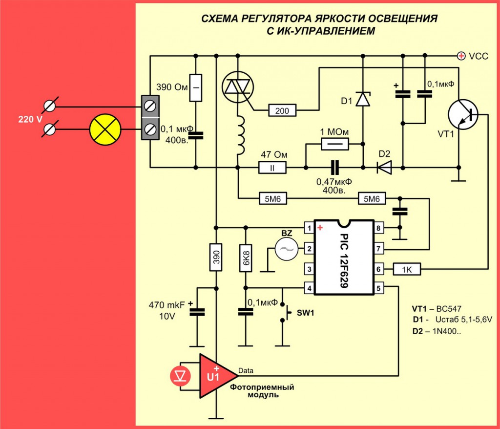

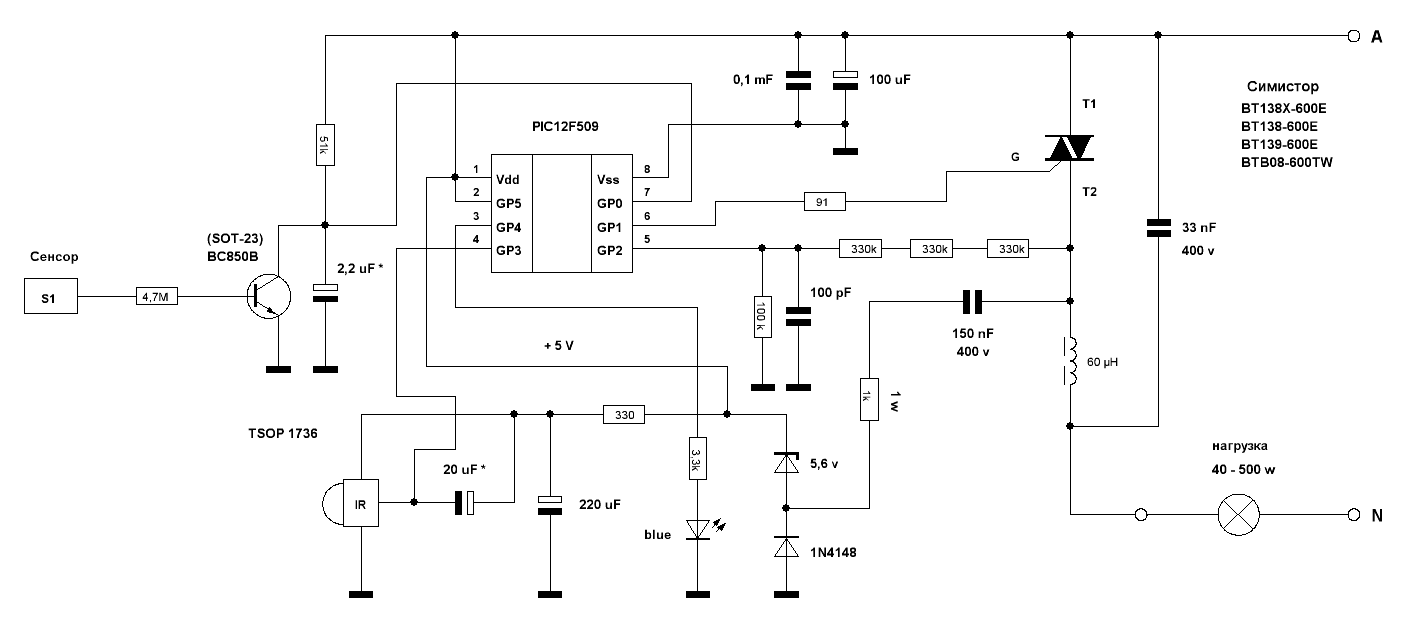

                  • axillentA
                    axillentA
                    axillent
                    a few examples without transformer
                    sense and drive
                    jeremushkaJ 1 Reply Last reply

                                @axillent Thanks. The dfirst diagram is interesting. I do not understand the idea of having a buzzer here (grey part). But the violet schematic is good. Seems it used a divider to compare the value of the voltage in order to determine when we can disconnect the load on positive wave.
