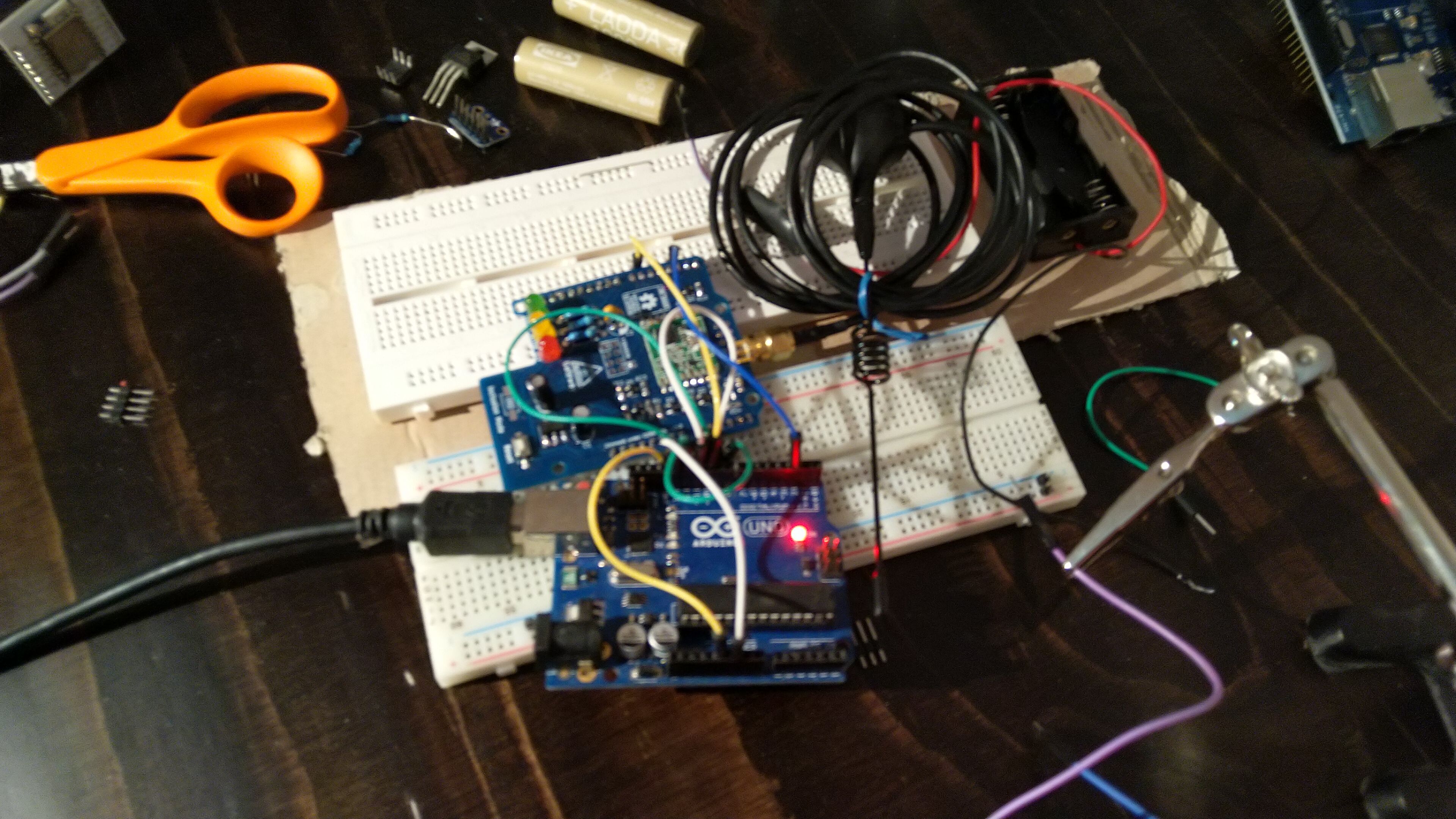

    One thing to do (quickfix) if you want to use it as a serial gateway is to cut the pinheaders for all SPI channels. Then hardswire the SPI channels to the normal pins 10-13 instead of softSPI which is currently using. You ofcourse needs to solder them from the pinheader and not RFM module itself since you need to logic level conversion. I will give this a new go as soon as I have time. I really really want a RFM gateway over ethernet.
  • @sundberg84 Yes I can confirm I see 3.3v on the RFM.
    I'd thought about cutting the pin headers+ hard wire for hardware SPI but wanted it to work with the dupont cables first. I've tried a Mega and now an Uno but still it doesn't work. I guess either something is soldered wrong, the radio is broken or something else. Checked it all many many times so perhaps time to replace the radio.
  • Oops fixed it by remelting all the solder joints on the mini regulators. So will cut the pin headers and hard wire for a serial gateway (which I'm starting to think is a good idea anyway to keep down system latency of going via ethernet).

    • Continuity on all logic level converters are OK
    • Not much traffic at all from the UNO in SPI. I guess the intial contact with the radio is faulty so thats why.
    It must be either connection Uno > Logic Level Shifter > Radio, code / defines or softwareSPI not working.
  • Hardware Contributor
    I have now tested all SPI lines and its logic level converter individually.
    To be absolutely sure the hardware worked, I desoldered the radio and wrote a arduino program sending 5v in 5 sek over the same sofwareSPI lines and 0V over 5 sek - all behaved correctly, 3.3v and 0V.
    I also swapped radio, but same same...
    Not really sure how to proceed. I need to get the softwareSPI working or else I cant use it as a ethernet gateway.
    Is there someone here that got RFM gateway working with softwareSPI?
    I dont think its the hardware anymore...

    What im noticing is that when I connect the radio, the IRQ line on D2 is 1.0v when high and not 3.3v. Anyone who knows this is normal behaviour? Same with two different (and comfirmed working) radios. SPI logic level converter is comfirmed working and changed with same behavoir.
    Edit > This is the same using normal pins and does not have anything to do with SPI. It works when not using softSPI and IRQ has this low voltage...

    I have soldered between the two 3.3v rails , i confirm now i have 3.3v on the RFM module
    I will test with the softwareSPIs and report.
    I will give a try to your "quickfix" for hardwire : could you please explain or post a photo of what needs to be done for the hardwiring ?
    Thank you!
    @hlehoux My quickfix means you cant use the ethernet shield.
    All I did was solder with wires to the normal pins and made it a serial gateway.
  • @sundberg84 thank you.
    i have ordered the components such as BSS138 so i will test when they arrive.I don't need ethernet
  • Hello, i'm making some progress; received the components this week.
    Unfortunately it doesn't work... yet
    For now i have SanityCheck failure in to logs.
    I'm afraid my soldering of all these little components is not good. I tested with a multimeter the 4 pins and i have continuity on one of them but maybe not the others so i guess i will have to try remelting all these small regulators ???
26 out of 28
