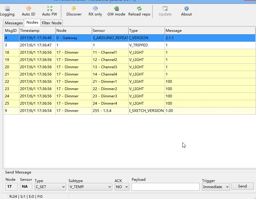

                                      @HouseIOT As a newbie, I did a board completely following you schematics. But unfortunately,not working...
                                      I use the MYsensores-bootloader(8Mhz,V1.5.4!), and I flashed your source ino-code into the board.
                                      I can see the dimmer in the MYSController(as picture show), but there's no output from the X1.
                                      My gateway is a esp8266 wifi gateway, version is 2.1.1 and it works fine.
                                      PS: After testing job, the circuits of low voltage seems work well, shortcuts x5 and x2, the indicator led show lightness change(OFF, 30 & 100). The problem maybe in the Hi-voltage parts.
                                      PLS help, THANKS a lot !
                                      HouseIOTH 1 Reply Last reply
                                      • hhaliboH hhalibo
                                        HouseIOTH
                                        HouseIOTH
                                        HouseIOT
                                        @hhalibo
                                        Check for neutral and phase connected right. I can see only one wire of load connected to X1. Other one must be connected to neutral if on X4.1 is phase. Otherwise try to reduce down to zero R5,7,9,11. May be not open the optocouplers.
                                        hhaliboH 1 Reply Last reply
