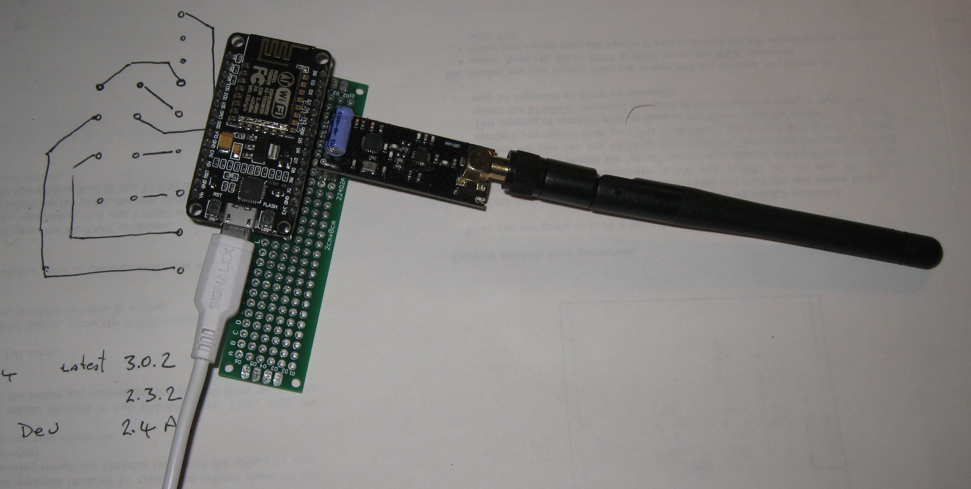

ESP8266Wifi Gateway won't connect
  • I'm trying to add a 2.4 GHz gateway using an 8266 nodemcu and nrf24l01 module. I wired the system according to the "Connecting the Radio" section for ESP8266 devices. I've double checked the wiring.
    The system programs and runs as expected with no errors. Nothing is sent to the serial port except the initial bootloader stuff. No connection info, no nada. My SSID and password are correct. I have the My_Debug def uncommented. The system is not connecting to the network...and I'm not sure why. The 8266 is known good. I'm using the app directly from the MySensors Examples with my network credentials added. Wired up a WEMOS mini and another radio exactly the same way with the same results. I've even tried another radio on the setup...same

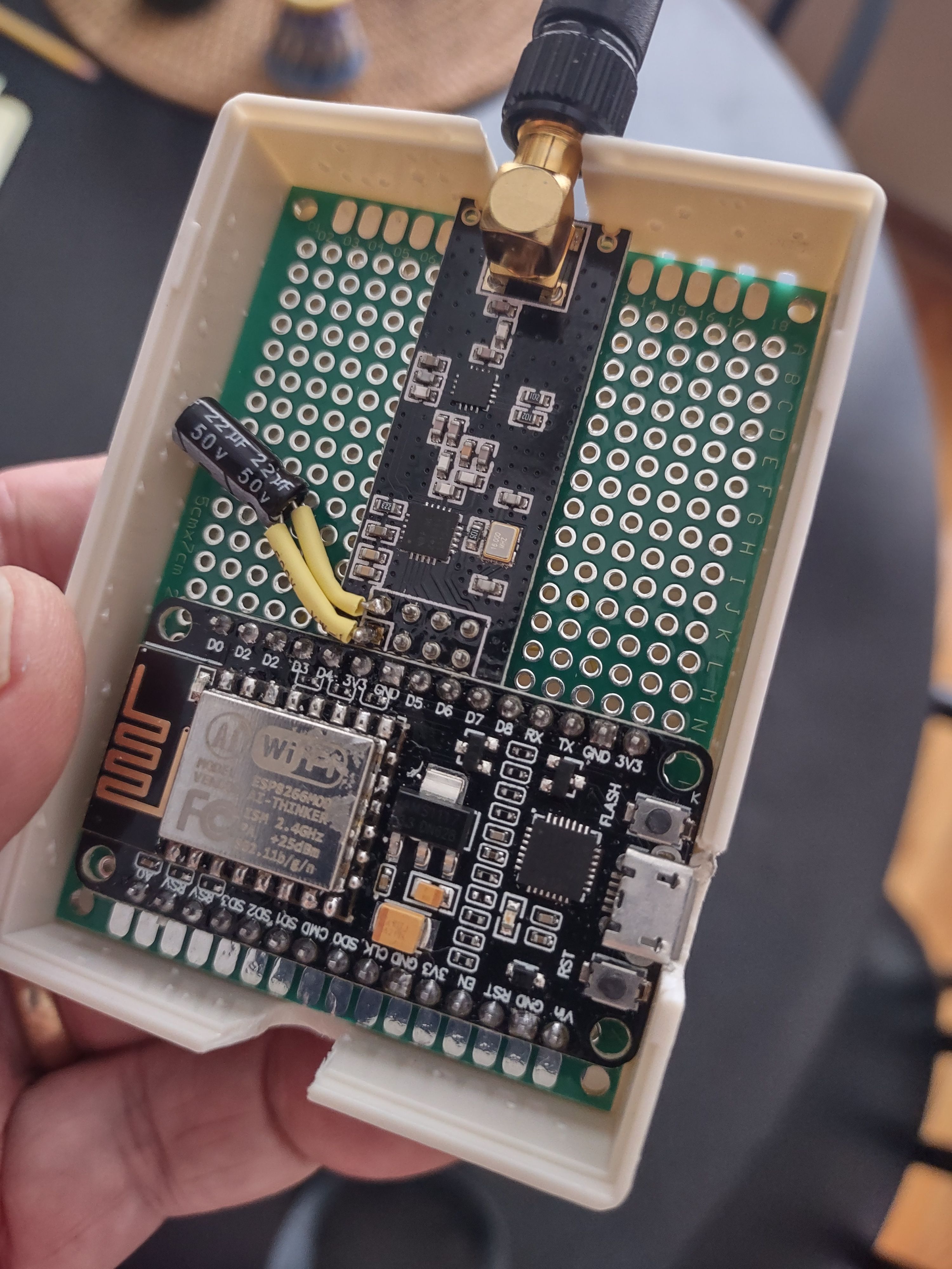

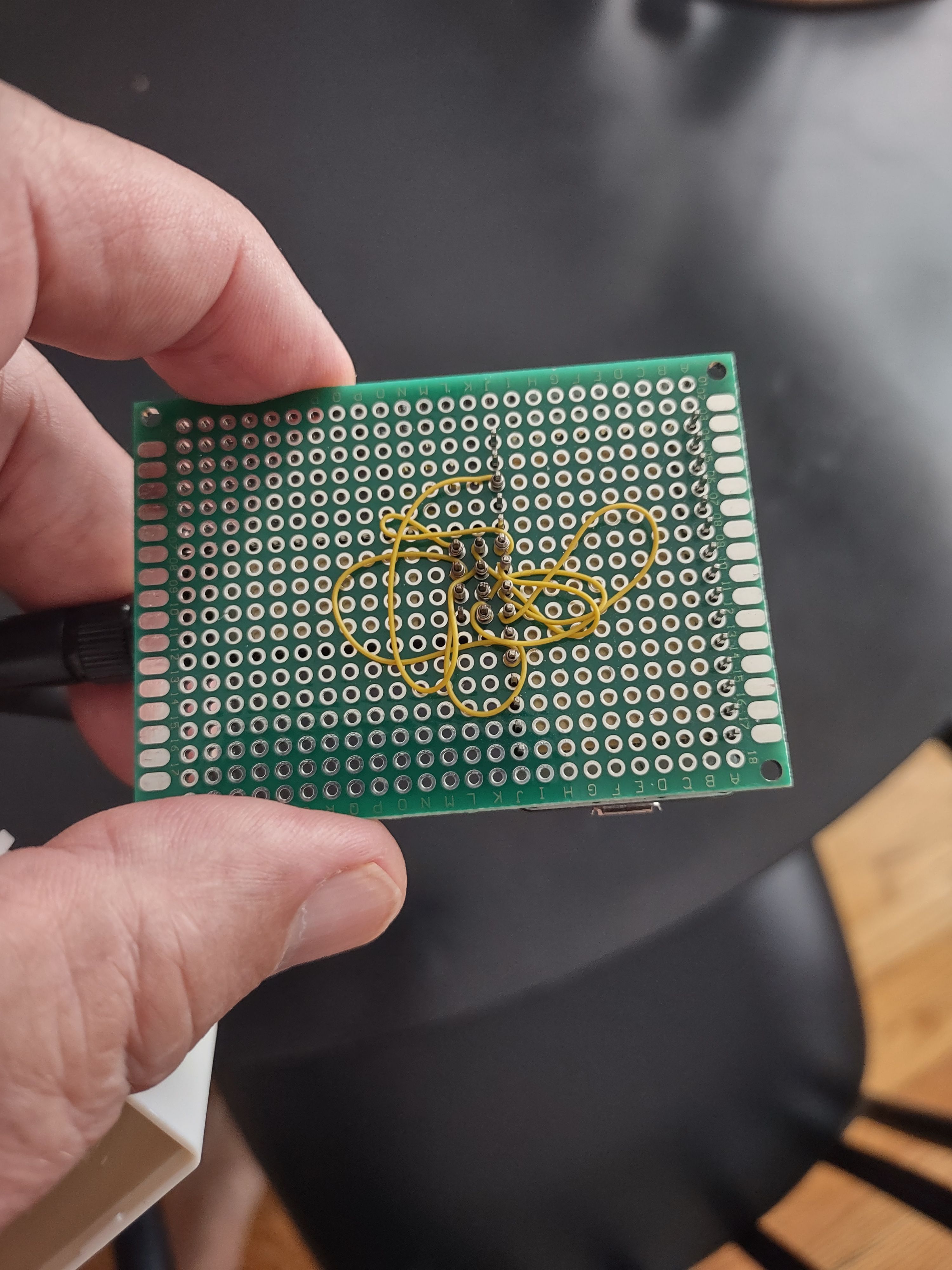

    @dpcons could you post photos of your setup? Having some more eyes on the wiring can help sometimes.
    When you test the webserver, do you use the exact same wiring?
  • IMG_20220819_114756303_HDR.jpg IMG_20220819_114858392_HDR.jpg IMG_20220819_114802950_HDR.jpg
    I tested the Advanced Web Server Sample with this setup. Works fine. I tried the GatewayESP8266 on this setup and another setup with a WEMOS Pro mini. Same results, nothing out the serial port. I also tried the gateway app on an esp8266 with no radio attached and got no serial at 115200 at all. Is this normal? Shouldn't I get some kind of error message.

  • @dpcons I assembled a board copied from yours for testing.
    I could replicate the problem. It is with the ESP core version and the MySensor Version
    MySensors version 2.3.2 and ESP8266 core 3.0.2 does not work,
    MySensors version 2.3.2 and ESP8266 core 2.7.4 works
    Mysensors development version 2.4.0-Alpha and newest ESP8266 core 3.0.2 also works
    So you can either update the esp core to older version 2.7.4, or install the development version of MySensors 2.4.0-Alpha
