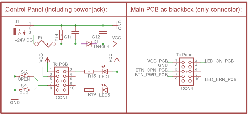

    For the mysensorization of my air humidifier, I'm trying to interface the arduino with the 24V circuit of the humidifier.
    I have some rought schematics in mind, but as I have practically no experience designing electronic cirvuits, I have no idea whether there are better solutions. So I desperately need some input from someone with more knowledge in circuit design. I would be very thankful if you could give me some feedback on my schematics as detailled below.
    Basically, the questions are how to best convert 24V to 5V/3.3V to power the arduino, whether a MOSFET is the best way to emulate a button press and whether voltage dividers are the correct approach to detect a button press and a burning LED.

    How to tap into the electronics of the humidifier
    The PCB of the humidifier is mainly covered by a large motor, so tapping directly into the microcontroller is not an option (which is also covered by the motor; I can only see the last few characters: 1933, so it is probably a PIC16F1933). However, the control panel (with control buttons, LEDs and also the 24V power jack) is connected through a 10-pin ribbon cable, where I can easily place my own pcb. The ribbon cable provides +24V, GND, and the control buttons connect directly to GND, while the leds connect to +24V. Here's the schematic of the humidifier's existing control panel and the existing connector, where I want to interface:
    What I am interested in:
    • Emulating the Power button from MySensors
    • Detecting the Open button (case open warning!) from MySensors
    • Detecting which LED is on (to determine state and/or error)
    • (Potentially, turn on the error LED from MySensors node, but that's for future use)
    All lines of the cable run a voltage of up to 24V (some have ~19-20V measured with a multimeter), so I can't directly feed them into the Arduino.
    So, my issues now are:
    • Powering the arduino from the 24V, 0.5A power supply (pins 1+3 of the connector)
    • Triggering a button press on pin 7 (simply connect pin 7 to GND, but need to take care of 24V level!)
    • Detecting a button press on pin 5 (detect pin 5 going to GND, again with a voltage of 24V)
    • Detecting which LEDs are on (as the LEDs are connected to +24V, I suppose this also means detecting pins 2 and/or 10 going from HIGH to GND)
    If I measure the voltage at the lines using the arduino, how can I make sure not to influence the existing circuit of the humidifier?

      I'd use optocouplers mainly to stay on the safe side, hoping you can find them with the right specs, for both simulating button press and detect buttons and leds. If the linear voltage regulator doesn't get too hot to lower 24v to 3.3, I'd use that to keep size small. I hope others will give better suggestions than mines 😀
      • nagelcN
        nagelcN
        nagelc
        You might consider one of these:
        https://lowpowerlab.com/shop/product/133
        5V/1.5A Buck Regulator
        Murata OKI-78SR-5/1.5-W36-C
        instead of the L78M05. Felix at LowPowerLab has a discussion of testing he did on them for his doorbell design. Looks to be more efficient than the L78M05 in the same footprint.
