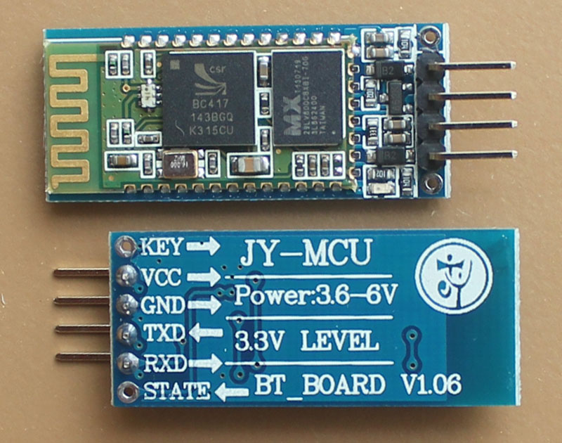

            If i can say.. :) only a "little" detail which caught my eyes : the bluetooth module orientation and its clearance are not ideal, especially copper under the antenna. that will reduce range I think..but maybe it works enough like that for your usecase.
            Keep the good work

              @scalz thanks for the feedback! Exactly like this I want before 1.0! BT range has not been tested except that it works fine standing next to the node with my phone. I will look some inte that. 👍

                • I agree with @scalz about the Bluetooth module. You should turn it 180° to have antenna on the side of the PCB, either antenna outside of the PCB area, or with no copper below and on the sides as far as possible, as visible on the bottom of the module below. Limit of your ground plane should be aligned with the limit of the ground plane on your Bluetooth module.

                  About the Bluetooth - I will change this!

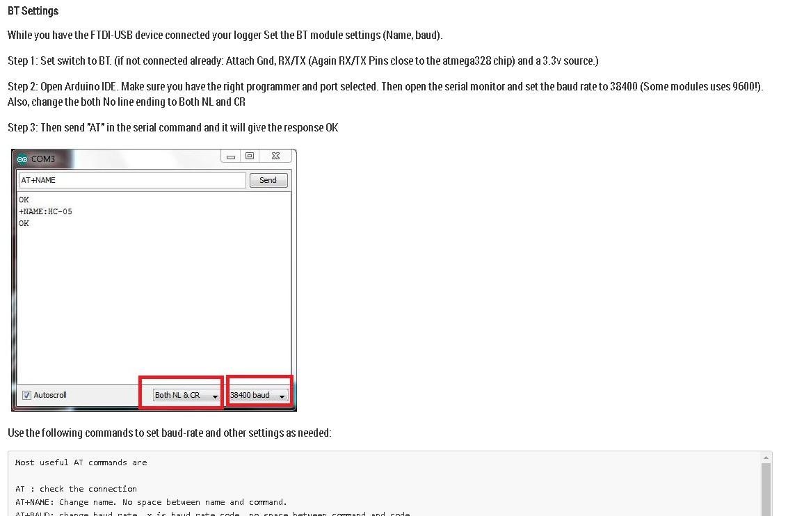

                                      sundberg84S
                                      sundberg84S
                                      @terxw - sure! How do you connect when you wants to set up baud rate. (Picture?)
                                      The module i send have 115200 set as for BT. If you have a node with that baud-rate - does it work? Or what does your node have at the moment for baudrate?
                                      This is from https://www.openhardware.io/view/532/The-Logger-Machine-Short-and-long-term-serial-logging where i documented the instructions:
                                      0_1544121098492_5b3fc634-29ac-41f0-b654-5a54531119e9-image.png op

                                          sundberg84S
                                          sundberg84S
                                          @terxw - ok.
                                          4800 should work just fine.
                                          The command should be AT+BAUD3
                                          I used this link when i designed and wrote this - it has some more in-depth analysis.
                                          https://www.instructables.com/id/AT-command-mode-of-HC-05-Bluetooth-module/
                                          What good to know is that if you are the one who bought the module from me just recently from ebay this is tested and verified working by me so we should get this sorted!!
                                          Can you post a picture on how it looks (connections) when you try to change baud-rate?
