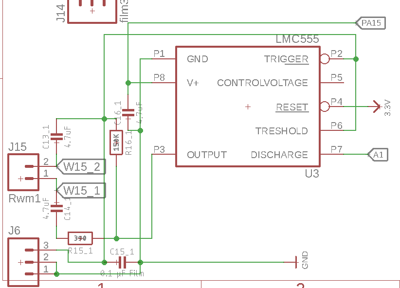

                  I use freqency measures because the voltage output need to have an input pf 4.5V. My circuit worj with 3.3V even ifI believe it would work.
                  I created that schema
                  alt text.
                  Watermark is connected to W15_2 and _1
                  On PA15, I power the watermark with DIO pin of my microcontroller, and then I take the frequency measure on A5 (work as digitalRead). In that way, I controll the power and power the watermark only when I need.

                    Seeing your curcuit it makes sense now, I saw this schematic in the data sheet but did not really look at the details and skipped over the page.
                    I see you do not have the shunt resistor in the ground supply connection on your schematic so are unable to measure the mV signal. So only the pulse signal is available.
                    Q1. Do you have a pullup resistor on the pulse signal A1 or have internal pullups on the microcontroller enabled?
                    Q2. Is there a reason that you switch the V+ into LMC555 but do not switch the Reset (P4) as well from PA15?
                    Q3 Your code "" percent = duration*100/11000; ""
                    That does not seem to make sense to me, as when i chart the numbers, it seems to me the most useful range according to the KPa numbers will not be very sensitive with your figures ranging from an intger of 9 down to 0.
                    Also why multiply by a hundred only to divide again, simplify to
                    percent = duration/110;
                    A Why measure once with LOW and with HIGH
                    This was to get the correct frequency, As i did not know the mark-space ratio of the pulses was 50%, ie high and low the same duration.
                    As frequency in Hz is the number of cycles in one second. If we take the time for the High Pulse and the Low pulse and use that to divide one second we get Hz.
                    If they were not the same then the frequency calculation would be incorrect just taking one reading.
                    If 1:1 mark space ratio then measuring High or Low and mulitlying by two will give the freqency
                    ie 50Hz, one cycle takes 20ms, measure high or low at 10ms, 2*10ms = 20ms
                    frequency = 1/20ms

                      if mark space ratio is 2:1 then need to measure both high and low
                      ie 50hz high = 15ms, low = 5ms
                      using only high readings 2x15ms = calculated value of 1/30ms = 33Hz
                      using only low readings 2x5ms = calculated value of 1/10ms = 10Hz
                      using both low & high 15ms + 5ms = calculated value of 1/20ms = 50Hz
                      i would send the frequency value to the controller if possible as then you have raw data to process with no lose of resolution. Unless your controller can only handle 0-100 percent data.
                      for example using info from data sheet.
                      16384 Ohms approx 476Hz = 100 Kpa your calculation = 9
                      12288 Ohms approx 612Hz = 75 Kps your calculation = 7
                      8192 Ohms approx 874Hz = 55 Kpa your calculation = 5
                      6144 ohms approx 1135Hz= 35 kpa your calculation = 4
                      As i do not have a sensor to test it does seem that you may only be getting a good reading of dry to very dry with your scheme. Still that is only a guess as i really have no idea what 100Kpa really means to a plant.

                        What is the purpose of the J6 connector, as i should think that connecting any cable or meter will effect the capacitance and change the output frequency.
                          I build the circuit myself and I was not sure about the Film capacitor C15_1. I juts add J6 in case I make a mistake about C15_1. In that case, I can add a different capacitor on J6. But it should remind open and remove it later unless C15_1 (SMD) does not match. I have a doubt about C15_1, but not about the no-SMD capacitor that I can place on J6 holes. ;)
                          About Q3, yes of course
                          About Q2. Yes I thought to connect to PA15 instead of 3.3V. I though there is no impact if I keep RESET permanentely to 3.3, but I can have it to PA15, when the DIO of my processor is HIGH to power the SMX circuit.
                          About Q1: I didnot foresee a pull up resistor on A1 and Ido not know if my microcontroller has one (Adafruit Feather MO adalogger), but I will check it tomorrow.

                            It is mentioned in the SMX instructions and on the ti data sheet it clearly mentions the discharge pin being open collector. I like to use external pullups normally as it gives more control.
                            check if you have the internal pullup set.
                            The Adafruit Feather MO adalogger looks like a useful board with on-board charger ect
                            pinMode(pinRead INPUT_PULLUP)

                              I am sorry but I was busy with another problem that now I fixed.
                              First of all. The Analog (A1) has a pull-up resistance.
                              Secondely, you asked me why I do not use the kPa unit instead of percent.
