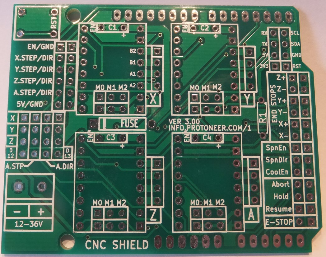

    Reporting back: I received the el cheapo GRBL boards (above). The good news is that they don't have a buck converter getting in the way, the way the woodpecker does. The bad news is that the caps are rated at only 40v. So, I may replae them with ones rated for higher voltage. Also, there's a mysterious glass fuse soldered in the midst of it all. Not sure at what current it's rated to blow but, meh, probably high enough if the designer did his homework.
    So, overall, I expect this will be an improvement over woodpecker for running GRBL at higher voltage. πŸ™‚

    @NeverDie judging from the images, this looks like a diode instead of a fuse.

    @Yveaux said in CNC PCB milling:
    Not a bad guess based on the image you were working from, but if so it's a diode with the word "FUSE" written under it:
    πŸ˜‰

    @NeverDie said in CNC PCB milling:
    Got me there, but it seems to be a fuse with orientation πŸ€”
    We'll never know unless you put a multimeter on it πŸ˜‰
    OK, I just now probed it, and it conducts with the same 0.12 ohm resistance in both directions. So, it's not a diode. Here's a closeup photo that I took for you:
    I'm going to deem it a fuse unless you have a different theory or can recognize it as something else.

  • @NeverDie Did you check out the assembly instructions? There they use a fuse with a rather high current in this place 🀣 🀣 🀣
    The explanation why it is polarized is because in fact, it used to be a diode in older revisions, check out Step 7 here.

    @eiten said in CNC PCB milling:
    Yeah, let's look at that:
    D1(Diode) was intended to prevent users from damaging the board by accidentally reversing the polarity on the high voltage line. Unfortunately this feature was abandoned because I could not find a big enough Diode that would handle 6 amps at a time and still fit on the board. The work around for this is to solder in a jumper wire (Yellow Wire).
    LOL. This excuse just doesn't ring true. I mean, by version 3 he still couldn't manage to find space on the board for a suitable diode? Nevermind that he could have used an alternative for reverse polarity protection, like a mosfet, which also wouldn't have incurred as large a voltage drop.

    I never imagined that I would burn out four (4) DRV8825 stepper drivers and two (2) arduinos in just a short stretch of time. Something about this GRBL design makes it ridiculously fragile. And, by the way, the fuse never blew! 😜 It really might as well be a piece of wire for all the good it's doing. I'm just glad it didn't fry the computer I have connected to it.
    Edit: Good heavens! Here's a similar board, and beware! It's absolutely riddled with fatal flaws:
    Worst CNC shield 12v /24 volt board GRBL v4 Arduino Nano (Problems, fix, Mods, flaws, corrections) – 10:16
    β€” MangoJelly Solutions for FreeCAD
