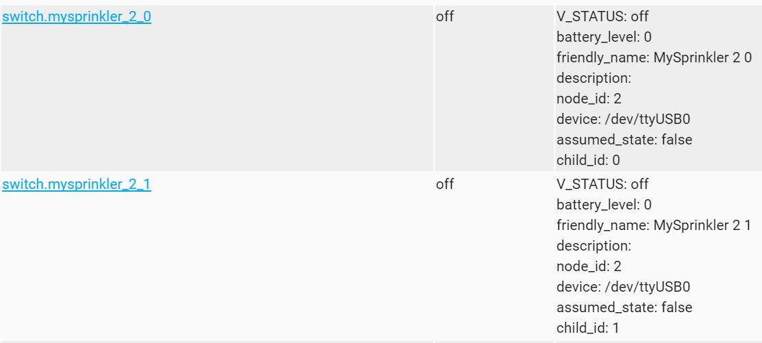

    but i have another issue. now that everything is working so far, and i see the switch automatically added in my home assistant dashboard, i can use them and click them. this is seen by the sensor and it acts appropriately.
    but how the irrigation controller is meant to be used is: it ASKS the hub for data. this data is a) time (works!) and b) duration to activate each zone on button press.
    so it has 4 irrigation zones, each of them ca be assigned 2 values, one is how long it's turned on when activated alone, and one how long it's turned on when you run all zones, one after the other.
    but i don't know how to set those values in home assistant so i can send them back to the sensor.
    this is what the sensor looks like in home assistant:

  • i investigated further and now i know that the sensor is requesting VAR_1 to VAR_3 and afaik this is not working with home assistant.
    any ideas how to circumvent this? i need to set the value in HA and then the sensor is requesting it. how would this be accomplished in HA?
  • Plugin Developer
    @johannes-schoeller
    Currently you can hack it by adding those value types and values to the JSON persistence file, keeping the structure. It's not a real solution, but should work. They will get represented as sensor entities in home assistant. If you want to avoid entity_id clashes the V_VAR1 and V_VAR3 should be placed on different children.
    I have on the roadmap to add an option for inital values in the mysensors home assistant config section.

  • Hi,
    You can fix variable with sending data. In the firmware, you must add this function for place value in this V_VARx
    So, place this function into your setup firmware.
    Where in this case
    MyMessage var1valve(CHILD_ID_SPRINKLER, V_VAR1);
    MyMessage var2valve(CHILD_ID_SPRINKLER, V_VAR2);
    This loop repeat for each relay (i) and you can set any value at the end (1) for one minutes and (5) for five minutes.
    That's all.
    void goInitiateValveTime() {
      for (byte i = 0; i <= NUMBER_OF_VALVES; i++)
        send(var1valve.setSensor(i).set(1));
        wait(50);
        send(var2valve.setSensor(i).set(5));
      wait(50);
      lastValve = -1;
    Refresh Home Assistant just after run one time your script and value appear in your persistence file.
