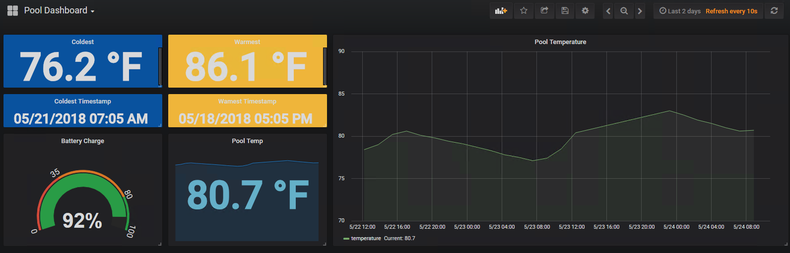

    Here I am again. I swear this forum is beginning to feel like home lol
    So I made a little battery powered temp sensor for my pool. Works great (see graph) hehe
    so here is what I have run in to. The node is battery powered. It goes to sleep for 90 minutes at a time, wakes up, checks temp/battery sends changes and goes back to sleep.
    So yesterday, first time in like 2 weeks the node reported just before noon and then it didn't respond at all the rest of the day. I got home last last night. Reset it and it was good.
    So is there a correct way to do watchdog on a battery node? Any suggestions?
    Thanks!

      sindrome73
      Excuse me but I go a little OT ..... What dashboard and this are you using?
      • CrankyCoderC
        CrankyCoderC
        CrankyCoder
        Grafana :)

          I'm not sure the max time for the built in WDT but I know it is limited. In addition it adds to the battery drain. You might look at a TPL5010.

            any other thoughts on maybe something i can do in code or anything?

              that TPL5010 looks like it could do a 2 hour watch dog. Not bad. gonna look in to that some more too.

                @crankycoder I am not using watchdog in the battery powered nodes. I have had an odd problem like you. I think it has to do with the quality of parts since I am ordering most from Aliexpress.

                              that's where the problem is. the whole sensor is a pro mini. it periodically stops doing it's thing.

                                What I meant was that keep the sensor as is (whether it is a pro mini or anything else), and use a different pro mini as the watchdog - in place of the TPL5010. In this case, it would take a double board failure in order to have a complete failure.
                                • CrankyCoderC
                                  CrankyCoderC
                                  CrankyCoder
                                  hmmm possible. power consumption would be a concern. having a second node running granted it wouldn't have a radio. I could potentially do the same thing with an attiny85 as it's smaller and lower power. It gets the cost down a little too... about to the same price as as the TPL5010. lol. in a pinch a pro mini would definitely work. Since I have some attiny85s that may be my option right now since i have them and don't have to buy the TPL5010's.
                                  I think Jon Oxer did something with a hardware external watchdog like that. I am now wondering if i could use the attiny85, have it sleep as well. Wakeup hourly to see if it should reset the sensor. But also wake up on interrupt, where in the sensor if it's running well would pulse to the attiny. The tiny would reset the counter. Then each hour if the tiny wakes up, and the sensor hasn't reported in a couple hours, it would just reset it.
                                  This is an actual possibility. lol

                                    IMHO, a watchdog reset is something that shouldn't occur normally. If it does, something is wrong in your code and that should be fixed...
                                    Or are there maybe packets that get lost?
                                    • CrankyCoderC
                                      CrankyCoderC
                                      CrankyCoder
                                      i fully agree. But my sensor bombs out after a week or so of running. It's just a temp sensor used from the examples. Only thing I did was change the sleep timeout. So i am thinking either there is something with the cheap pro mini clones. Or something with the radio not sending. Which could be it, for all I know it's waking up and the arduino is saying everything is good but the radio isn't working. The only thing I know for certain is a reset brings it all back online.
                                      Quite possible the packets are lost in the RF transmission. Just difficult to leave a serial monitor hooked up to it outside for a week till it dies lol.

                                        Yes I understand. It is hard to find the cause in these cases. Do you have the possibility to move the node closer to the gateway or add a repeater to see if the problem persists?
                                        Edit: or hookup the serial monitor, but place the node inside somewhere :-)
                                        • CrankyCoderC
                                          CrankyCoderC
                                          CrankyCoder
                                          I have definitely thought of throwing a repeater in the room closest to where it is outside. That could definitely help. Can't move it closer since it's a temp sensor in my pool lol.
                                          Wonder if i made a connector out of rj45 if it would work over that length to something inside :)
