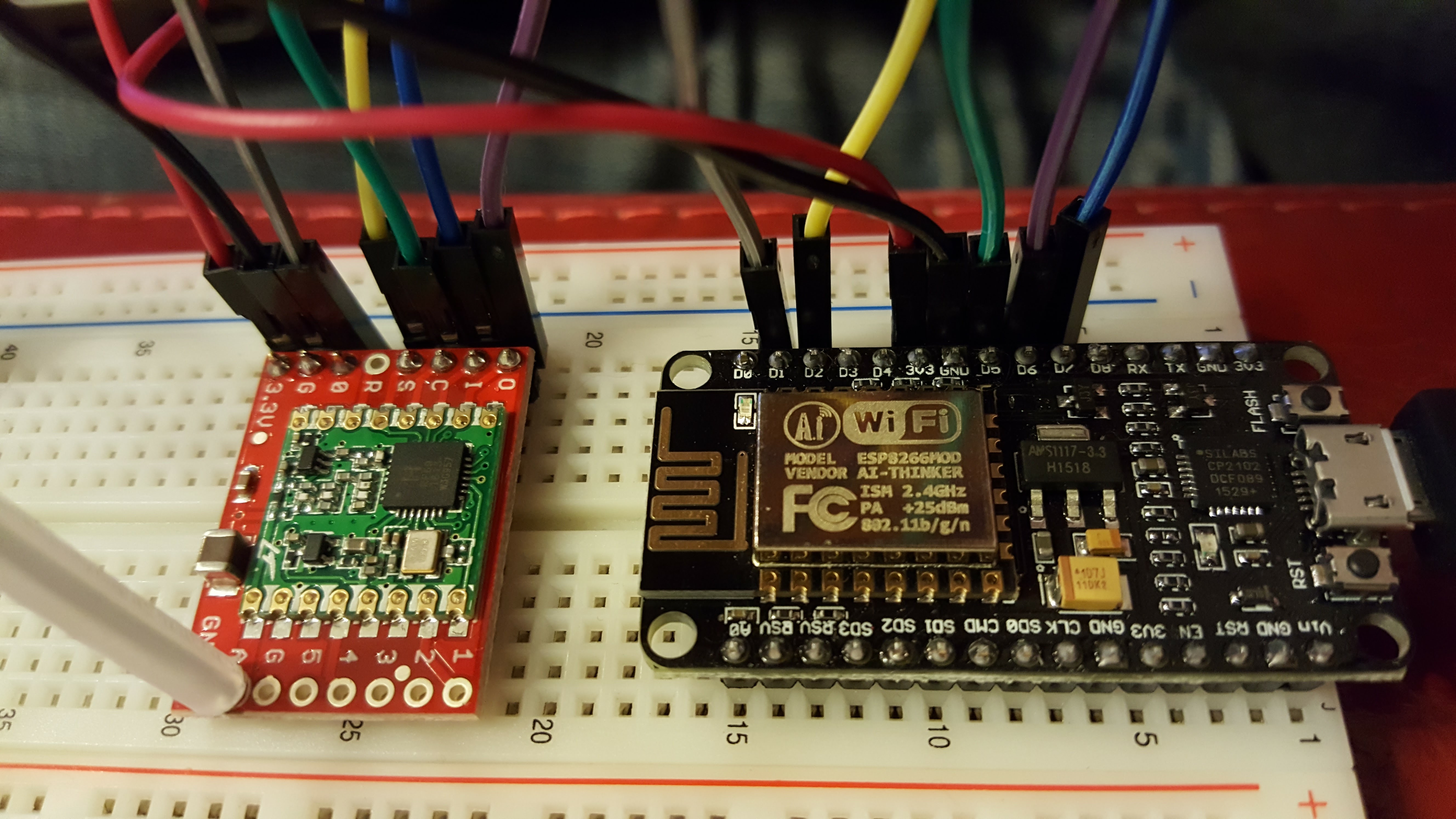

    @gohan said in MQTT message does not show (MySensors on ESP8266): Have you considered using easy esp or other similar firmware? Esay esp won't work for me since it depends on the Arduino IDE but I am using platform.io. Any incentives to change? @Yveaux said in MQTT message does not show (MySensors on ESP8266): @pansen said in MQTT message does not show (MySensors on ESP8266): mosquitto_sub -h localhost -t Sonoff-Out Try subscribing to all topics starting with the Sonoff-Out prefix, using a wildcard, and see if that makes a difference: mosquitto_sub -h localhost -t Sonoff-Out/# That was it, thanks! 0 1 0 1 0 1 2.1.1 Sonoff PIR Switch 1.1 0 edit: and some verbose output for completeness: x@x:~$ mosquitto_sub -h localhost -v -t Sonoff-Out/# Sonoff-Out/0/73/1/0/2 1 Sonoff-Out/0/73/1/0/2 0
