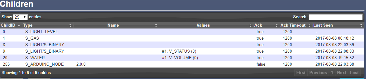

        Debug looks perfect..., but cannot see the node in Domoticz i Devices tab :(
        I can see the node under Hardware -> MySensorsGateway only:

          @1kohm great work.
          For some reason, Domoticz does not show the sensor in the devices list until the sensor has sent its first value. (presentation is not enough, a message needs to be sent). Could that be the case for you?

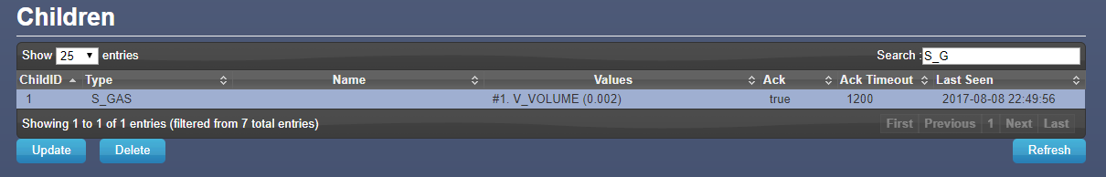

            so my node is sending data every 3 seconds
            TSP:MSG:SEND 7-7-0-0 s=1,c=1,t=24,pt=5,l=4,sg=0,ft=0,st=ok:2
            volume:0.002
            TSP:MSG:SEND 7-7-0-0 s=1,c=1,t=35,pt=7,l=5,sg=0,ft=0,st=ok:0.002
            Domoticz see the updated vaule, but not in Devices :(

              • 1kohm1
                1kohm1
                1kohm
                topic to close.
                I've neede to allow new hardware to add in Domoticz.
