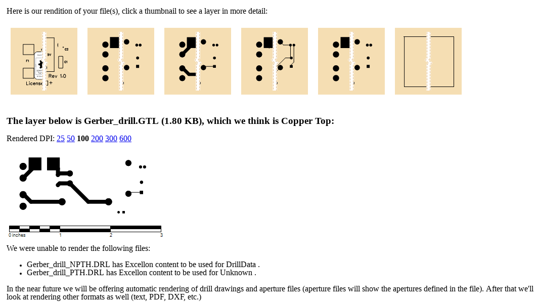

    I am wondering if other people here have used EasyEDA and if you have had any problems with the gerbers generated from there. I am trying to post one of my boards on openhardware.io and it doesn't like the gerbers. I have been working a bit with @hek on this and he suggested posting the question in here.
    It's looking like the files that may be the problem are the 2 .drl files. I tested the files on https://circuitpeople.com/, and this is what it came up with:
    Will things work without those two files?

      @dbemowsk We figured out the issue. It had to do with an added space in some of the files.
