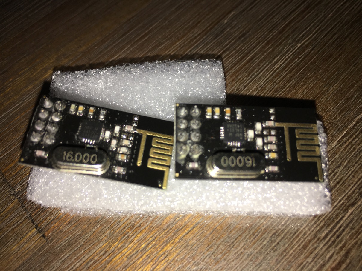

  • Radio troubles. (NRF24L01+)
    Trying to figure out what is wrong can be a fun challenge, and a great learning experience. I have found it mainly tedious and frustrating though, so I've decided to just throw away troublesome parts (as long as they cost less than a few dollars). :)
