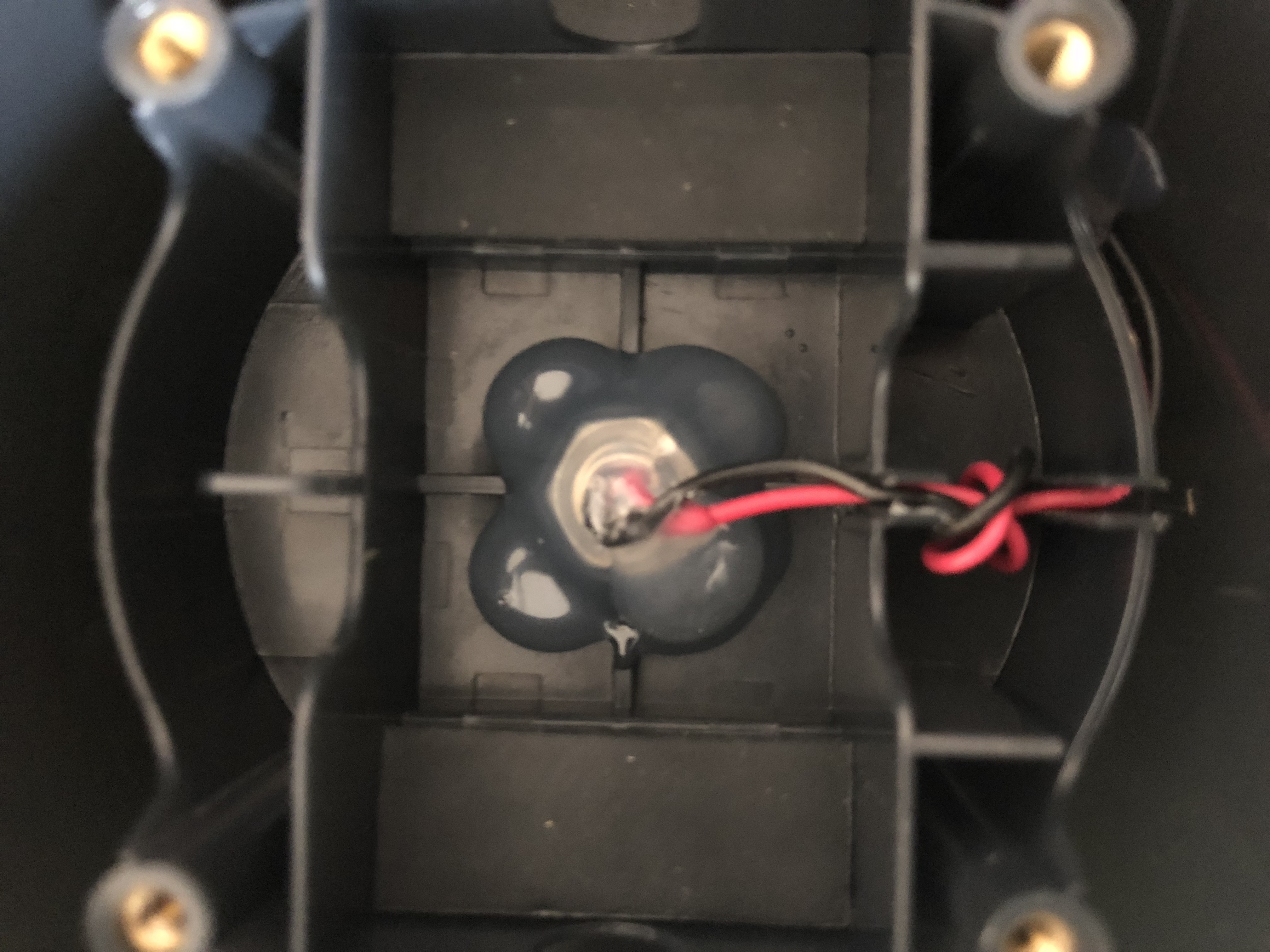

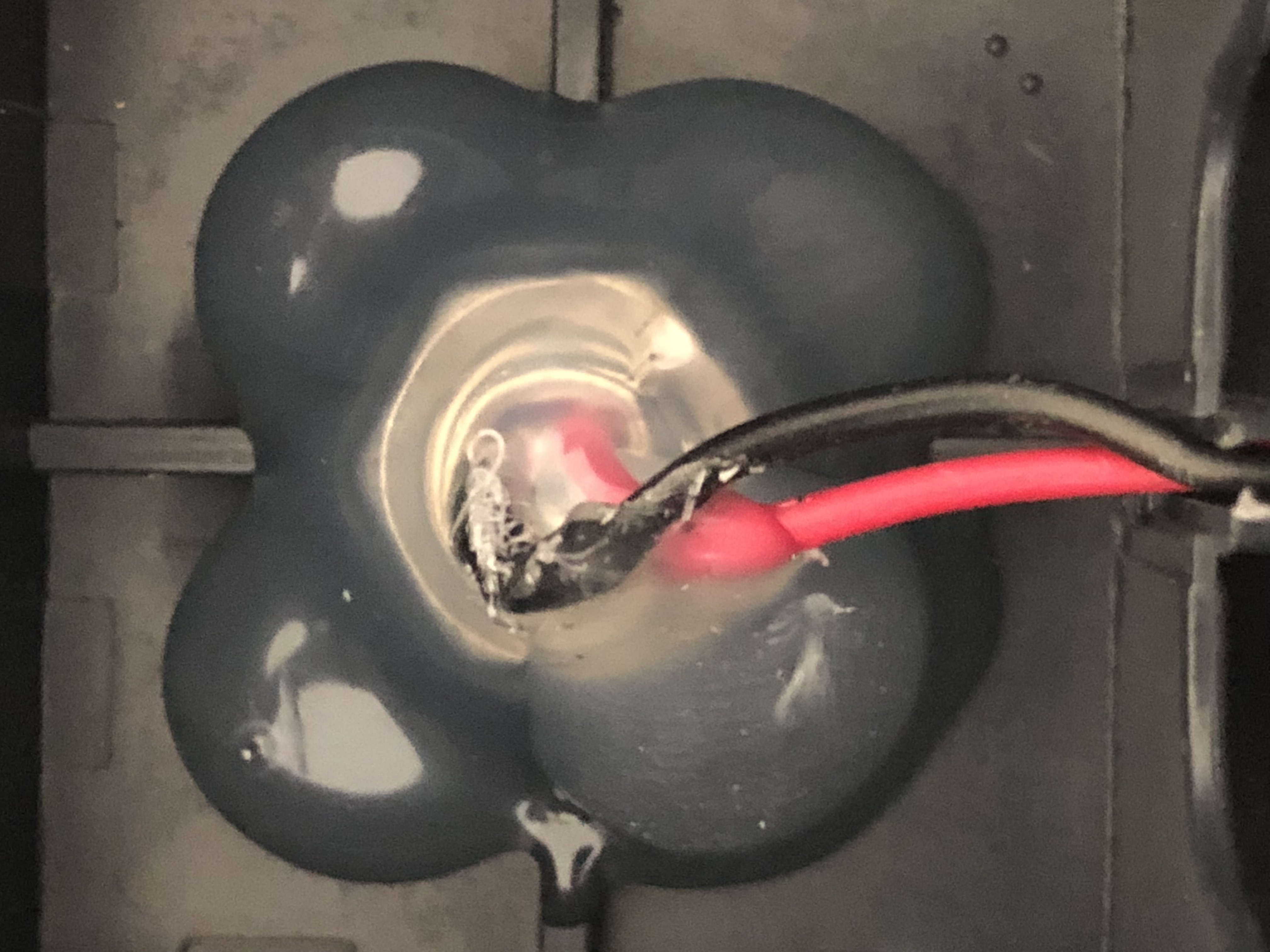

                    Recently I had to change batteries in the outdoor Netatmo wind sensor
                    https://www.amazon.co.uk/dp/B016OHME1A/ref=cm_sw_r_cp_api_i_ivx.AbS3R1HDF
                    The lower battery compartment was completely flooded and guess what - battery contacts were corroded. This is my solution
                    2_1526560229170_7D23BF18-1337-4E99-AFA1-4B030685FD79.jpeg 1_1526560229170_043CE5D1-1DAD-4200-A4C7-7CD21C7933AC.jpeg 0_1526560229167_40DB606D-611A-4E88-A5CC-D05B3B4AC7E9.jpeg
                    There was a small water ingress from the top. I have used hot glue to prevent it in the future. Cleaned the battery contacts with a contact cleaner (it also puts a anticorrorion protective layer on the metal) and that’s it
                    NeverDieN 1 Reply Last reply

                          @alexsh1 I hope it lasts long term. I tried the same sort of thing using hot glue on a chinese led garden light (which almost seem designed to quickly rust), but it failed in less than 3 months anyway.
                          On the plus side, hot glue is much easier to apply than epoxy, and it's very inexpensive too.
                            hot glue can be removed with heat, but epoxy would not be that easy :D
