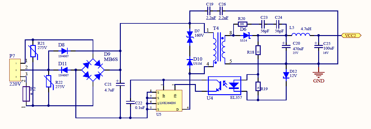

  • @axillent said in AC-DC at own:
    EE10-A1
    Congratulations! It can replace the HLK-PM01 that we are using a lot here. Is it possible for you to share the schematics ?
  • Mod
    @jeremushka for sure
    schematic is standard, simplified version from datasheet
    D8, D11 and R22 are optional, it is to be able to source power from different sources (for example different phases, or from main power and from generator).
    D12 I'm using 11V to have output at about 12.1V
  • Thanks. What is the purpose of the inductor at the output of the circuit? why not to use one also after the bridge rectifier?
  • Admin
    @axillent - Nice to see you here again! Well done 👍
  • Mod
    @blacey thanks
  • Mod
    @jeremushka said in AC-DC at own:
    inductor at output is to reduce riple
    on hight voltage side will be better to put filter but there is no place for it
    inductor as such will not bring too much value
  • @axillent thank you. it is clear information 🙂 very nice work
    some questions regarding the schematics:
    1. does TVS diode 600W 5V is efficient enough? or absolutely need cut off at 160V such as 600W 160A ?
    2. for the Fuse, a slow fuse 10A is enough i think, isn't it?
  • Mod
    TVS need to be for 120-160V in case you supply 230V AC. You can refer to linkswitch designer for your specific needs.
    The purpose of this TVS is to be a snubber because of inductive load. Instead of TVS an RC snubber could be used.
    it is 3Watts supply, 0.5-1A slow fuse is fine
