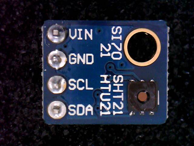

            So, LED is blinking like it should, and I can download sketches to it. I plugged in an si7021 board, and that's working too:
            Humidity: 44.42 Temperature: 22.22
            Humidity: 44.40 Temperature: 22.22
            Humidity: 44.43 Temperature: 22.23
            Humidity: 44.43 Temperature: 22.21
            Humidity: 44.43 Temperature: 22.22
            Humidity: 44.44 Temperature: 22.22
            Looks as though a BME280 board, which has the same pinout as the si7021 board, should work also.

                    I designed the miniature board in the earlier post for the temp-RH sensor to hover over the atmega328p.
                    Maybe it doesn't matter all that much, but after assembling one that way, I'm realizing it would be better to have it hover over the radio instead because the radio antenna means that the radio side is more likely to be facing up and the atmega328p is flat enough that it can be sat upon on the bottom with the radio on top without complaint. As it stands, the temp-RH sensor could still be installed on the radio side of the PCB, but it would be facing outward (resulting in a larger footprint) rather than inward, hovering over the radio. Since the point of this node is to be small, the status quo somewhat defeats the purpose. So, I'll likely be revising the PCB layout to make that change. Also, I'll be eliminating those RFM69 pads that don't actually need to be soldered, as that will reduce that soldering/assembly time.

                            Here's the assembled small Temp-RH node:
                            I suddenly realized that if I flipped the si7021 "upside down", then I could install it on the other size of the board from what I had originally intended, all while still using the existing pinout. -I'd prefer to have the actual sensor element facing up, but it works.
                            So, as you can see, the entire thing is barely much bigger than the RFM69HW itself. On the opposite side is the SMD atmega328p-au , an SMD LED, an SMD resistor, and an SMD capacitor. That's it. I can reset the board and upload sketches to it using my FTDI adapter board, as I wrote about earlier in this thread.
