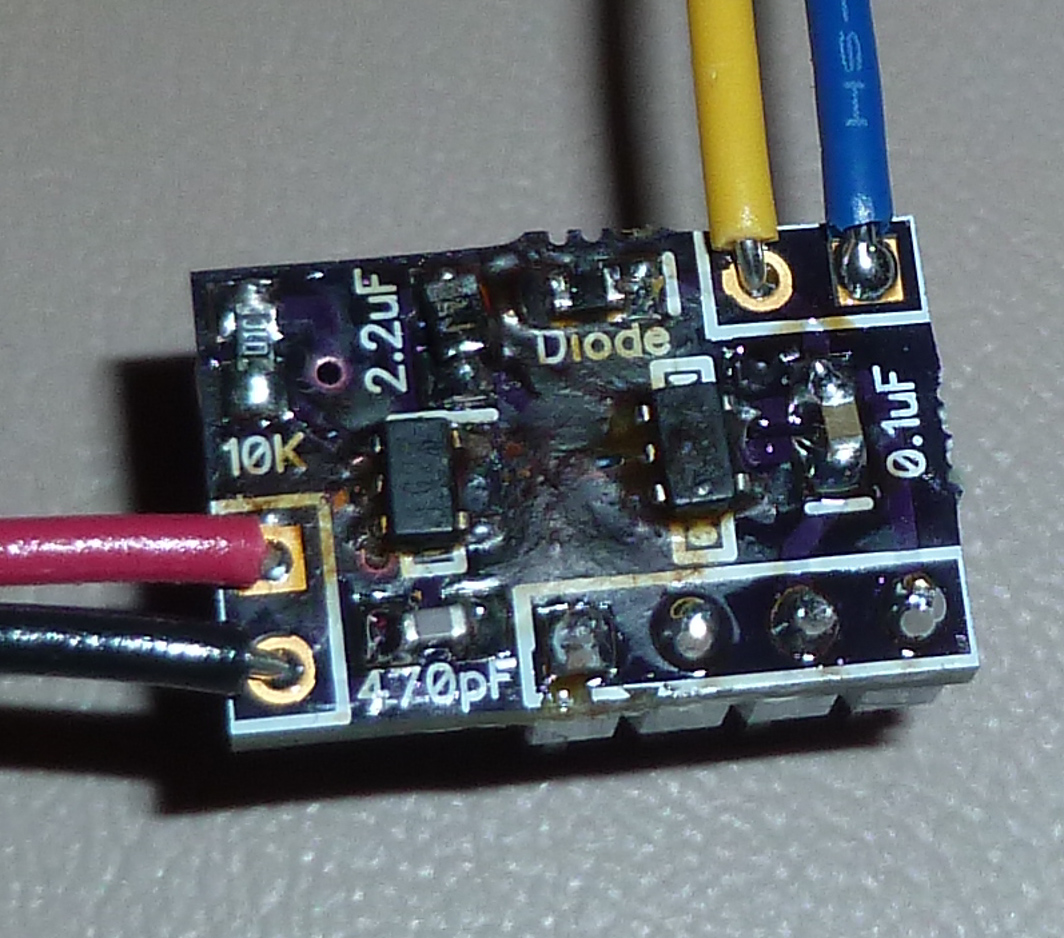

          • NeverDieN
            NeverDieN
            This may be an improvement over the project schematic:
            It uses an additional diode so that a nearly empty supercap can still be charged if the solar panel voltage is below the 1.5v minimum for the MAX40200 ideal diode. This needs to be tested, but the idea is that the MAX40200 would dominate once higher input voltages are reached. Anyway, the benefit of using an ideal diode in the first place is to avoid the very long charge tail that you get with a regular diode, but that isn't really a factor if the supercap is nearly empty. Hence, a hybrid approach may turn out to be optimal.
            On the other hand, I expect most of the charging would happen at higher voltages anyway, so this is really just a refinement that may well be optional.

              NeverDieN
              NeverDieN
              OK, I tried it both with and without the diode, and the diode makes no difference. I think it's maybe because maybe the LDO (or its enable pin?) needs to see a minimum of 1v to pass any current at all, and more like 1.5v to pass current freely.

                      @nca78 said in 💬 Easy Supercap Fast Solar Harvester:
                      You mean you made it only with the LDO ???
                      Here's a photo of the board I made and tested with the extra diode:
                      Hopefully that clears up any potential confusion.
                      • NeverDieN
                        NeverDieN
                        Bad news I'm afraid. The enable/disable feature tested out correctly when powered by a bench power supply, but I found out today that when powered by a weak solar panel, it doesn't work as intended. DISABLE just doesn't provide enough of a full shut-off to accurately read the solar panel's voltage (the same voltage as if the solar panel were disconnected). Instead, a lower voltage is manifested.
                        Unfortunately, I don't know how to correct for this. Unless someone else can post a solution, I'm afraid this project probably is not worth doing. :(
                        Therefore, I am reverting it to "work in progress."

                                      NeverDieN
                                      NeverDieN
                                      @alexsh1 It turns out it does work. You just need to substitute much higher value resistors (e.g. 10M instead of 10K and use much higher values for the resistors in the voltage divider) so that under low light conditions the voltage measured on the unloaded solar panel doesn't show less than it should.
