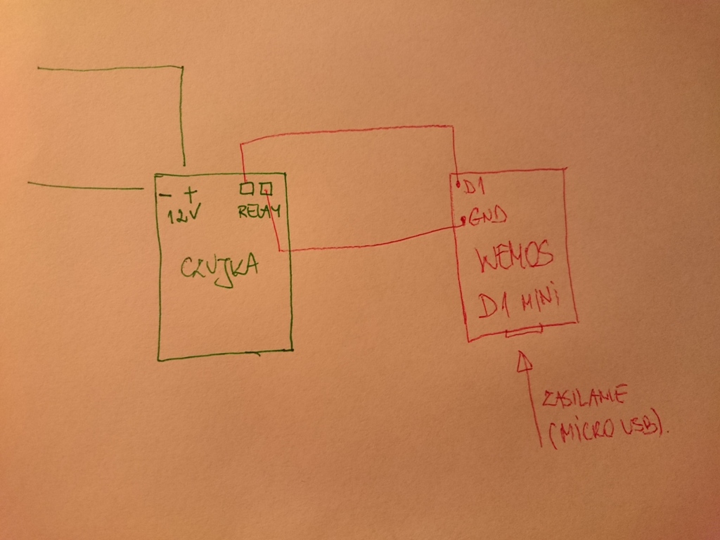

                  I faced another problem. Now i've conected one of the PIR via WemosD1 mini with ESP Easy.0_1497208049084_DSC_0864.JPG
                  And works very well.
                  But i would like to connect 3 more sensors.
                  Power supply for PIR and Wemos is different and there is only one GND pin .
                  Any idea how to make it?
                    3 more sensor to the same wemos?
                    • M Offline
                      M Offline
                      mckenzi
                      wrote on last edited by mckenzi
                      Yes. Possible?
                        With mysensors it is possible, with esp easy I don't know.

                            Hi Gohan, please see my set up i more details.
                            Each of PIR is conected to old/not used alarm control panel.
                            Now it is used as power supply. I've just ordered Arduino Nano + nRF24L01 to conect all motion sensors. I would like to use one of free port to power my node (thru voltage step down : 12V->5V)
                            How should i conect sensors to node?

                              Do you want to put the nano in that panel?
                              • M Offline
                                M Offline
                                mckenzi
                                Hi, panel will be use as a power supply only.
                                  Ok, but if you put the nano in that location you will have the yellow cables coming back from the PIR sensors and you would have to use those to connect to digital pins of the arduino, the problem is that you need to check what is the voltage that most likely will be over 5V and you would need to find a way to lower it.
                                  • M Offline
                                    M Offline
                                    mckenzi
                                    Yellow cable is connected to PIR's relay. And this cable i'm going to conect to digital input of arduino.
                                    Second cable from PIR's relay will be connnected to arduino's GND pin. ( not shown on this photo).
                                    There is no voltage on PIR's relay ( works as simple switch).
                                    Is my understanding correct ?
                                      If it is just a relay ok, I thought you were using the output of the pir sensor, but always check before connecting to the Arduino
                                      • M Offline
                                        M Offline
                                        mckenzi
                                        So how to connect 4 PIRs to one node to be able to see in Domoticz which was acivated ?
                                          Connect each one on a different digital pin and create a different child id for each pir sensor and present all of them, it is just replicating 4 times the code of the motion sensor sketch.
