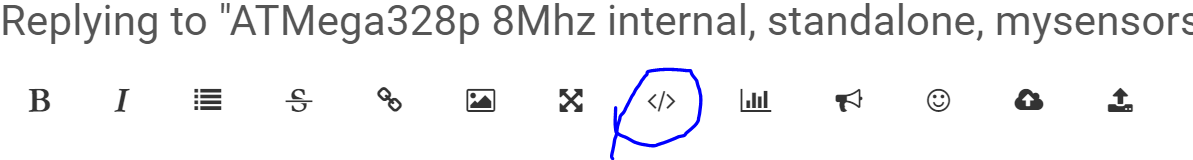

          (p.s. I put the sketch in your post between code marks for better reading) 0_1490256228810_upload-e508ae50-3ab8-4f21-872d-31cd6ee9f282
