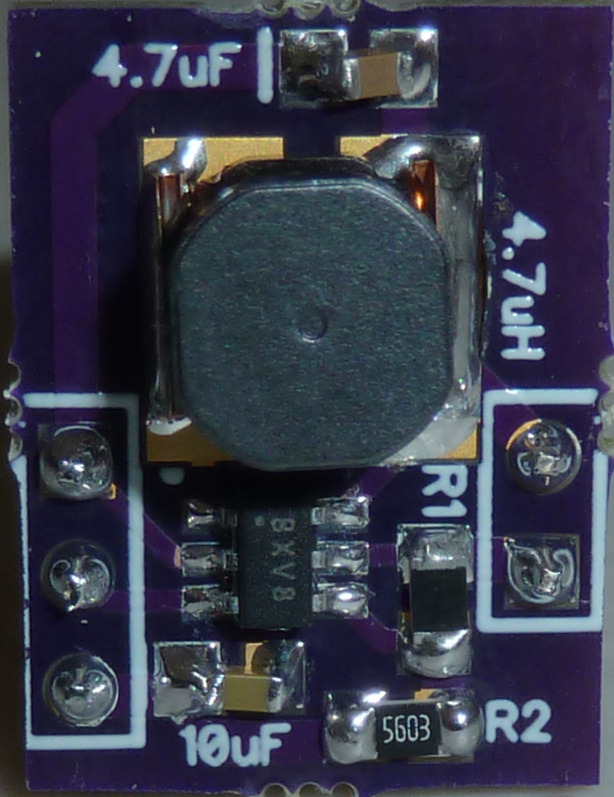

      @NeverDie
      cool ;) i know better but you wouldn't like to solder it i think :)
      about routing, i was referring about notes at : section 5.7 p.16-17
      NeverDieN 1 Reply Last reply
      • scalzS scalz
        @NeverDie
        NeverDieN
        NeverDieN
        @scalz said:
        @NeverDie
        That's interesting. I haven't done a pattern shaped like Figure 5-1 before, but I suppose it's possible to replicate it almost exactly. I guess then, by definition, it would meet their specs.
        • scalzS
          scalzS
          scalz
          wrote on last edited by scalz
          yep that's what i wanted to explain, not the sch but the routing ;)
          this is a very important section in datasheet. all the datasheet sure, but a bad routing a crppy thing :)
          cool if it can help you, i'm glad

                    The problem for me is that this is suddenly a lot more work than I had planned on. I have about 8 different booster chips I was planning to brute force try to see which worked best in the application. If I have to create stringent patterns for each just in order to try them, it's going to exceed the time I had budgeted for this. So, I'm going to put this on hold.
                    I've already ordered the boards that I had posted. I'll try them out after receiving them. Maybe some of them will work well enough to proceed from there, or at least narrow down the list of candidates for which I create more detailed patterns. Anyhow, thanks for the input. At least if they aren't working as expected I'll have some idea as to why. One of the chips has built in MPPC, and so I might just focus on that one, as it really is intended for a solar application.

                                To expedite things, I just now posted Version 2:
                                1. I re-did the routing placement to make it conform with the recommendations, and
                                2. I cleaned up the silkscreen to make the component labels more legible.
                                • NeverDieN
                                  NeverDieN
                                  I just now posted Version 3.
                                  Changes from Version 2:
                                  1. Change to using the same type of shielded inductor that my other boost projects are using.
                                  2. Eliminated unnecessary header pins, and added a ground header pin.
                                  3. Changed the silkscreen on the MCP1640 land pattern to mitigate against potential for solder bridging.
                                  • NeverDieN
                                    NeverDieN
                                    I've tested the board, and it works.
                                    Please purchase your PCB's for this project from the following link: https://pcbs.io/share/zyLW7
                                    • NeverDieN
                                      NeverDieN
                                      Here is a photo of the assembled PCB, taken next to a quarter for scale:
                                      • NeverDieN
                                        NeverDieN
                                        This project is now finished. :smile:
                                        • NeverDieN
                                          NeverDieN
                                          Setting R1=680K gives a voltage output of 2.674v, which is great for charging 2.7v supercaps.
