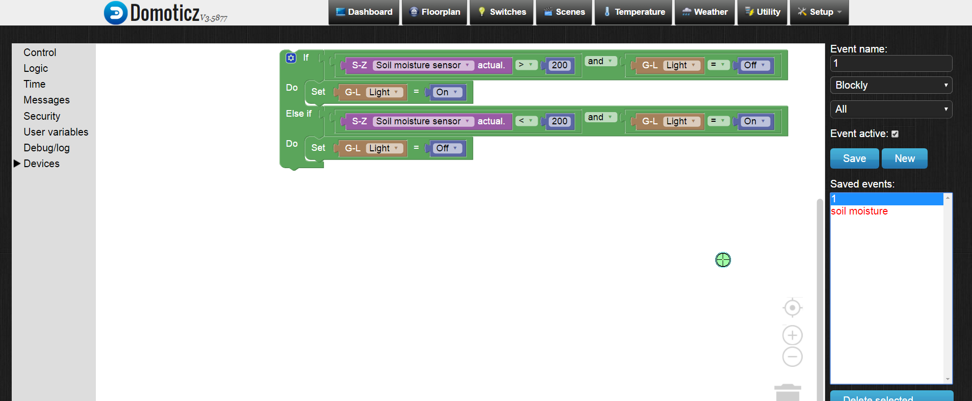

        2017-04-24 21:46:05.283 Error: EventSystem: Lua script error (Blockly), Name: soil moisture_1 => [string "result = 0; weekday = os.date('*t')['wday']; ..."]:1: attempt to index global 'utilitydevice' (a nil value)
        I have no experience with this thing i currently have no idea :disappointed:
        It would be good if works
          How do you present the soil sensor? Maybe I can try to replicate your error
          • k5austriaK Offline
            k5austriaK Offline
            k5austria
            Sorry !!! I have not seen your answer again !
            I tried everything but it did not work. The problem is value from soil moisture sensor . I think so !?
            If you fix the problem you have a drink from me :grinning:

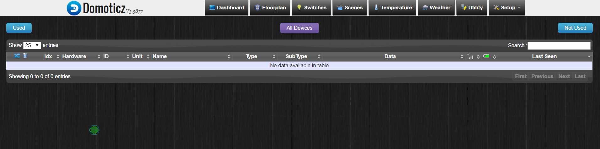

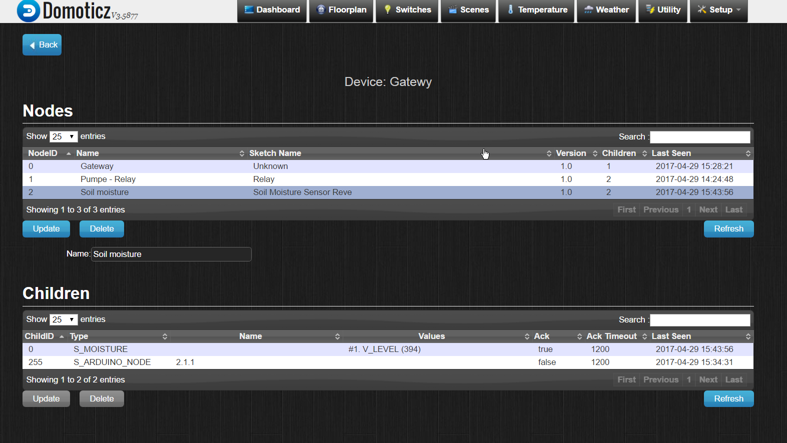

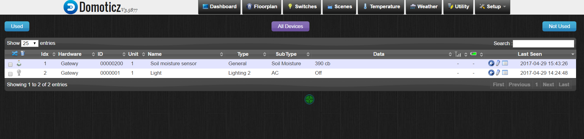

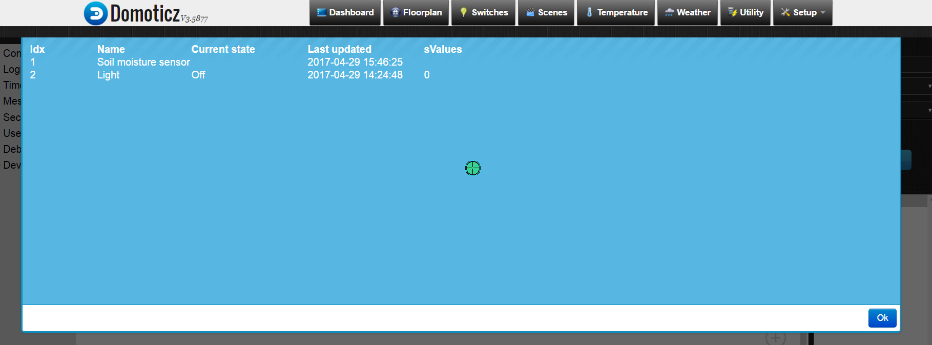

            5_1493474335770_2017-04-29 15_46_39-Domoticz.png 4_1493474335769_2017-04-29 15_46_03-Domoticz.png 3_1493474335768_2017-04-29 15_44_25-Domoticz.png 2_1493474335767_2017-04-29 15_44_11-Domoticz.png 1_1493474335765_2017-04-29 15_43_47-Domoticz.png 0_1493474335763_2017-04-29 15_43_25-Domoticz.png

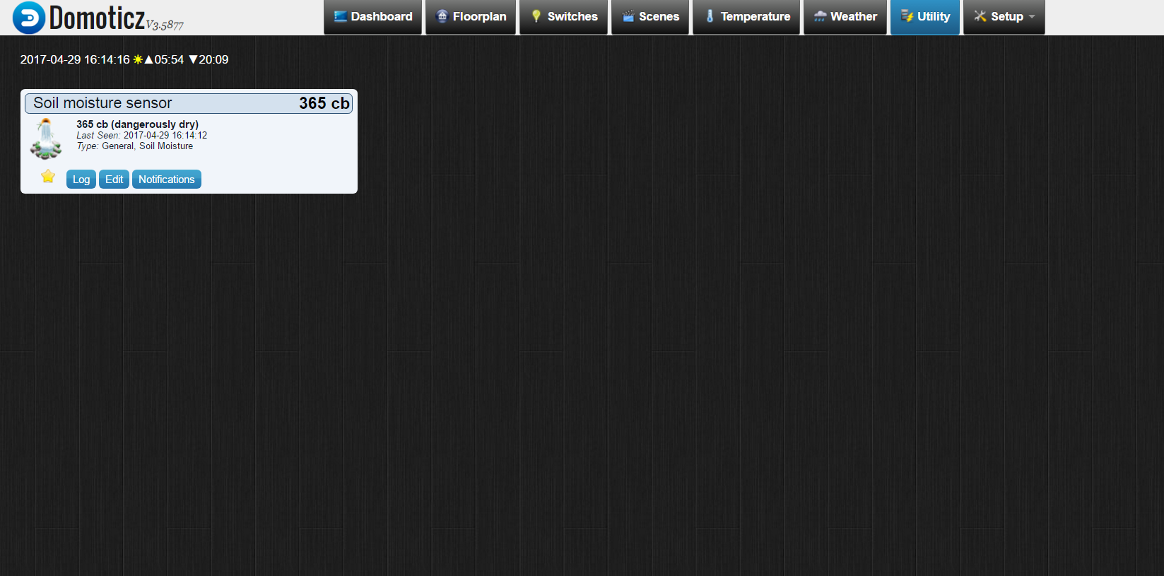

                    According to this project, he is using V_HUM and S_HUM. Maybe you could give a try and also include his more advanced features
