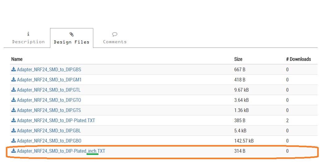

      I tried uploading a zip of your design files to OSH Park, but OSH Park says that there's no drill file among them. Is there?
      kalinaK 1 Reply Last reply
      • N NeverDie
        kalinaK Offline
        kalinaK Offline
        kalina
        @NeverDie Yes, file is there ....

          There seems to be a fault in those drilling instructions though. Here's what the board looks like if I upload the files to OSH Park:
          • N NeverDie
            kalinaK Offline
            kalinaK Offline
            kalina
            @NeverDie said in 💬 DIP to SMD NRF24L01 adapter:
            Yes, I see. The problem is that I released the gerber files in the metric system. Now I have released a new drill file. You can try again.
              N Offline
              N Offline
              @kalina
              Thanks! Looks like that fixed the problem. :)
