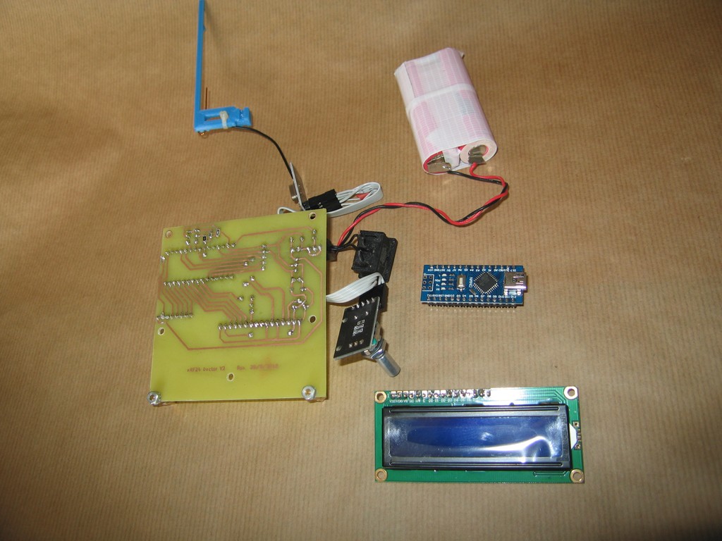

    Inspired by the connection quality meter found here: https://forum.mysensors.org/topic/3984/nrf24l01-connection-quality-meter
    I had an attempt on building an extended version. My goal with this device was to be able to diagnose many different nRF24 related topics, like a real doctor ;-).
    Goals:
    1. Check if nRF24 module is dead
    2. Qualify current consumption of different nRF24 modules in both standby and sleep (as some clones appear to have high current consumption during sleep)
    3. Evaluate “performance” (e.g. range) of different nRF24 modules
    4. Find the best settings in nRF24 Channel (Frequency Band), Power Level and Data Rate
    5. Diagnose transmission delays
    6. Determine the best location for your gateway
    7. Determine reception range, reception dead spots and new locations for a secondary gateway or repeater nodes => Portability
    8. …

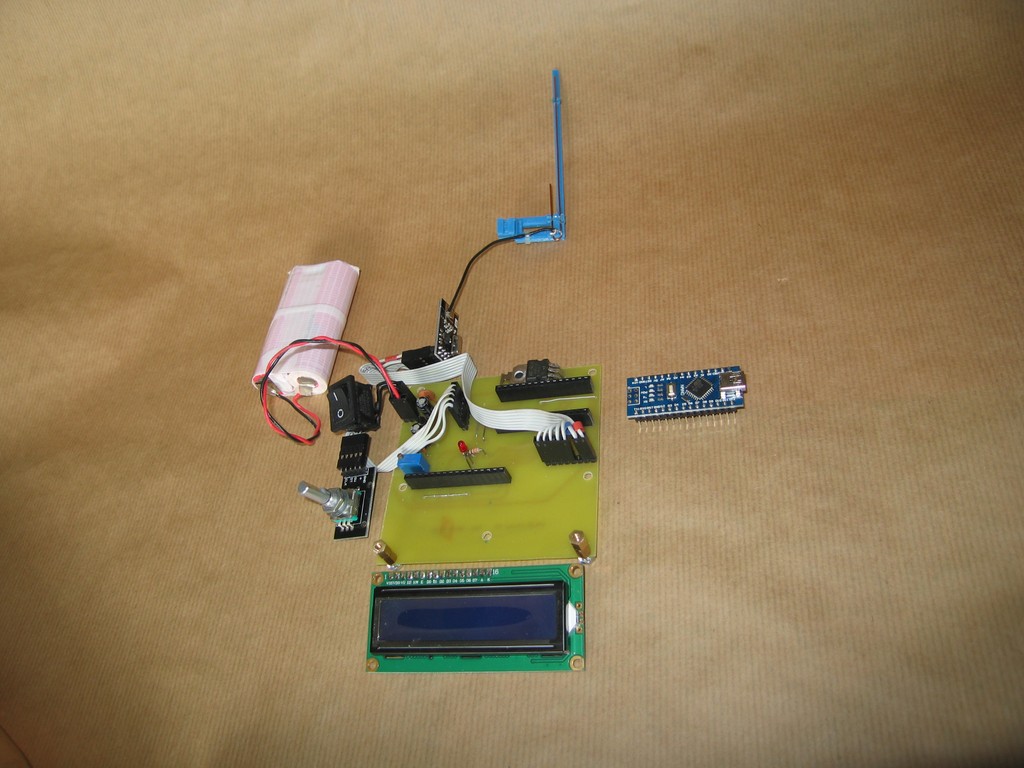

    Hardware realization:
    • list itemAn Arduino Nano
    • 16x2 Character LCD
    • 2 Buttons
    • 2 Mosfets (e.g. IRLZ44 or comparable. Must be VGS logic level and preferably in a big package (e.g. TO-220) as smd mosfets will have a (too) high RDS(ON) and will impact your current measurement (especially for the 2.2Ohm).
    • 3 Resistors (2.2Ohm, 100Ohm, 10kOhm)
    • Some wire, socket for the radio and hot glue.

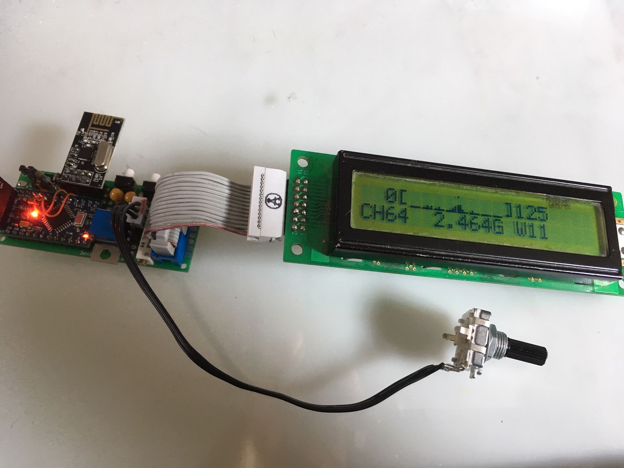

    Features:
    1. On the top you can swap the radio’s with the common 8-pin interface.
    2. On the left is the USB connector to power it from a Powerbank for Portability (and of course to re-program the device if necessary)
    3. The central LCD screen…to provide the necessary feedback to the user.
    4. White button 1:
      a. Short Click: To accept changes made in a menu and continue to the next menu
      b. Long Press: To Escape without storing changes to EEPROM and Return to main menu window
    5. Orange button 2:
      a. Short Click or Hold: To Change setting in a menu.

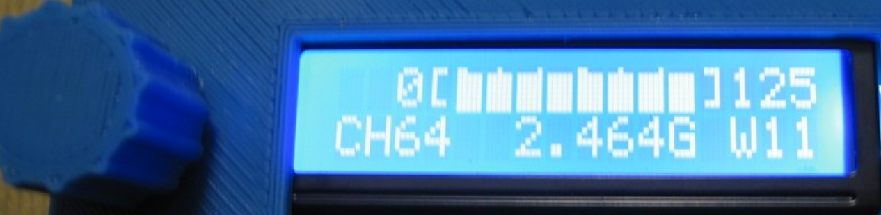

    So what it can do so far is probably best demonstrated by showing the available menu’s:
    1. Start Up Screen
    It attempts to connect to your Gateway with the settings stored in its EEPROM (Channel, Data rate, PA-Level and Base Radio ID).
    2. Main Quality Connection Overview
    • First Line: Parent Node (P0) = Gateway and the number of transmitted messages by the nRF24 Doctor node which FAIL to acknowledge the first HOP transmit (if no repeater nodes are present, then the first HOP will be the Gateway).
    • Second Line: The set Destination Node (D?) and the number of transmitted messages by the nRF24 Doctor node which did NOT receive an Acknowledge back from the Destination Node.

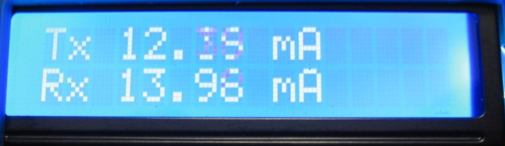

    4. Total of Transmitted Messages
    • First Line: Average current consumption of the nRF24 Radio during Standby
    • Second Line: Average current consumption of the nRF24 Radio during Sleep.
    • Notes:
      • Units will scale accordingly to [mA] or [uA].
      • Requires Current Measurement circuitry to be added.

                              @Yveaux
                              Done ! With your great help on github, I made one nRF24DoctorNode.
                              Some modifications : Battery powering with two LiIon from laptop, for 7.5 v on Arduino Nano Raw
                              The 1117 of Nano out 5.0v for Nano, LCD1602 and KY040 Rotary Encoder.
                              Finally the 5.0v powers a LE33 to produce 3.3v for nRF24.
                              Resistors smd, led and mosFETs (I try 40N03) are "second hand parts".
                              With your PDF schematics I redraw à nRF24DoctorNode with KiKad.
                              And a pcb, not so beautiful and compact than yours, but "Home made" 85x85mm single side with four straps.

                                    @Yveaux
                                    Thank you very much for your answer.
                                    I upload nRF24DoctorNode.ino with commented line and ... It work's ! But it don't see any of my three gateways one serial and two Ethernet W5100 which are all on work.
                                    First I have to build a fourth one with the nRF24DoctorGateway.ino sketch.
                                    Some photos:
                                    Front
                                    Front without Nano & LCD
                                    Back
                                    KiKad schematics:
                                    Pcb:
                                    And LCD modifications:
                                    For D4 - D7 LCD
                                    #define LCD_D7     8  // 5 due to easier pcb design
                                    #define LCD_D6     7  // 6
                                    #define LCD_D5     6  // 7
                                    #define LCD_D4     5  // 8
                                    At last, I need to build an enclosure...
                                    Rpx.

                                        And then Doctor is at work!
                                        Enclosure Open
                                        Connecting
                                        Msg
                                        Message Count
                                        Tx Rx
                                        Sleep
                                        Scan
                                        At last, nRF24Doctor is working. Except scan due I think to use MySensors Library 2.2.0.
                                        I don't know if a nRF24 PA LNA (20dBm) can be tested with nRF24Doctor but if my circuit design is used you should change LE33 witch output max 100mA because nRF24 PA LNA need 150mA min.
                                        And one problem, a test with nRF24Doctor "freeze" Domoticz 3.8153, I need to stop service Domoticz and start to have a Domoticz web access.

                                          @rpx
                                          @Yveaux OK with a nRF24 gateway it's working fine. But, and I don't remember why, I need to strap pin 8 of nRF24L01+ (Irq) to Nano Pin D2, which is not required on mysensors gateways.
                                          And with MySensors Library 2.3.0 beta Scan is working.
                                          This pattern is a 950W microwave owen near by 0,60 meter.
                                          The graph has 8 pixel high, can you give me a idea of the power scale of each pixel ?
                                          And I plan with friends help, to measure differents antennas in open field as J pole, Yagi-Uda and cloverleaf.
                                          Rpx.
