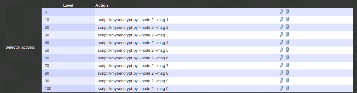

    Some time ago I made a custom servo-lock which is connected to MySensors network and can be locked/unlocked either manually, with button on a door knob or remotely on the Domoticz web page. Since this lock is located on one of my entrance doors I wanted it to be as secure as possible. Unfortunately neither Mysensors nor Domoticz doesn't provide reliable solution for this kind of appliance. As discussed here once you are on your local network you can easily get access to all sensible data. My idea was to make pin-code protected switch to open my lock remotely.
    Domoticz would collect presses on the selector switch and then send them as a string to a node, which will compare pin-code with the one saved in it's memory and unlock the door if it's correct. Good idea but not secure at all as long as string is transmitted as a plain text. For this reason I decided to use AES cipher to encrypt pin-code message and send it to a node.
    After some research (aka google hard) I wrote a python script that receives a pin-code as a parameter, encrypts it with AES key, encodes it with base64 and then sends via socket connection to an ethernet gateway of mysensors. To be able to use it with available controllers i.e. Domoticz or Openhab I wrote it this way:
    1. It receives these parameters: --node - obviously a node ID for message to be sent, --ip - IP address of the gateway, by default it's 127.0.0.1 to be used with a RaspberryPi gw, --port - gateway port (default 5003), --key - 16 bit AES key, (it is not secure to expose it on web interface, so it's better to be changed in the code), --msg - pin-code itself which has to be 4 bits long, but you can change it for example to 6 or 8 bits in code, the longer ones won't be practical.
    2. Then it have two modes. The first is used in case if you pass whole pin-code at once (4bits), then it encrypts and sends it. In case you are calling the script with Domoticz, for example, it can collect your pin-code byte by byte and then encrypt it.
    3. In this case it checks if there is a copy of itself running. In case it doesn't finds any it makes a fork, creates fifo file in /tmp folder and waits for 10 seconds for next bit to be collected through fifo.
    4. If it finds a copy of itself running it writes to a fifo one bit it received as command line argument and exits.
    5. When 4 bits are collected it adds 6 random bits before it and 6 random bits after, so the string is 16 bit long. Then it encrypts it as a single AES block and then encodes in base64, which makes 24 bit long message to be sent to a gateway like this 1;1;1;0;47;uKvGG7z440r/1pln4IJbNQ==
    Node receives message decodes it and then checks if it's correct.
    On Domoticz side I use dummy selector switch with characters from 1 to 0.
    It reacts somewhat laggy (as everything in Domoticz) but after some delay it opens my lock. Also I use simple event script in Domoticz to switch selector switch back to "off" state after every change, so the last character of a pin-code won't show on page.
