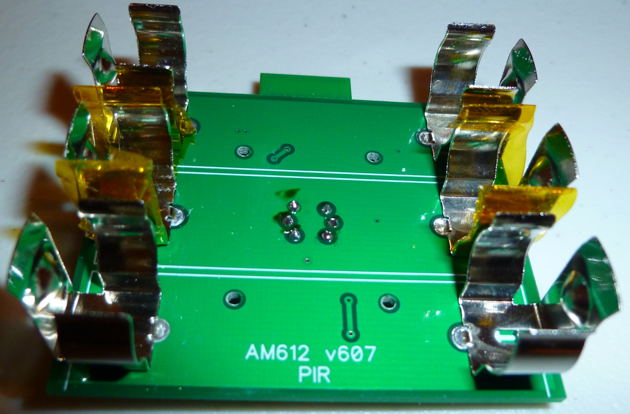

      I just now uploaded Version 602, which uses thru-hole battery holders (see BOM) instead of surface mount battery holders. The result is a more compact board and, perhaps, better mechanical strength as well.

                        I just now uploaded version 604, which uses an LDO better suited to meet the current requirements of the BT832X, in case that is installed. I have shipped the files to the fab, so I'll post an update after I've received and tested the board.
                        I expect that upgrading to use the nRF52840, when it becomes available, will be a simple drop-in replacement upgrade. :)

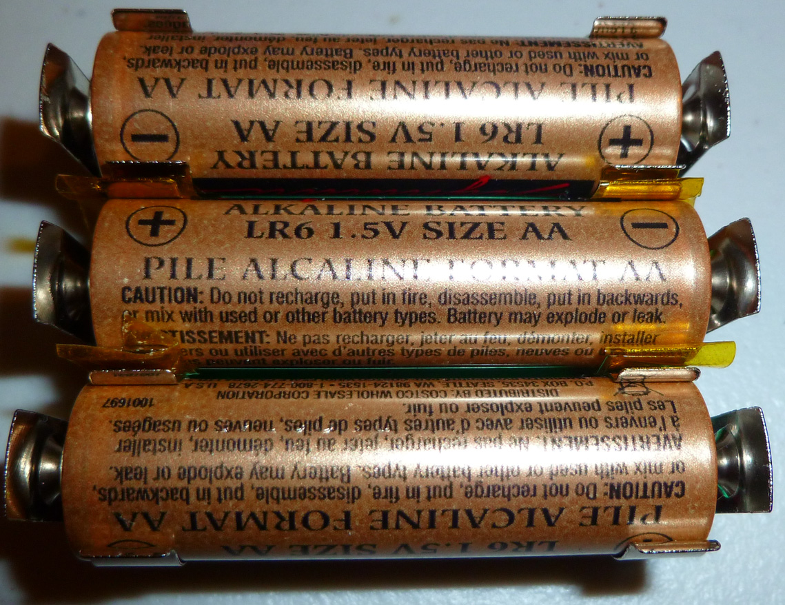

                            Because this is a compact design, the battery clips may touch. So, to prevent any short-circuiting, you may wish to use a bit of Kapton tape, or similar insulating tape (maybe even electrical tape) on the outside of the inside clips to prevent contact with the outer clips):
                            • NeverDieN
                              NeverDieN
                              Project completed. I've just now uploaded the files for version 607. I've tested this board, and it works. :)
