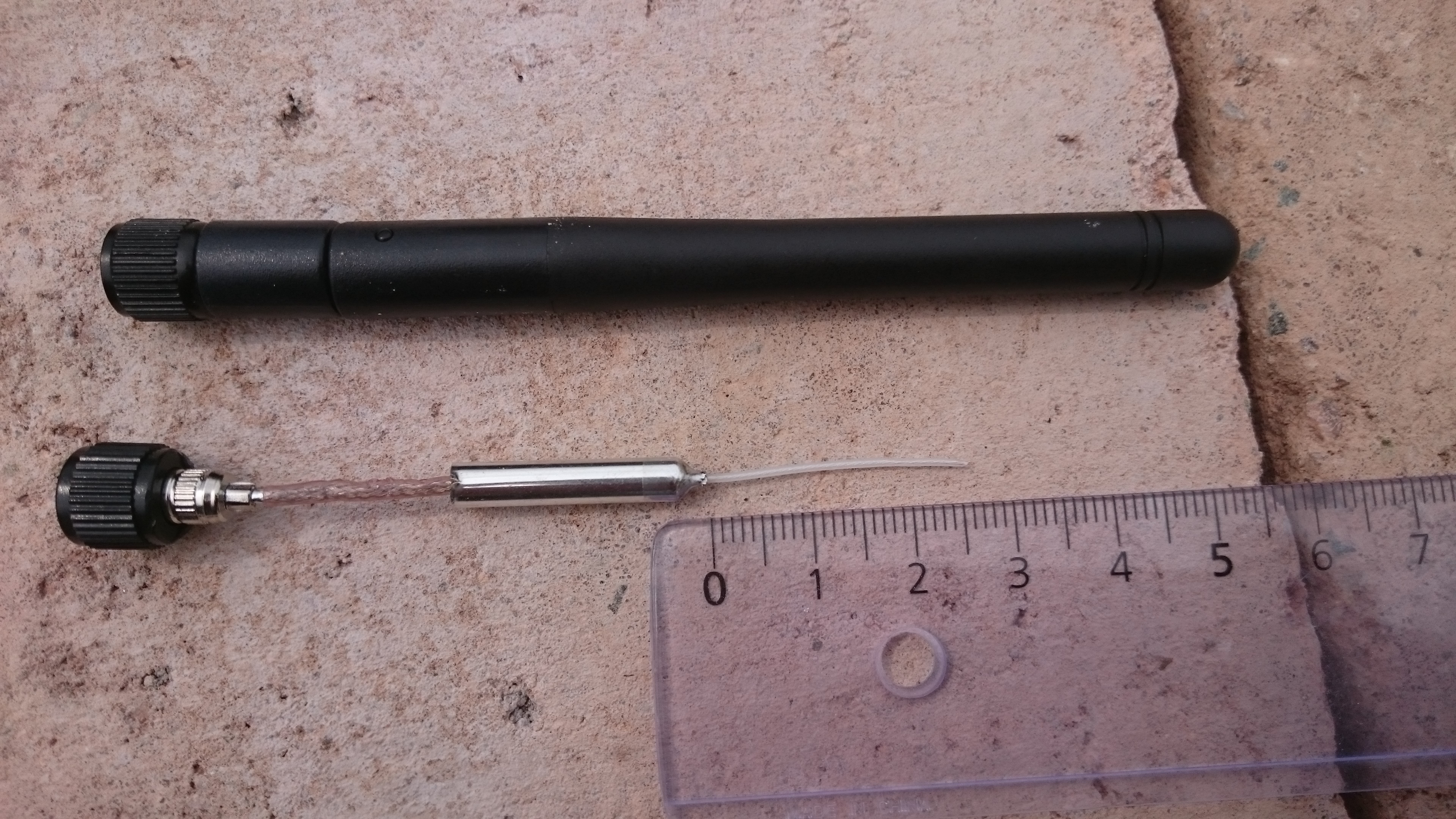

  • I also have a poor range. With all the tricks:
    • pairs of electrolytic+ceramic capacitors
    • short leads
    • max out emittance power
    • lowered KBS to 250
    • increased retries and delays
    • free of wifi interference freq
    • lowered payload to 4 bytes
    • powered usb hub for gateway
    • laptop USB powered arduino for sensor
    • what I did not try - is separate step down regulator for radio
    I got 10m at most through couple of walls. These are plain wood frame + drywall + insulation walls.
    Even that was only possible with max power output on both sides and 250KB/s speed + 4bytes payload. I'm not sure if mysensor serial protocol allow to change payload size. I had to go down to roots of nrf24 programming to debug my poor reception.
    Payload size was the greatest impactor by the way I had to make my own test hardware+software to do these range tests (simple echo server, sending time back, thus 4 bytes payload)
    I've almost give up on nrf24 and ordered 4 hopeRF 483MHz transceivers for testing.

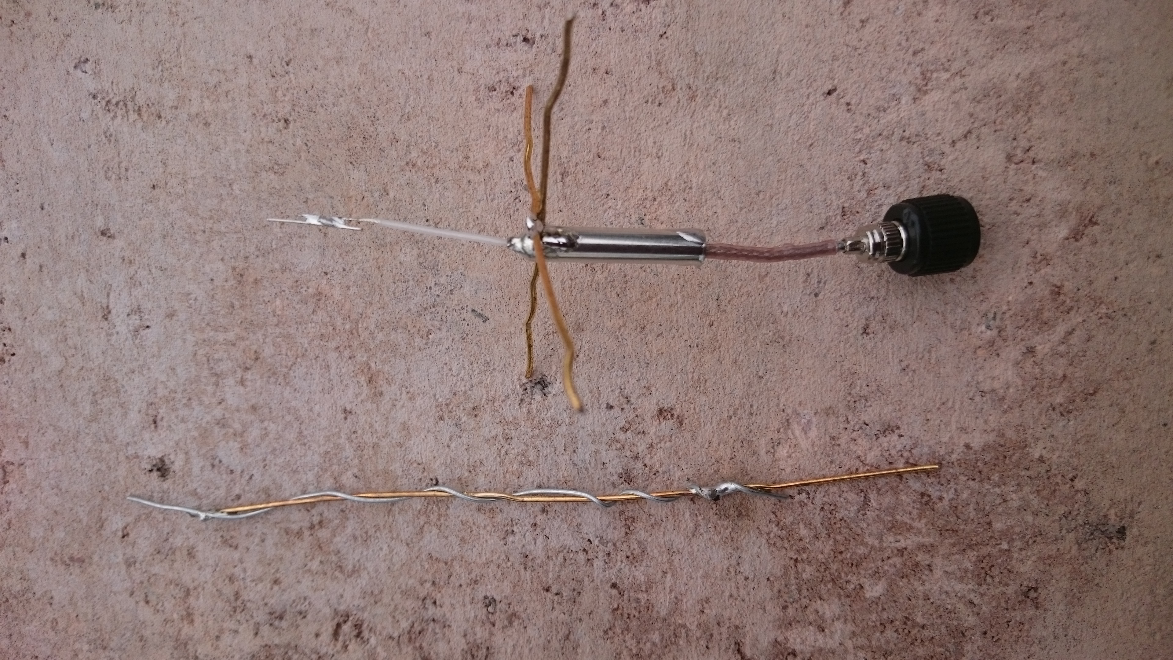

  • OK, so I tried with AA cells, no regulators.
    Plain and simple. TMRh20 lib.
    Not any better.
    I then tried with a chunk of bare copper wire 83mm long, soldered to the end of that curly PCB antenna - not any better either.
    Not sure what might I've done wrong. Layout is pretty simple
    image of nrf24 transmitter
    Voltage with load is 3.1V, current never goes above 19.2mA
    image of multimeter
    I tried with direct line of sight, range has doubled to say 20m, but again - nothing to write home about.
  • [Update for future generation]
    I think I found my issue. It was the large transceiver see image below, with power amplifier and external antenna.
    Once I replaced both receiver and transmitter with identical units, range got significantly better.
    60m clear sight and almost whole house through multiple walls.
    For whatever reason small unit can't hear ACK from the PA unit. I tried to reduce power on the PA end to
     radio.setPALevel(RF24_PA_MIN);
    but it did not seem to have any effect. My best guess now is that oscillator on the PA unit is slightly off. PCB antenna unit is battery powered.
    Power source to arduino UNO that drives PA unit is good, 5V less that 2mV ripple. The transceiver is powered via 3V3 output (onboard regulator) of UNO though, could it be the problem?

  • I'm currently in the process of trying to figure out why one of my battery powered nodes isn't working very well with a newly purchased NRF24L01+PA+LNA module. I've shielded it as described in earlier posts. There is plenty of pure power in the batteries.
    Just as in the case for @pkjjneal it works well only if I'm touching the antenna with a finger.
    I decided to look inside the antenna:
    As you see above, it starts with an antenna cable that leads to a half wave dipole (where the antenna element is of about 1/4 wave length) and there is a "sleeve balun" going back over the cable . I can find no ground plane though. The problem that I can see is that the antenna length is 27 mm where it should optimally be 28.8 mm.
    Now, if I remove the antenna completely my node works quite well. At least better than if I use the original antenna unmodified.
    If I insert a wire (DIY antenna made by a paper clip) extending 121 mm out of the antenna sockets forming a full wave length antenna things work great.
    I also modified the original antenna so that the antenna element becomes 28.8 mm. It works a bit better but it's far from perfect and communication errors are shown in the log.
    As the final test, I added a nice ground plane to the original antenna and now it works really perfect!
    So what can I learn from this?
    My test rig is an EasyPCB powered with batteries. I'm quite sure that my NRF24L01+PA+LNA module used in another scenario, for example connected to a Arduino Nano fed by a FTDI connector could actually work. It's because it would create a different environment. The antenna will work in relation to what it's connected to, shielding the grounding, and surrounding objects. Capacitive and inductive reactances are involved in mysterious ways.
    Anyway. My conclusion is that the two original antennas I have are not working very good. They obviously have the wrong length just a little bit, and I'd say that the the way the antenna is constructed with the sleeve balun and no ground plane, doesn't seem to work well. At least not here.
    I'll do some more experimenting with making my own antennas. Starting with taking apart an original antenna is not so bad, I can solder anything (solderable) onto the cable.
    Cheers!
