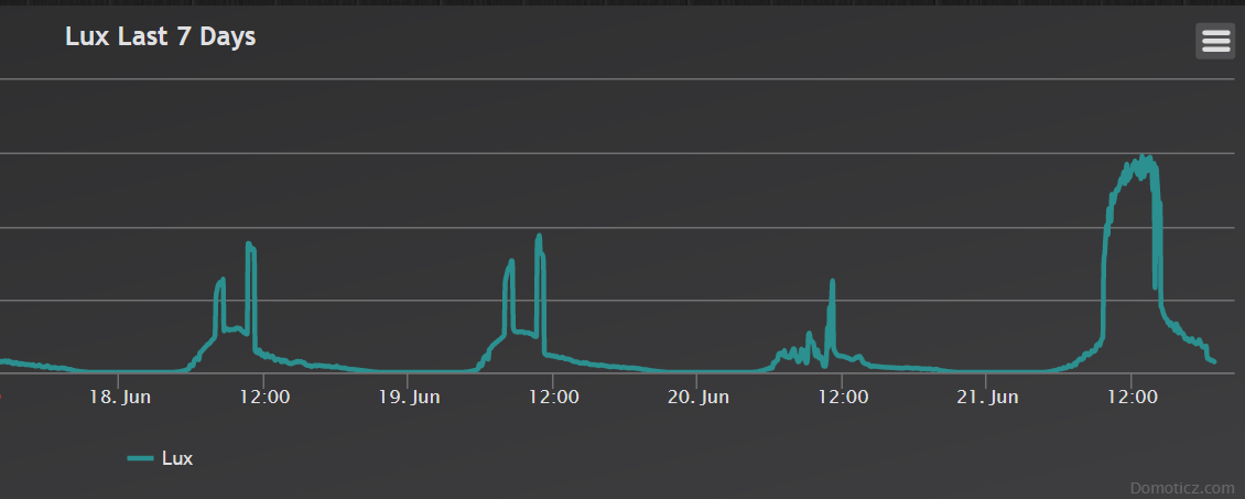

                                          This is the VEML6070 UV Index graph. The last day, I placed the sensor outside rather than behind my window. There is a huge difference :
