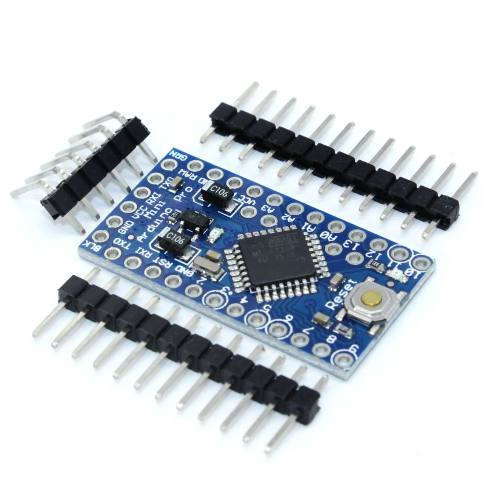

  • Cutting the voltage regulator
    mppM mpp
    Troubleshooting
    Thanks for the tips.
    No, you need to feed a regulated voltage to VCC. The "easy" explanation is that the voltage regulator is only engaged when providing a powersource to RAW.
    I don't get this, I never use RAW so there's no advantage in removing the regulator.. ?
    Isn't it the other way round, that the regulator is only engaged when using VCC?
    mppM mpp
    Troubleshooting
    thanks @sundberg84, seems like I broke mine as well. Some questions remain:
    • How can the board keep working when it is completely removed, don't you need to bridge some pads?
    • What pins should I use to program it (There's only one VCC pint but some arduino clones seem indicate several GND pins where some other indicate blk or dtr)
    • What voltage do I supply without the regulator (I assume 3.3)?
    mppM mpp
    Troubleshooting
    It's not clear to me how to properly cut the regulator. According to this documentation it should suffice to cut one leg but then I don't see how this could work?
    This is the board I'm using:
    This is the board I'm using.
    Should I completely remove the regulator? Or how will it work if I only cut the lower right leg?
    I tried cutting the wire just before the circle as marked on the image but then I couldn't program the board anymore. Perhaps I cut it in the wrong place or I'm feeding it gnd/vcc wrongly?
