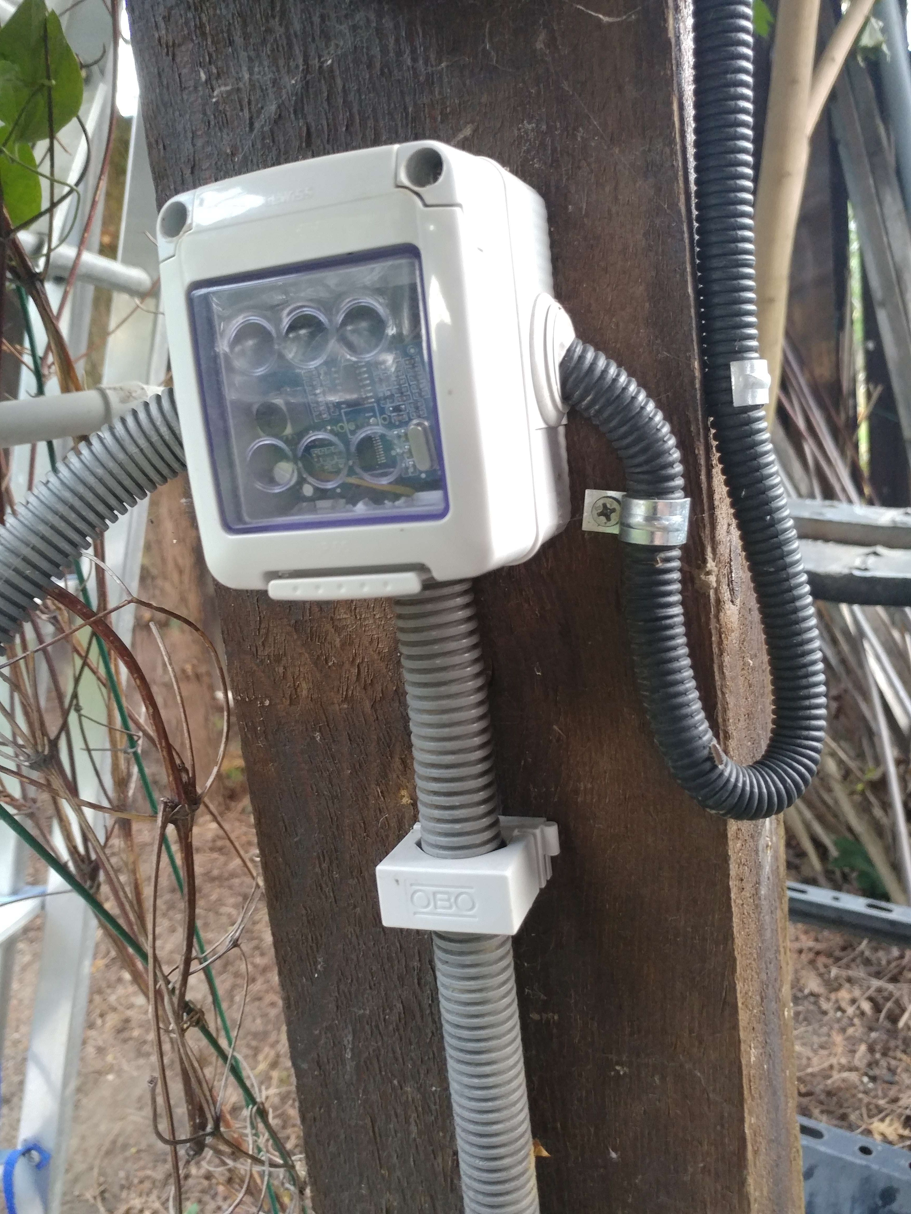

    Hi there! I have a few moisture safe enclosures for outdoor sensor. At least, that's what I thought but inspecting one of them today due to failure (see attached image below) made me aware that they are not moisture safe at all. They even seem to suck moisture from the outside and store it inside the box.
    I guess that the plastic that the box is made of isn't moisture proof.
    If some of you guys have experience to share with me on this topic I'd appreciate it a lot. I'd like to rebuild this repeater node using an enclosure that does not allow moisture to enter it and eventually destroy the electronics. Stability of operation and an enclosure that resists the environmental challenges that it will face has a much higher priority than the cost of the enclosure.
    Cheers!
    JodailleJ zboblamontZ 2 Replies Last reply

      Hello @รอเร-อ
      I have never managed to build a box 100% waterproof.
      Water always find a path :)
      Maybe you could try to make a small hole at the bottom to let the condensation leaving.
      But then some spiders can go inside and shortcut some wires :)
      GreatScott has done some video about waterproofing, like this one:
      https://www.youtube.com/watch?v=h8ycmroFQSs

          @รอเร-อ 2 thoughts here....
          How is the box attached to the timber?
          Did you use the seal provided with the box?
          From what I recall these boxes are cheap chinese with a string of rubber like sealant that goes into the groove around the cover and base. There 'should' 4 holes that allow you to attach the box to the timber that sit outside the seal. If however you've drilled through the back of the box to screw into the timber, the chances are that moisture has got in that way.
          Looking at your picture the plastic seems to be degrading so the chances are the seals have too.
          I've recently seem a product on sale in electrical suppliers that is a waterproof gel (a bit like silicon) that is poured or injected into outdoor electrical junction boxes. It's called "Electical Waterproof Gel". I don't know whether it's got any RF implications, but it supposed to be IP68 rated and safe up to 1000v. Might be worth investigating.

            I have managed to bring life to my old node after replacing the cables and the connectors. Now I'm planning to bake all the electronics into Bekateq Epoxy Resin... That includes the RF24 radio as well and I'm actually a little worried about how that will work. Radio modules are kind of sensitive but I will give it a try. Maybe someone tried that already?
            Cheers!

                @FredC said in Moisture penetrates my outdoor enclosures...:
                You are right about that, the box I used was of low quality and I should have put greater effort finding a more suitable and rated outdoor enclosure in the first place. Trying to improve it with silicone and other stuff won't last long so what happened was actually quite expected.
                I have ordered (will arrive today) some electric cast resin. I'll give it a try and I'll pay better attention to shield my outdoor enclosures in the future. Doing that needs some studying, it's not trivial.
                Cheers!

                  @รอเร-อ I've used Gewiss modular light switch boxes for years and no problems experienced - Winters go down to -20 and summer up to 45, and no appearance of condensation. 20230715_094909[1].jpg
                  The front section has a clear flexible plastic window which hinges at the top, the front and main box are separated by a gasket, by undoing 4 screws.
                  I separate the front from the back then cut off the modular catch tangs with a dremel to give more space.
                  Inserting the antenna down through one of the grommets makes it totally weatherproof.
                  If opening it up in damp or humid weather, I chuck in a dessicant bag before closing it to mop up any residual moisture in the box.

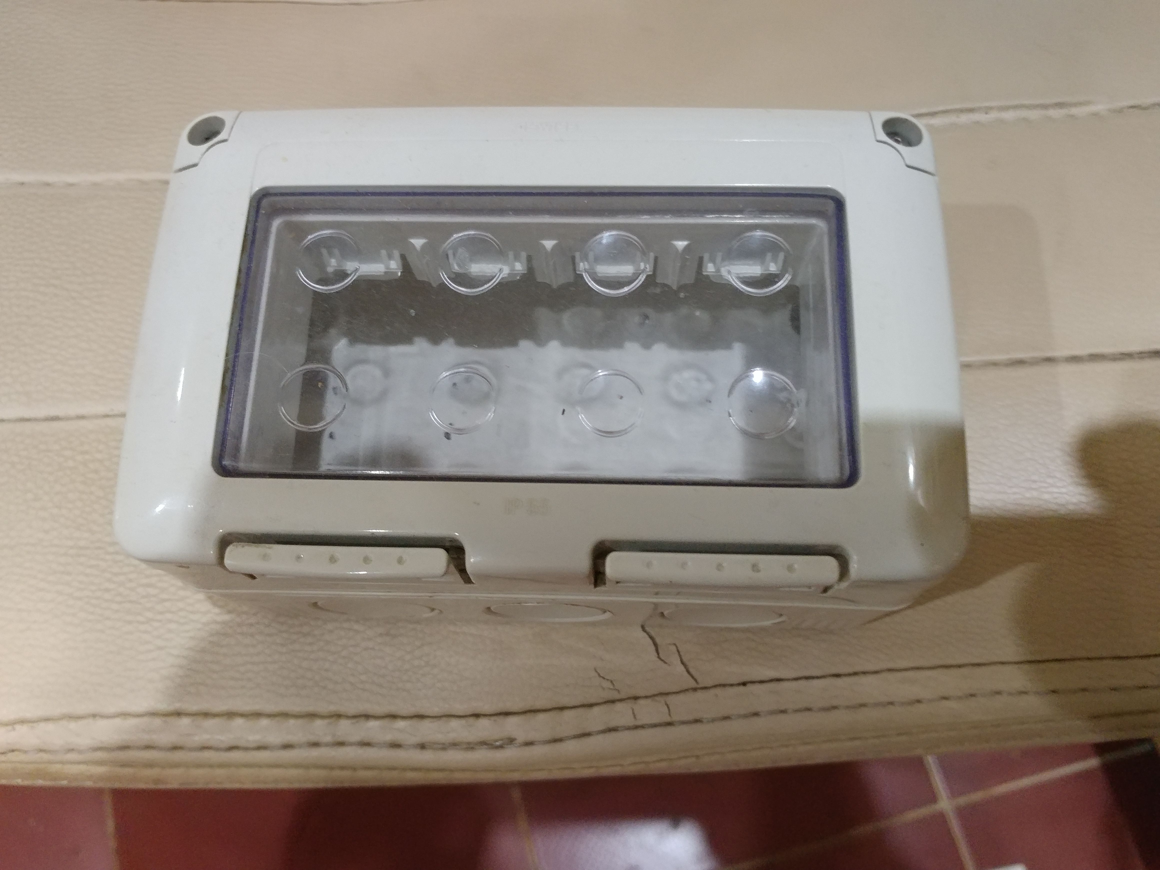

                      @Jalina-He If that question was directed at me - No, it is not new, but 6 years old but as yet unused - You can see the original 4 module tangs still uncut through the clear plastic window.
                      • I bought 2, 3 and 4 module cases at the same time and tried slightly cheaper copies which failed over time (leaked, transparent plastic degraded), the Gewiss originals remain almost as new despite years of exposure to snow, rain and UV - Higher quality.
                        eg - This is the smallest one used, a 2 module unit serving as a wiring junction box between the pump station and the Node, with an ultrasonic sensor control board mounted in the front section for quick swap should it become faulty.20230720_060133.jpg

                          @Jalina-He I'm not sure I understand your question over position of the ultrasonic board - It is mounted forward to enable quick access/replacement via the hinged front access, there is no advantage to pushing it further back.
                          The hinged access door and the two parts of the box have waterproof seals - The clear plastic window allows quick inspection and to see what leds are blinking - The mounting points on the rear box are on the outside of the sealed compartment.
                          If Gewiss is available in your market I can totally recommend these waterproof lightswitch boxes.

                                @Jalina-He Why would I wish to design a product when commercial manufacturers already manufacture them for other functions which can be re-purposed ?
                                I have no vested interest in Gewiss, but I do know from experience that these weatherproof light switch boxes work exceedingly well, which is why I first commented.
                                eg - My Gas meter node has been in such a box for 6 years now with no signs of any damage to any of the unprotected parts within it, or degradation of the plastics over 6 winters and summers - The only interruption to continuous service has been changing batteries or reprogramming the Node.
