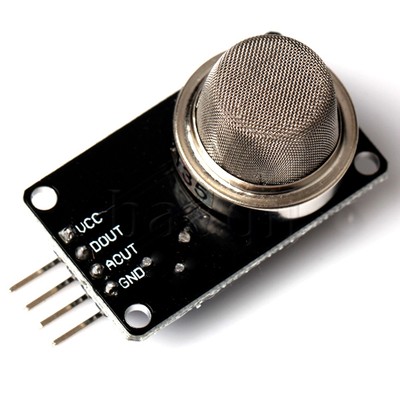

  • @epierre I am testing a stripped-down version of your code from your AirQuality-MQ135.ino. I stripped it to make it run just stand-alone.
    What I don't understand is how to do the calibration. When I run it in outside environment (with 10k resistor), I get these values:
    valr 223
    Vrl / Rs / ratio:13387 / 20875.00 / 0.00
    What would be the next step for calibration?
  • Hero Member
    @supersjimmie replace MQ135_DEFAULTRO by your value 20875 in the sketch
  • @epierre Thanks, I thought it would be something like that, but that didn't work.
    I then got
    valr 242
    Vrl / Rs / ratio:5464 / 8520.00 / 0.00
    Nothing like around 400ppm.

  • Thanks, but when calibrating something strange happens when I put the module outside:
    valr 270
    Vrl   / Rs       / ratio  / ppm
    61355 / 95673.00 / 0.00 / 399.00
    valr 265
    62928 / 98126.00 / 0.00 / 399.00
    valr 260
    64561 / 100673.00 / 0.00 / 399.00
    valr 256
    378 / 589.00 / 0.00 / 399.00
    valr 252
    1773 / 2764.00 / 0.00 / 399.00
    As you can see, the valr decreases slowly, but suddenly Vlr and Rs jump over.
    Vlr is the value of 'val', which is: uint16_t val = ((float)22000*(1023-valr)/valr);
    uint16_t is 16bit, so max 65535. It looks like my environment needs more than that?
    (in fact, your code defines the defaultro as 68550, which is also too much for a uint16?)

  • @epierre I striped-down that AirQuality-Multiple_Gas_Sensor1_4.ino to use only MQ135.
    When used inside, the analogRead is 473, so a reasonble value.
    But the MQCalibration function returns 0. Which means the MQResistanceCalculation also returns 0.
    MQResistenceCalculation only does one calc:
    return (long)((long)(1024 * 1000 * (long)rl_value)/raw_adc-(long)rl_value);
    rl_value = float RL4 = 0.990
    raw_adc = 473 (measured as said above)
    (1024 * 1000 * 0.990) / 473 - 0.990 = 2142.266
    I checked that raw_adc is filled with the correct value (to be sure it is not lost somewhere).
    What looks to fix this, I changed everything to float . So:
    return (float)((float)(1024 .* 1000. * (float)rl_value)/raw_adc-(float)rl_value);
    Which can be simplyfied as:
    return ((1024 * 1000*rl_value)/raw_adc-rl_value);
    I went to float, because the function is created as float MQResistenceCalculation.
    This now gives some ppm values that are within a reasonable range (about 2000 here).
    Now I have to figure out how to do calibration on this method again...

    Thank you. Your mean is Vcc->5V, GND->GND, Dout->Digital pin, Aout->Analog pin. Is it right?
    But I don't know the tcm pin connect with ? I have read datasheet but I don't find any info about tcm pin. Please help me. Thank you so much !!!
    do not use the digital pin !!! it only reacts with the potentiometer in on/off mode, so useless... you need to power the device with Vcc/Gnd, and read the output with Aout (A stands for analog). The last one forget it.

  • For those who are trying to use an MQ135 module from e-bay or other sellers, on a small pcb with a chip, LED and potmeter:
    It took me a while until I figured out that the little chip has a very big influence on the value that you read on the A-out pin.
    Only after removing the connection between the A-out pin and the little chip, I got normal measurements.
    I also replaced the small resistor marked "102" with a 10k resistor, to make measurements more compatible with code that uses a 10k pull down resistor. But that was already a known issue, found on many other places.

  • Can someone tell me how to read this line?
    float mq135_ro = 10000.0;    // this has to be tuned 10K Ohm
    Do I have to messure the sensor and adjust the variable or do I have to tune the resistance? If I have to do the first thing, when do I have to messure it? In warm state and clean air with a multimeter?

  • Hey guys, I am struggeling to get the MQ135 to work. Is there a step by step howto? Or can someone answer my question from 3 days ago?
    I would appreciate it very much.
  • @rollercontainer I followed David Gironi method to calibrate - it is described as follows:
    Before you can use the sensor, it has to be calibrated. For this, connect the sensor to your circuit and leave it powered on for 12-24 h to burn it in. Then put it into outside air, preferably at 20°C/35% rel. hum. (humidity is not so crucial). Read out the calibration value as such
    float rzero = gasSensor.getRZero();
    Wait until the value has somewhat settled (30min-1h). Remember, this is an ADC measurement so you might not want to wait some time between reading the sensor and also do some averaging. Once you have determined your RZero, put it into the MQ135.h. Note: Different sensors will likely have different RZero!
    #define RZERO 76.63
    Congrats, you have calibrated the sensor and can now read the CO2 ppm value in your sketch
    float ppm = gasSensor.getPPM();
  • @alexsh1 Thx
    Is "RZERO" the same as "mq135_ro" or is it a seperate variable? (ro = R0 = RZERO?)
  • So, obvious these are two variables. Wherefore is the mq135_ro? Is it the load resistor from signal to ground?
  • @rollercontainer let's start from the basic - which MQ-135 do you have? A bare unit or with a logic controller and a variable resistor?
  • @alexsh1 I bought a breakout board and desoldered everything but the sensor and the 33Ohm resistor for the heating. Then I soldered a 10kOhm pulldown from analog signal out to ground.
  • @rollercontainer
    Apologies for the confusion. @epierre did not use this library, but I have used MQ135.h library, but have not adopted it for MySensors and I did not like the sensor's reading jumping up and down.
    In MQ135.h:
    // Calibration resistance at atmospheric CO2 level
    #define RZERO 394.5 //RZERO 76.63
    I think the principle of RZERO is the same as mq135_ro
  • @rollercontainer I have do not done any changes to my breakout board. Just tuning the variable resistor and that's it.
    One thing I noticed is that the sensor performs much better in enclosed premises (no windows and no doors). Alternatively, it has to be in the box or something. Any small light draft dramatically changing the readings.
  • @alexsh1 I dont think so, in epierres sketch both values appear:
    https://github.com/empierre/arduino/blob/master/AirQuality-MQ135.ino#L25
    https://github.com/empierre/arduino/blob/master/AirQuality-MQ135.ino#L33
    So, what the heck is mq135_ro? And what to tune to?

    Can you please elaborate on how to calibrate the sensor?
    Also how do you connect it if it comes on the board like this?
    http://i.ebayimg.com/00/s/NjAwWDYwMA==/z/vMIAAOxycD9TTOVW/$_1.JPG
  • Hero Member
    easy here, the AOUT is the one you will put on an analog one.
    the DOUT (Digital OUT) is just an alarm linked to a level you could change on the board)
    So DOUT is not used. Just AOUT?
  • Hero Member
    @alexsh1 said:
    yes !
