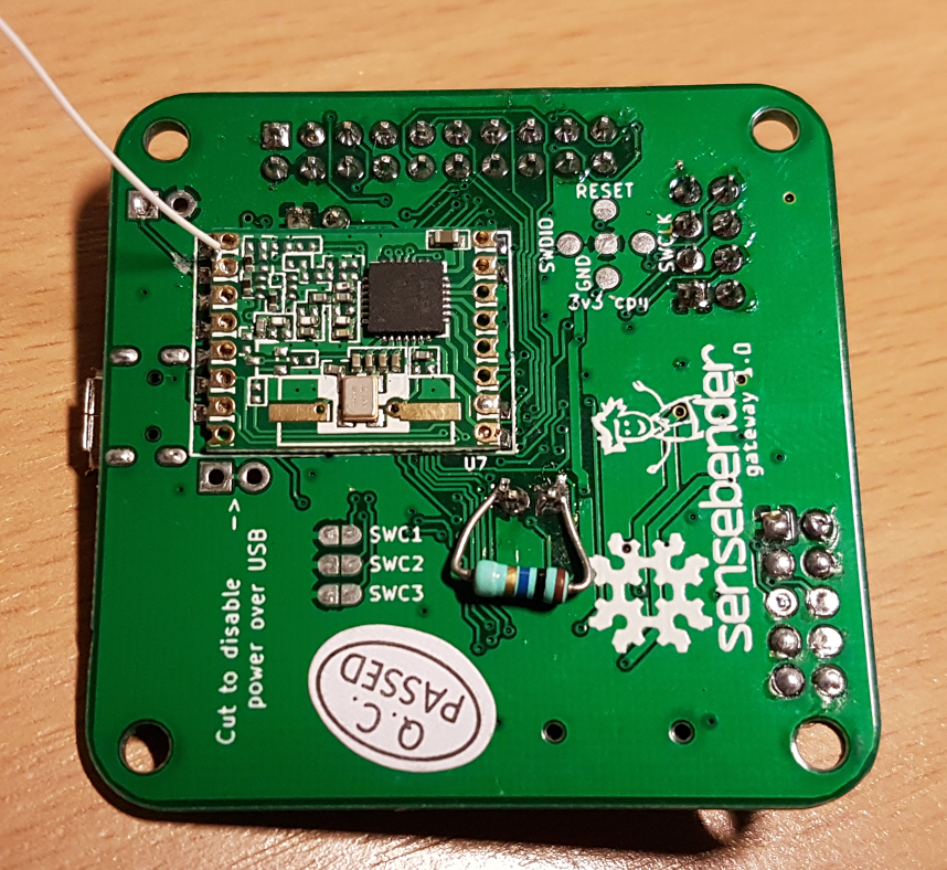

          On a related note, if anyone is trying to get the NRF2RFM69 board or similar working with the awesome Sensebender Gateway and W5100 Ethernet board, here’s what I had to do today as far as the CS and IRQ defines are concerned.
          [FYI: I’m coming back to MySensors after a long hiatus and am in the process of updating (some from v1.3!) all my gateways and sensors...]
          Aside from the usual radio selection, I had use the new driver and point the RFM69 NSS and IRQ pins at the nRF CS and IRQ nets. Also, if you want to, you can point the RFM69 RESET pin at the nRF CE net:
          #define MY_RFM69_NEW_DRIVER
          #define MY_RF69_RESET 34  // Note: Should be MY_RFM69_RST_PIN, but this didn’t work.
          #define MY_RFM69_IRQ_PIN 31
          #define MY_RFM69_IRQ_NUM digitalPinToInterrupt(MY_RFM69_IRQ_PIN)
          #define MY_RFM69_CS_PIN 29
          #define MY_DEBUG_VERBOSE_RFM69  // Note: Only if you want to check the pins, RSSI, etc.

            @acb
            You do know that there is solder pads for RFM69HW on the back of the gateway, right? And the board defs for the gateway are configured to use those pins for the RFM69 by default.

              #109
              Adding image for reference

                  #111
                  Yes @tbowmo, I saw the solder pads on the back - although thanks for the reminder (and image @mfalkvidd)!
                  I’m not using those (yet) since I didn’t want to “permanently” attach one of my “precious” RFM69HWs to it whilst I’m tinkering with all these lovely new radios you now support. RFM95 next I hope, after checking out the FOTA and signing! You guys have really done great work!
                  I also wanted to range-test with a few different externally mounted antennas I had lying around and so I combined pads for a surface mount U.fl and edge SMA on my own NRF2RFM69.
                  Not a great deal of room around the SBGW’s pin breakout (P1) for a helical - although I really respect the design choices - so I figure I’ll probably breakout those pins to pigtail an SMA.
