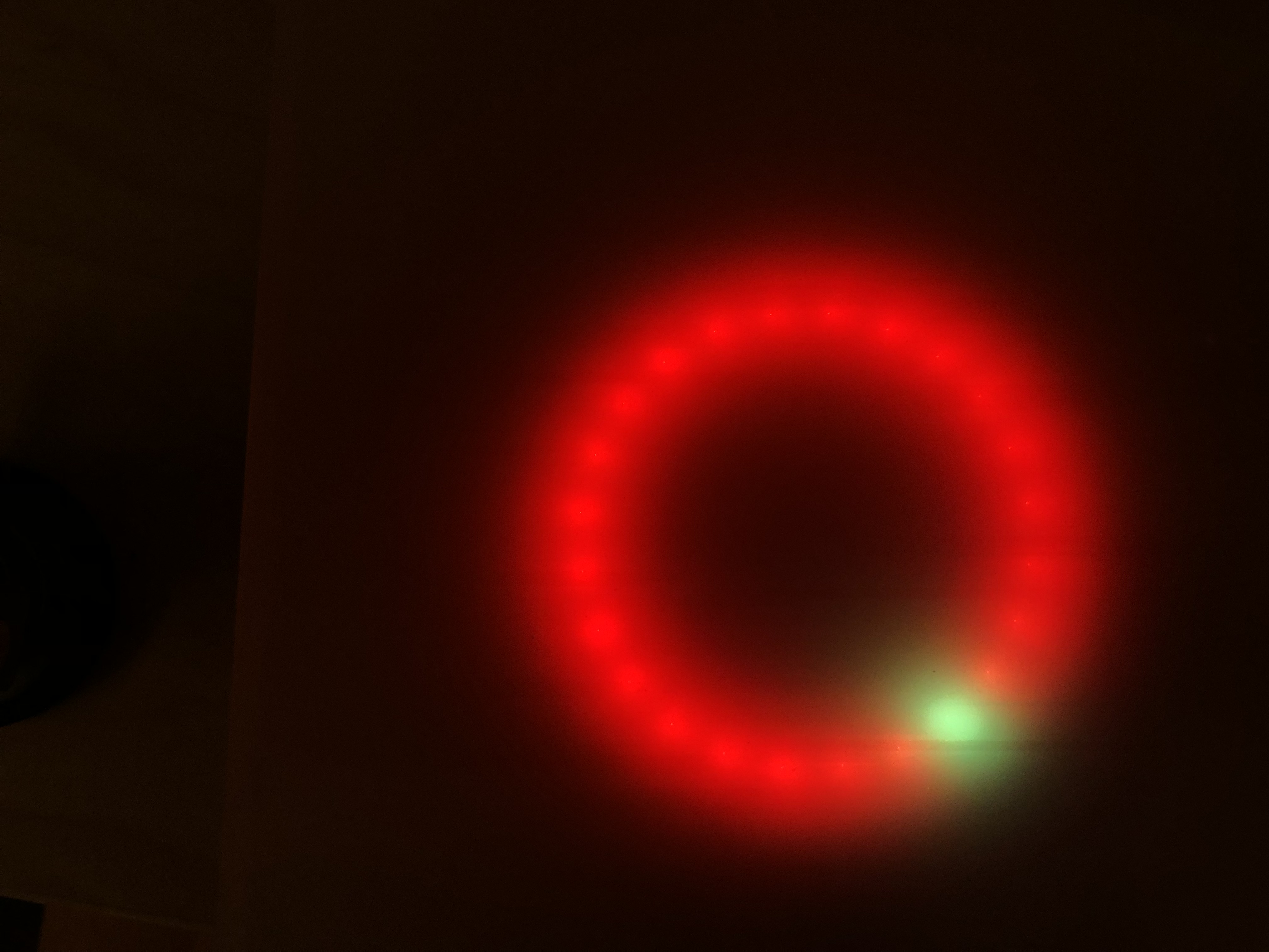

                    • mfalkviddM Offline
                      This is what it looks like with a diffuser
