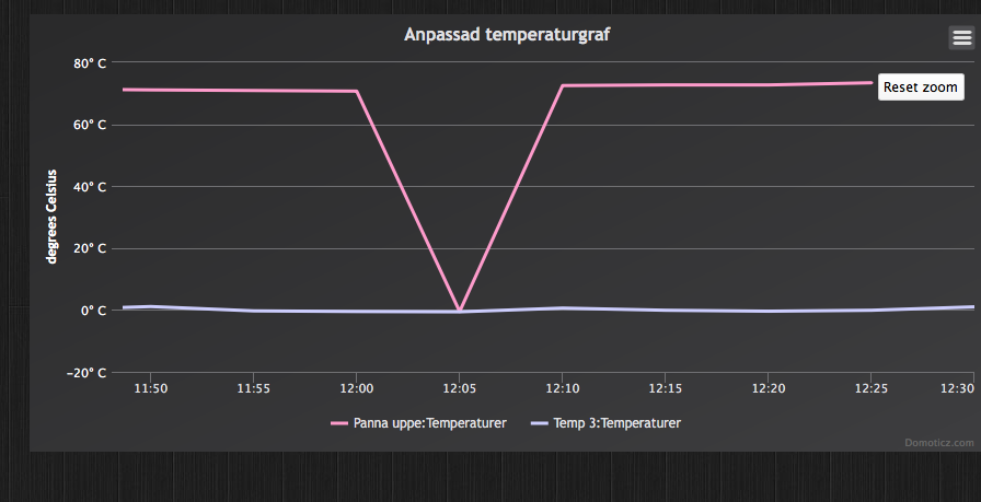

    I have now tried the stored ID "version and it works much better than the previous.
    I still get the wrong values sometimes. Wonder if there is control domoticz which mixes the ID.
  • @tomasandersson I really doubt the controller to mix things up, nor the node doing so.
    What are the absolute values of the measured temperatures? The "faulty" values seem to be more or less identical, so this could indicate powering problems or may be related to cabeling or resistor size. Did you stick to the 30 seconds intervall or something else?
    Normally 750ms for conversion should be enought, but official (according to datasheet) seem to be a little longer, so trying to change line 69 may help: conversionTime = 1000 / (1 << (12 - resolution));).

    Here is a picture where you see that the sensor ID picks temperature of another sensor0_1490096020397_Skärmavbild 2017-03-21 kl. 12.31.12.png
  • @tomasandersson This really looks strange.
    Some additional remarks:
    • Some values represent also failure codes, beside -127°, 85° (C), which are already filtered out by code I also suspect 0° to be one of these. This is the backgound of me asking above for absolute figures.
    • There seem to be also fake chips on the market; they may have slightly different operation conditions esp. wrt. to timing (if they work at all; I don't have own experience on this).
    • How are your cabeling conditions? I had some troubles when using nRF+PA+LNA modules together with the new (post 2.0.1-) MySensors-libs and more than 5 DS18B20 on one line (non-parasitic mode). This seems to be solved by the use of a small delay between temp-sends (wait(50) or so). With a lot of sensors and long lines and/or star topology, you may have to lower the pullup resistor value (e.g. 3.3k).

  • @rejoe2
    Now I have tried both of the programs. It works much the same. It pops up a fault sometimes.
    Is it difficult to enter a line in the program, says that if the temperature has changed system than - + 5 degrees so it shall not be reported
  • @tomasandersson To me, this really seems to be hardware related, so triple check your wirings first.
    If you really believe this to be a software problem, you may add an additional condition in line 119 with another "&&", (from memory something like abs(lastTemperature[i] - temperature < 5). I would have to test it myself and don't find this reasonable (s.o.), so feel free to finish this part of the job yourself.

    I do not think there is anything wrong with the hardware because I have two identical sets. One to a spa and a heat pump. Maybe I'll try it with less resistance. Now i have 4.8kohm
    I'm now trying with more or less distinction from the former transient temp.
    I will reply when I got it to work.
    Tomas
  • @tomasandersson Just 2 DS18B20 on each line should never cause trouble wrt current draw using a 4.8k resistor and 30 sec. intervals and no additional sensors drawing current from the arduino. If not already in place I would anyhow recommend using 3 wires for operation instead of parasitic mode.
    Anyhow: Best way to identify these chips is using the addresses. Most likely you now are also prepared to do some small editing in sketches?
    "My" array-sketch-version also prints the ID's as array information you need to serial. You may test it and then disable this feature once you have the info for both of your sketches (begin the respecting line with the #define with a "//"). Doing so will definitely eliminate any smallest risk of mixing data...
