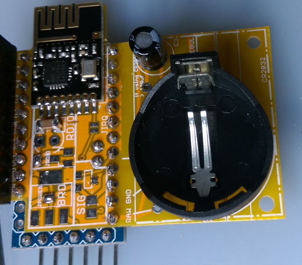

  • Hey @Nca78 I received the boards and components (yay!)
    But... I connected three modules, and none of them works 😞
    They all have transport (radio?) fail like
    32 TSM:INIT
    49 TSF:WUR:MS=0
    81 !TSM:INIT:TSP FAIL
    98 TSM:FAIL:CNT=1
    114 TSM:FAIL:PDT
    I tried connecting radios from two different batches, I tried connecting only the radio and arduino, I tried powering it from separate powersupply and only debug via serial. I tried provided sketch and also tried dummy sketch from the examples. I tried using the CR battery, node works fine except that the radio doesn't start communicating.
    I do measure 3V on the radio pins. I tried with and without radio cap.
    I am using chinese silicon mat to solder components on, I read somewhere that you use something similar *(not that I am spying on you 🙂 ) but could it be that I am frying all the radios with static electricity?
    I have used the mat before and it works fine with regular radios, nothing fried so far, but there is something preventing nodes from working 😞
    Do you have any suggestions on how I can debug them and see what seems to be the problem?
  • Hardware Contributor
    Hello, @dakipro, can you show a picture of one of the board ?
    Did you short the jumpers (JPOWER and JRDIO) if you're not using any regulators ?
    Yes I use a cheap silicon mat because it's so convenient, and I never had any problems with it all my radio worked.
  • Hero Member
    @dakipro
    I get the impression that not all radio modules use the same pinouts. You may want to confirm that yours are the same as @Nca78's in that regard.
    @NeverDie is right. Some modules like those from CDEByte are different from the classic SMD modules from AliExpress and must be soldered on the "pa/lna" pinout (the one closest to the edge of the board).
  • Hero Member
    Looks as though the PA/LNA part of the silkscreen warning got largely obliterated by the solder pads.
  • Must I have a radio cap?
    I connected the jumpers now quickly for a test (missed the part that I need them), but still same error
    49 TSF:WUR:MS=0
    98 TSM:FAIL:CNT=1
    114 TSM:FAIL:PDT
    10158 TSM:FAIL:RE-INIT
    10174 TSM:INIT
    10207 !TSM:INIT:TSP FAIL
    10240 TSM:FAIL:CNT=2
    10256 TSM:FAIL:PDT
    Here is the photo of the board (a bit blurry, I can take it again if it helps)
    I am missing the radio cap as I was testing lest night without them, but I can solder them in a few hours and test again if you think it will help.
    I connect power to the vcc pin of the "connection pins" right?
    Radio is the one linked in the BOM from aliexpress
  • I put the radio cap back (4.7uf the largest I have in smd), but still same error 😞

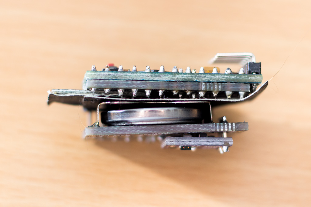

  • Hero Member
    @dakipro
    Your photo seems to show some hair-like filaments. Don't know if they're conductive, but, if so, maybe they're bridging some of your solder pads? Have you checked with a continuity meter?
  • checked between the pins, no radio pins are touching each other. Those hairs er most likely from the cat, got them cleaned after the photo.
    I will try to make one more module in a few days and test.

  • IT WORKS!! Life is worth living again...
    I've assembled now fourth module and it works, only different thing I did is that I have soldered the radio and power jumpers before connecting the module together. It could be that without jumpers essential component of all electronics (white smoke) gets out of the radio, not sure what happened. But it works!
    I was struggling a bit to figure out all components needed and all the steps, it might be helpful to have a "short guide", this is for my own reference of what I did in order to get CR2032 module for using with TempHumDoor shield:
    Components needed [nModule]: pro mini, radio, nmodule board, 1 capacitor for radio larger then 4.7uf (I har only 10uf, I have ordered 47uf for future modules).
    Assembling process
    • Burn 1mhz bootloader on pro mini
    • solder two jumpers for jpower and jrdio
    • solder the radio to the board
    • Control that there is no connection between the radio pins, resistance is at least above 200Kohm (don't skip this part thinking it cannot happen to you, it will happen)
    • Solder >4.7uf (f.eks. 10ud) smd.
    • Solder all legs to arduino (except last two RXI and TX0, you will see them missing when you align nModule)
    • Take off the plastic from the legs, before you solder it to the radio (do this BEFORE you solder it to the board)
    • Solder arduino to nModule board
    • Since the capacitor is very small, just check if there is no short between plus and minus (vcc and gnd) pins, as somehow I managed to short them on one module, it turned out that one of the caps was shorting it, probably by overhitting or something.
    Upload mockMySensors sketch and check that node works properly (spare yourself a trouble, no point continuing further if this doesn't work) By this point you should have node looking like (better then) this:
    TempHumidityLightDoor shield components: SMD SI7021 for temperature and humidity and a MAX44009 for light, two capacitors larger then 100uf (I used two of 100uf, waiting for 220 to come). And the work so far.
    You basically solder these three/four components and the battery holder as described on the shield here https://www.openhardware.io/view/398/NModule-Temperature-Humidity-Light-Door-sensor-shield
    I didn't yet solder LEDs, but they are accessible after assembling the module.
    Then it looks like this:
    Now that nModule #1 is completed, you continue with other modules

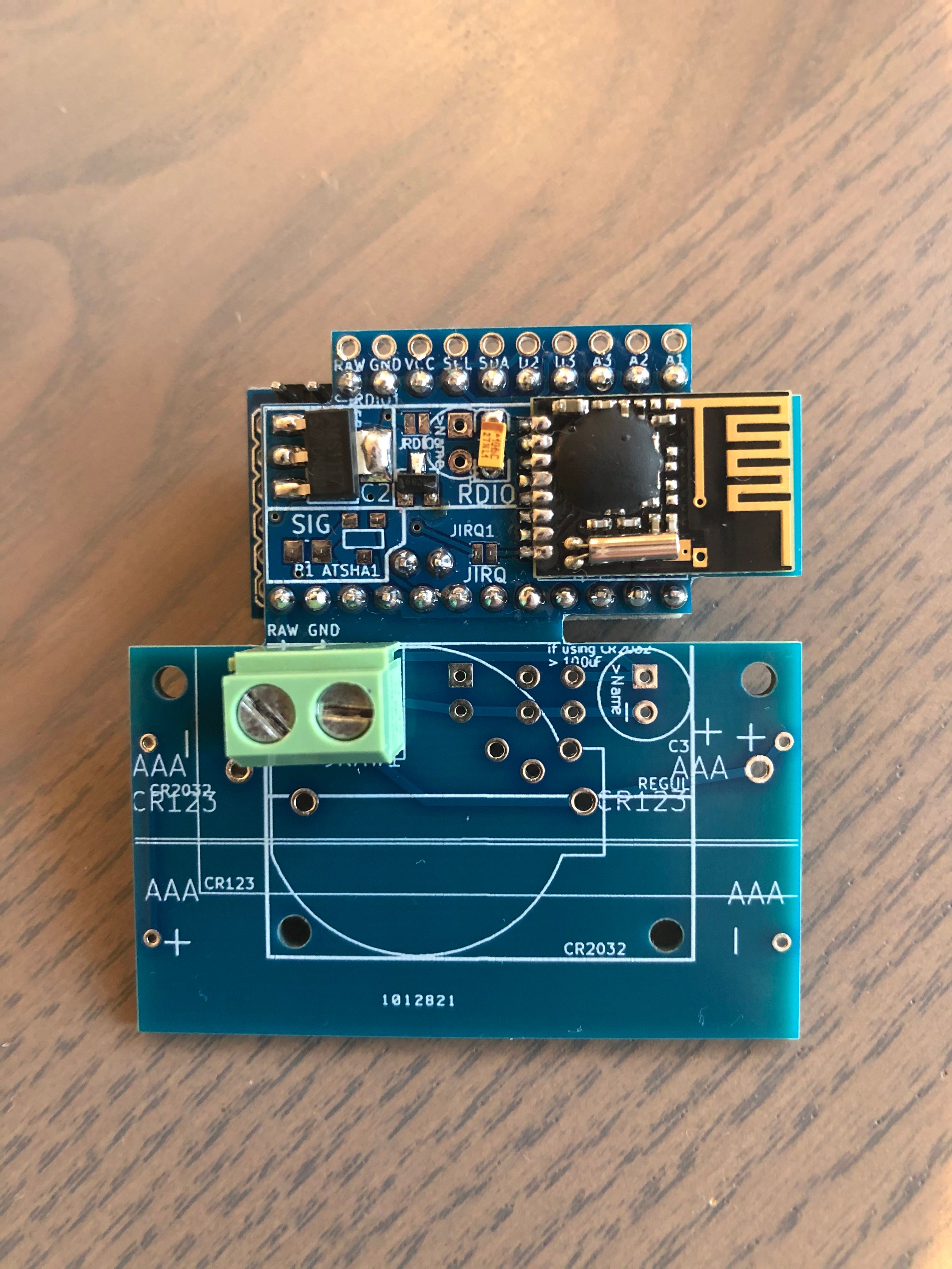

  • @Nca78 Hi, looks like I am doing something wrong in my last attempts to use your design with 12v external power supply.
    I am using:
    • Arduino 5v, 16hz
    • AMS 1117 5.0V
    • 662K XC6206 - 5v to 3.3v voltage regulator for radio
    • 10UF-16V CAP for radio
    • NRF24L01SMD
    As you can see on a picture, I am using a terminal block where i push 12v.
    When I connect the power to the terminal, my Voltage regulator get veeery hot and nothing works.
    When I connected my FTDI to try to upload a sketch, a capacitor on arduino got fried. You can see it in the next pic.
    This happened on tree of my boards.
    Can you please take a look and try to see where the problem might be?
    Thanks alot!

  • @Nca78 Thanks for the quick reply.
    I hope you will be able to see the images now:
    https://imgur.com/oRBrXDu
    https://imgur.com/2Dexy8Z
    What jumpers are you referring to?
    @zmatokan said in 💬 NModule:
    JPOWER and JRDIO, they should be unsoldered if you are using regulators.
    I see JRDIO is not soldered, I can't see JPOWER as it's below the AMS1117, but I supposed you didn't solder it.
    Components seem ok, can you explain the problem ? Do you have 5V at the output of the AMS117 and 3.3V at the output of the XC6206 ?
    [edit] those "blob" modules are usually of very poor quality, so if you have the right voltages but can't make a radio connection, they might be the reason...
  • @Nca78 I didn't soldier JPOWER either.
    Problem is that when I connect 12v to terminal block, my voltage regulator gets very hot and arduino is just showing red led ad not responding to reset.
    If I try to connect FTDI cable to upload a sketch, I got my CAP on arduino fried as you can see in the image.
    If I try the same thing on simple nmodule (without battery part), it works when I push 12v to RAW and GND.
    Maybe the battery pcb part is making problems? Should I soldier C4...C9 on the back of the nmodule pcb?
    @zmatokan sorry I complained about your missing pictures and didn't notice you had explained the problem in your initial message.
    A very hot regulator sounds like a short circuit on it's output. Is the red led on at full level or dimmed ? Can you confirm which regulator is getting very hot ?
    Burnt tantalum capacitor is either voltage higher than rated voltage or reverse polarity. This capacitor is I think connected between RAW and GND, so I don't see how this could happen, did you have 12V on terminal block when you connected the FTDI ?
    For the source of the short circuit (can you check resistance between VCC and GND, and radio VCC and GND ? Not a good idea to do that usually but it will easily confirm the problem here) I have no idea. I don't think it comes from the "power/battery" part of the board, it's pretty basic and it would short RAW not VCC. You could have a problem with radio footprint (but if it's the same module on the non 12V powered board, it's not the reason), or a short between some via on the radio module with the second radio footprint that is below it (red color on picture below)
    You should have at least one capacitor for each couple of footprint for input (C6/C7) and output (C8/C9) of the AMS1117. It's not what is causing the problem now, but it will make the power more stable.
