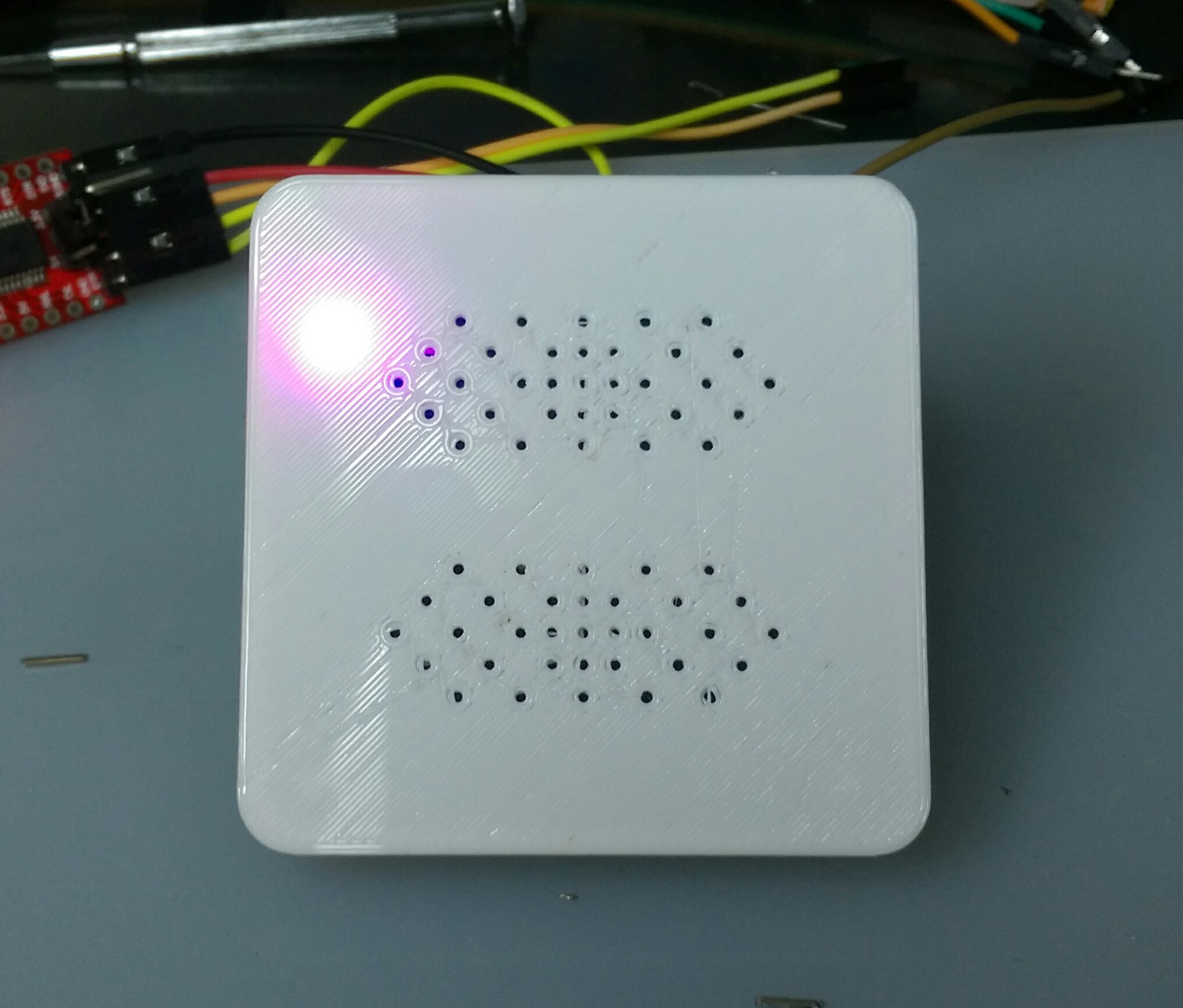

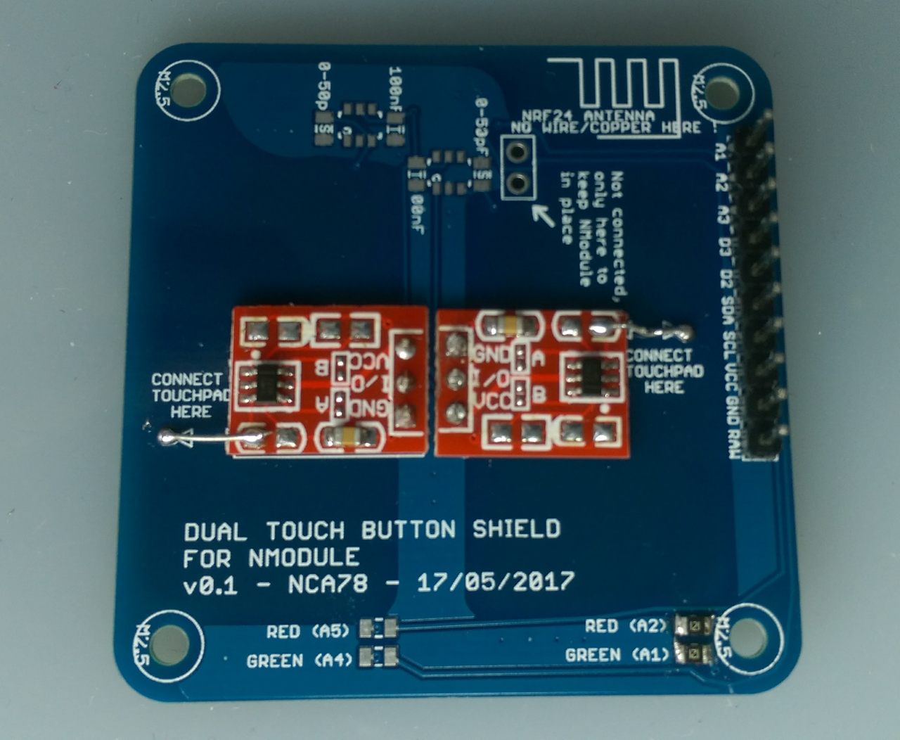

          I just soldered a version the easy way using the TTP223 ultra cheap breakout boards and I'm really happy with the result, finger is detected around 5mm away from the front plate so it's going to be perfect with a 3D printed box that I'm going to do right now :D
          With NModule using CR2032 it takes a 551.9cm volume so should fit in a 545424mm box, a bit thinner if using SMD version of TTP223.
          At the moment it's only made for SMD LEDs but as it's working so well with the breakout boards if there is some interest I can make a revision with a central bicolor (red/green) through hole led.

                Made a first print but setting for this filament are clearly wrong as the print quality sucks :(
