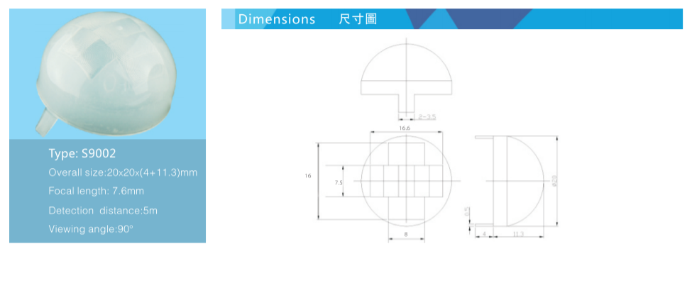

      Would you please provide a link to the PIR lens that you're using?

        @NeverDie No problem :)
        http://en.nysenba.com/index.php/page-7-26.html - summary.

          Where do you buy them from?

            @NeverDie I bought this lens in the radio shop next street :) It is very difficult to buy something in my country so I hope it will be not so hard to find such lens in China.

                  OK, thanks for the answer. If anyone reading this finds it, please post where you found it.

                    @NeverDie why are you asking? Does this lens seem better than the one you are currently working with?

                      Just scoping out alternatives in case it's ever needed.

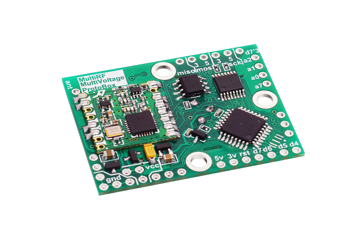

                        I am not sure this board is useful, but it works properly :wink:

                          This board fits the box good :wink:
                          NeverDieN 1 Reply Last reply
                            may I ask how did you solder all the small SMD parts?

                              Nice work! It looks like a commercial product.
                              What about the antenna?

                                And which battery? Small 250 mAh Li-ion? ;)

                                  Maybe this could fit
                                  https://www.aliexpress.com/item/10Pcs-433MHz-Helical-Antenna-2-5dBi-32mm-for-Remote-Contorl/32608690665.html

                                    Thanks a lot for your high appraisal of this device. I designed this board just for fun but now I really like it with this enclosure. I would plan to improove this board a little (omit unnecessary functions and add useful features) and to start production of this device.
                                    @NeverDie said in 💬 MultiRF MultiVoltage ProtoBox:

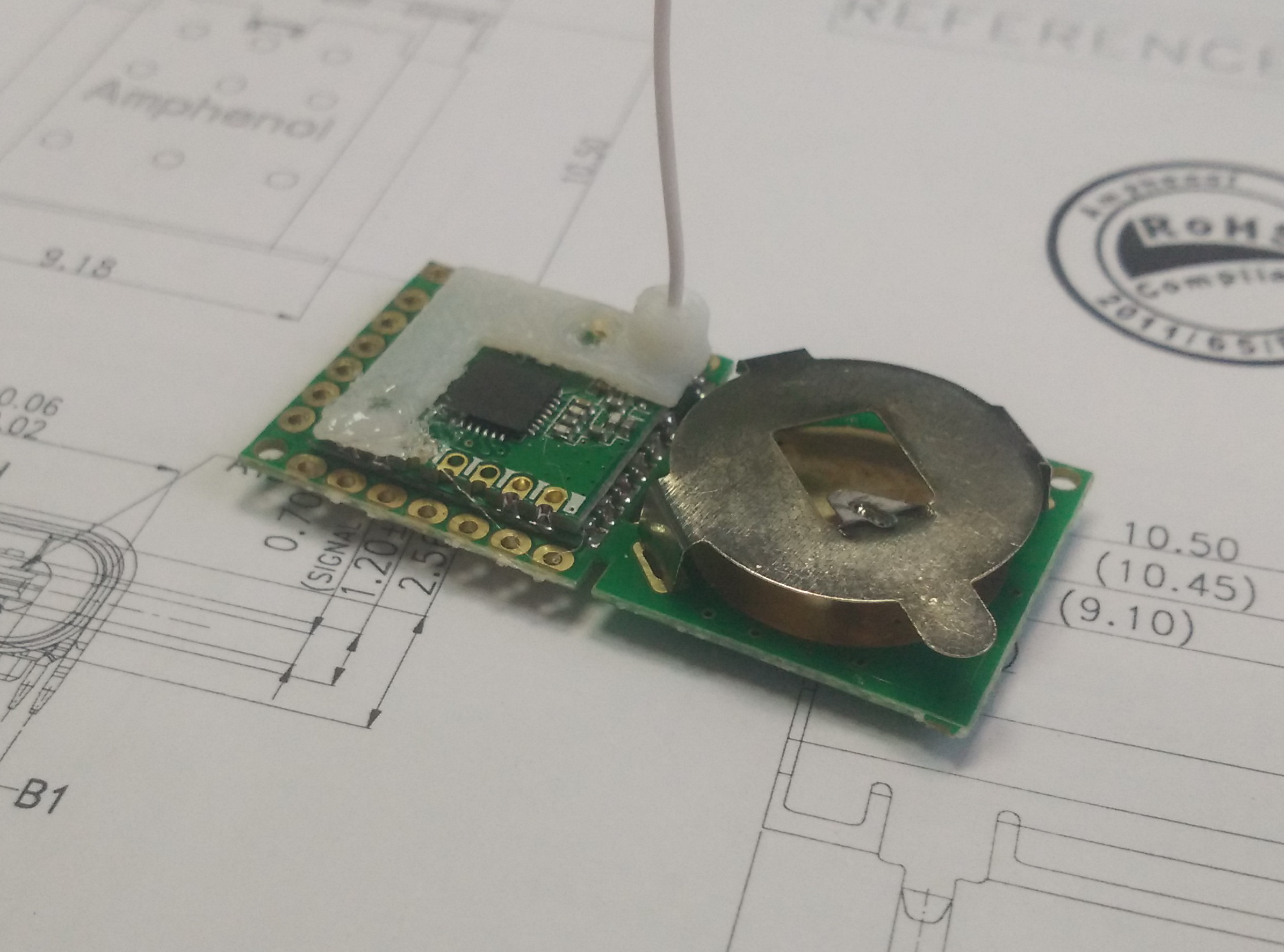

                                    I use very simple solution for all my boards. I just solder wire and fix it with glue pen to the board to improve reliability. Not very ideal for 433MHz board (~20cm) but perfect for 868MHz (~10cm). By the way I tested different modules with Yury (433/866). we found 868Mhz optimal frequency. Excellent range (up to 10x compareble to NRF) and very good feedthrough. So may be it is the most optimal rf solution.
                                    @MiKa said in 💬 MultiRF MultiVoltage ProtoBox:
                                    May be. With usb and onboard charger of course :wink:
                                    @gohan said in 💬 MultiRF MultiVoltage ProtoBox:
                                    I soldered all of my prototypes by hand. I use simple soldering gun and flux. All boards batches are assembled on the factory of course (manually or automatic, depends on the batch size).
                                    I really do not recommend to use springs like this. It is not antenna it is... mechanical spring. I tried to use many of them and all of them are much worse compareble with single wire antenna. It has very bad characteristic. :-1: I verified it in modeling software and in real life.

                                      Do you have a photo of this?

                                        @NeverDie I will make a photo on Monday.

                                          @NeverDie Sorry for delay... This is example (improved version with 3d printed fixer)
