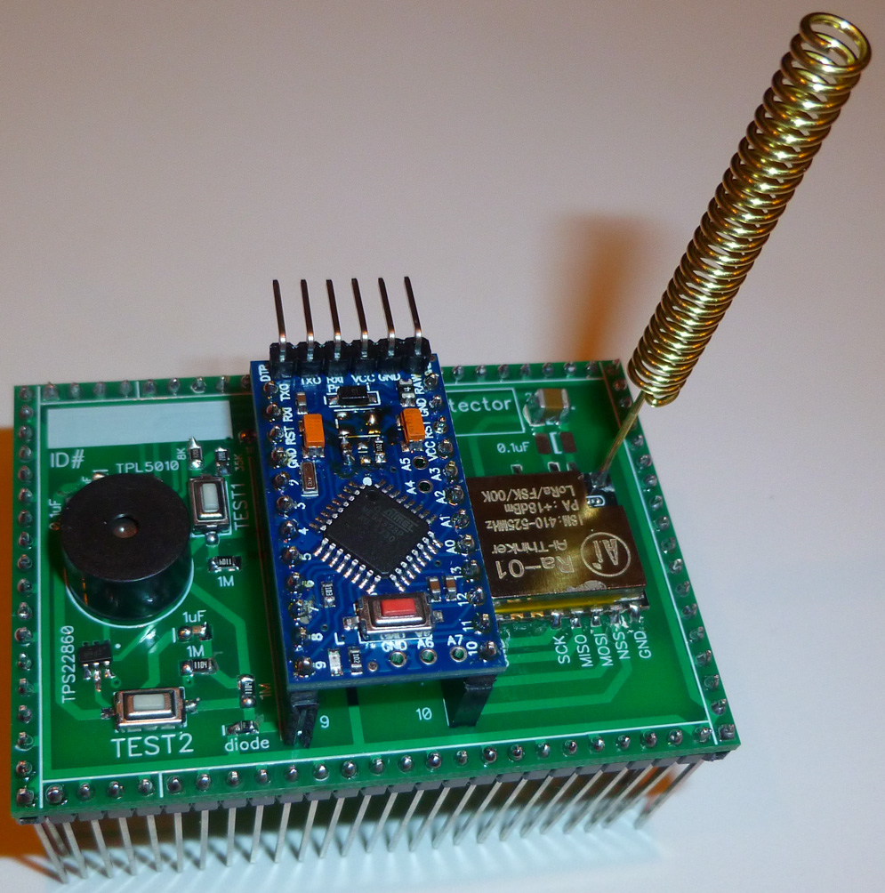

          I just now uploaded Version 4. I decided to keep it simple, so this will (hopefully) be the final version. :)
          • NeverDieN
            NeverDieN
            I just now uploaded Version 6. I changed the board layout to avoid some physical clearance problems that manifested in the Version 4 board, and I added a test button and a buzzer. I also increased the size of the pads for the battery holders so that the soldered connections should now have greater mechanical strength.

                I received the version 6 board today and assembled it. It is completely free of the clearance issues that were quite noticeable in the previous version.

                      I just now uploaded Version 7.
                      What changed: I rotated the buzzer 90 degrees to provide much better clearance between the pass-through of the buzzer leads and the batteries.

                        I just now uploaded a schematic. I've made a few upgrades to the project, which are shown in the schematic but not yet reflected in the gerber files:
                        1. Uses a TPL5010 as an external watchdog timer. This chip consumes just 35na, so it is far more energy efficient than the atmega328p's built-in watchdog timer. Also, it will reset the pro mini if the pro mini ever becomes unresponsive.
                        2. Uses a TPS22860 to drive the buzzer. I've done some experiments, and the buzzer is louder if driven by a load switch than if the buzzer is driven by just a pin on the pro mini.
                        These changes should make the project both reliable and "bullet proof".

                              I just now uploaded version 14. Changes: added a 100K pullup resistor and a 0.1uF bypass capacitor, both used by the TPL5010.

                                          Hardware works. Project completed. Insert your favorite brand of radio code, and you'll be good to go.
                                          I uploaded version 11 of the TPL5010 test code. The way it works is this:
                                          1. If you simply add the batteries, the unit will boot (giving two beeps when it does), and then it will wake up every 5 minutes after that. However, no LED will light, except during the initial boot.
                                          2. So, to speed up the testing, hold down the "TEST1" button prior to (and during) inserting the batteries. Then release. This will wake up the pro mini every few seconds. However, the LED's still won't light to indicate each wakeup.
                                          3. So, after step #2, press the "TEST2" button once. This will then flash the LED every time the pro mini wakes up. This confirms that the TPL5010 is correctly waking up the pro mini.
                                          4. To confirm that the TPL5010 will reboot the pro mini if the pro mini becomes unresponsive, press the "TEST2" button again. This will put the pro mini into a tight infinite loop, making it unresponsive. Within a few seconds, the TPL5010 will reboot the pro mini.
