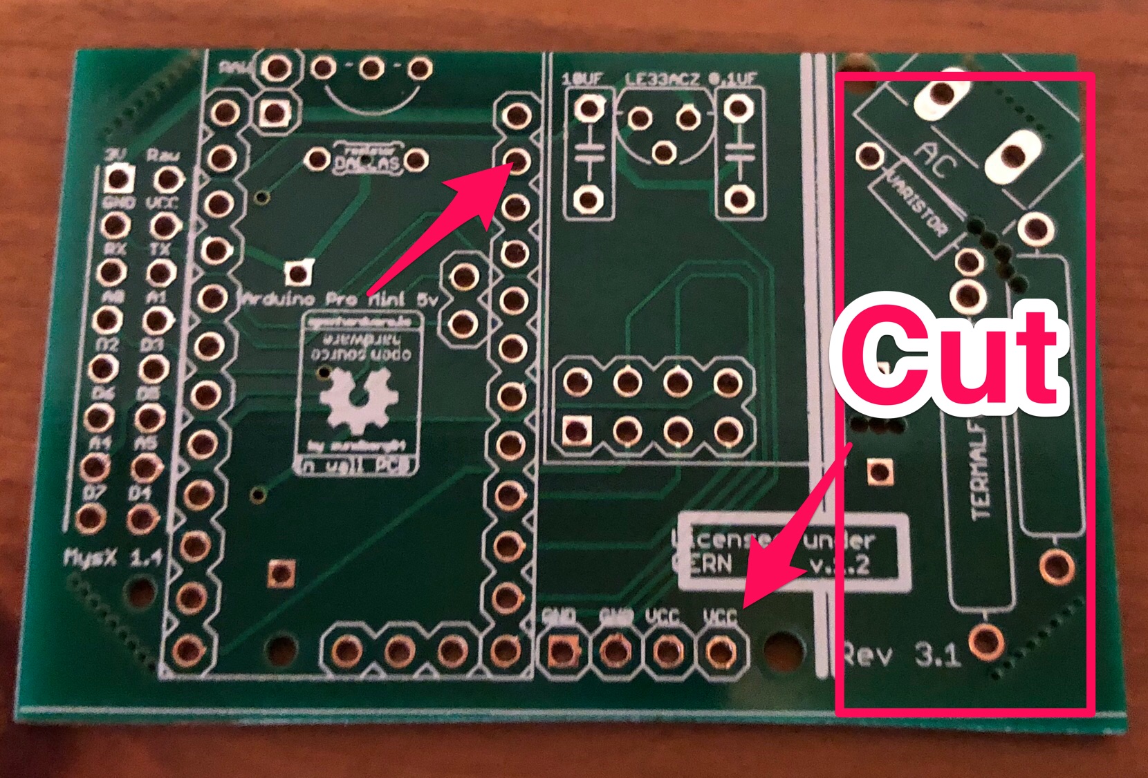

            • T
              T
              The-Holgi
              wrote on last edited by The-Holgi
              #58
              i´have purchased the in wall pcb rev.3.1.
              Now i´m want to cut up the right part of the pcb and powering the pcb with 5V power adapter.
              Why is the VCC pin (lower arrow) with the arduino GND pin (upper arrow) connectet?
              The GND pin lower side is connectet to arduino VCC pin, is that a mistake?
              I´m think the print vcc and ground are reversed.
              • T The-Holgi
                sundberg84S
                sundberg84S
                #59
                @the-holgi Hi - hmm, this is an old revision and there might be misstakes as you describe. The current version is 4.1. Im traveling with work and dont have the documentation with me - but it should be quite easy to figure out if vcc and gnd are reversed by probing it with a multimeter. This PCB was not made to cut like this, but it might work - you have to try.
