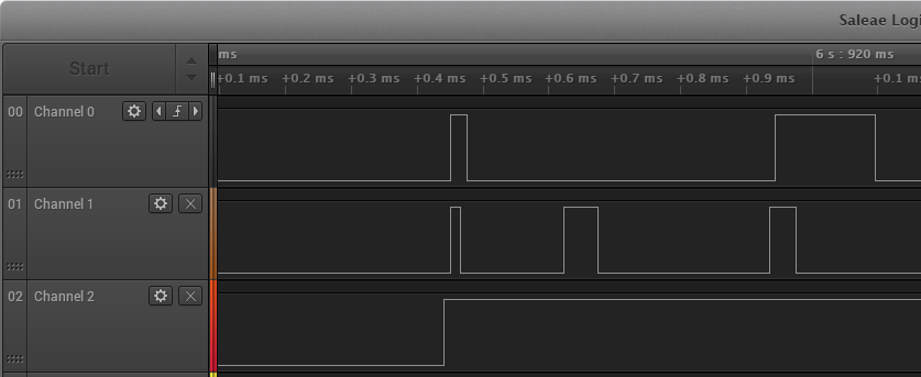

Nearly finished, I'll try to see tomorrow how the 2 boards discuss, then connect necessary digital pins and put back extra leds with the pins I have left.
Unfortunately it's not that easy to understand. After double checking I realized they connected TX to TX and RX to RX so it's not serial communication.
I'm trying to check with logic analyser but I'm not very talented with that

@tonnerre33 but they are connected to the PIC MCU on the main PCB, that would make no sense if those pins were used with the radio ?
And I have synchronized signals on the 3 pin too (TX, RX and RB4 pin). The TX and RX pins are obviously those used for communication as the signal on those pin always follow a level change on RB4 pin.

@tonnerre33 sure, here you are.
Pins I'm checking with the logic analyser are connected to the PIC using the R1, R3, R4 200 Ohms resistors (top right of the PIC) they are the only ones I see connected to the PIC.
So maybe I will need help/advice from someone who has a bit of knowledge about this kind of data exchange between 2 processors, to see if it rings a bell for them... @scalz maybe (sorry to bother you :))
Channel 2 is connected to RA4 (touch PCB PIC) and RB4 (main PCB PIC). It's obviously a clock signal, at 25Hz, 50% duty cycle. Each edge (raising and falling) generates pulses on the 2 other pins.
Channel 0 is connected to pin RB7/TX/CK.
Channel 1 is connected to pin RB5/AN11/RX/DT
What I see is this base signal, with some pulse that are always repeated every 20ms:- edge on C2 triggers pulses on C0 and C1 (both at the same time) with a 12us delay. I call them "start" pulses later.
- C1 pulse lasts 16us, it's falling edge triggers a falling edge on C0 with 10us delay
- after 260us there is another pulse on C1, triggering another pulse on C0 with a 10us delay. I call them "end" pulses later.
- C1 pulse last 40us, C0 pulse 152us
- duration between start and end pulses is always the same (468us)
Adding to that base signal, I have some "extra" pulses that appear between the start/end pulses, in 3 different
- pulse on C1 208us after start pulse ,
- pulse on C1 208us after start pulse, followed 10us later by another pulse on C0 with 10us delay
- pulso on C1 156us after start pulse, no pulse on C1. I've seen this case only once. Signal repeated 7 times then
I have not seen the case where a pulse on C1 happens after a pulse on C0, but maybe it happened and I just missed it as it's pretty hard to search in the logic software for this case ...
As the pulses always have the same duration, my stupid guess is middle pulse between start end end pulse = 1, no middle pulse = 0. Plausible ? Not ? Anything specific I should check ?
Any suggestion is welcome
