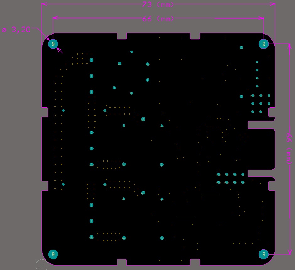

      Is there any chance we could see the .brd file or at least give us some sort of dimensions for the physical product here.
      Thanks :)

      • S Samuel235
        Thanks :)
        kalinaK Offline
        kalinaK Offline
        kalina
        wrote on last edited by kalina
        @Samuel235 said in 💬 MDMSNode "Power":
        Thanks :)
        This is pcb size picture:
        And this is enclosure link.
        • S Offline
          Samuel235
          wrote on last edited by Samuel235
          Awesome, might be beneficial to add to the openhardware description too.
          Thanks.

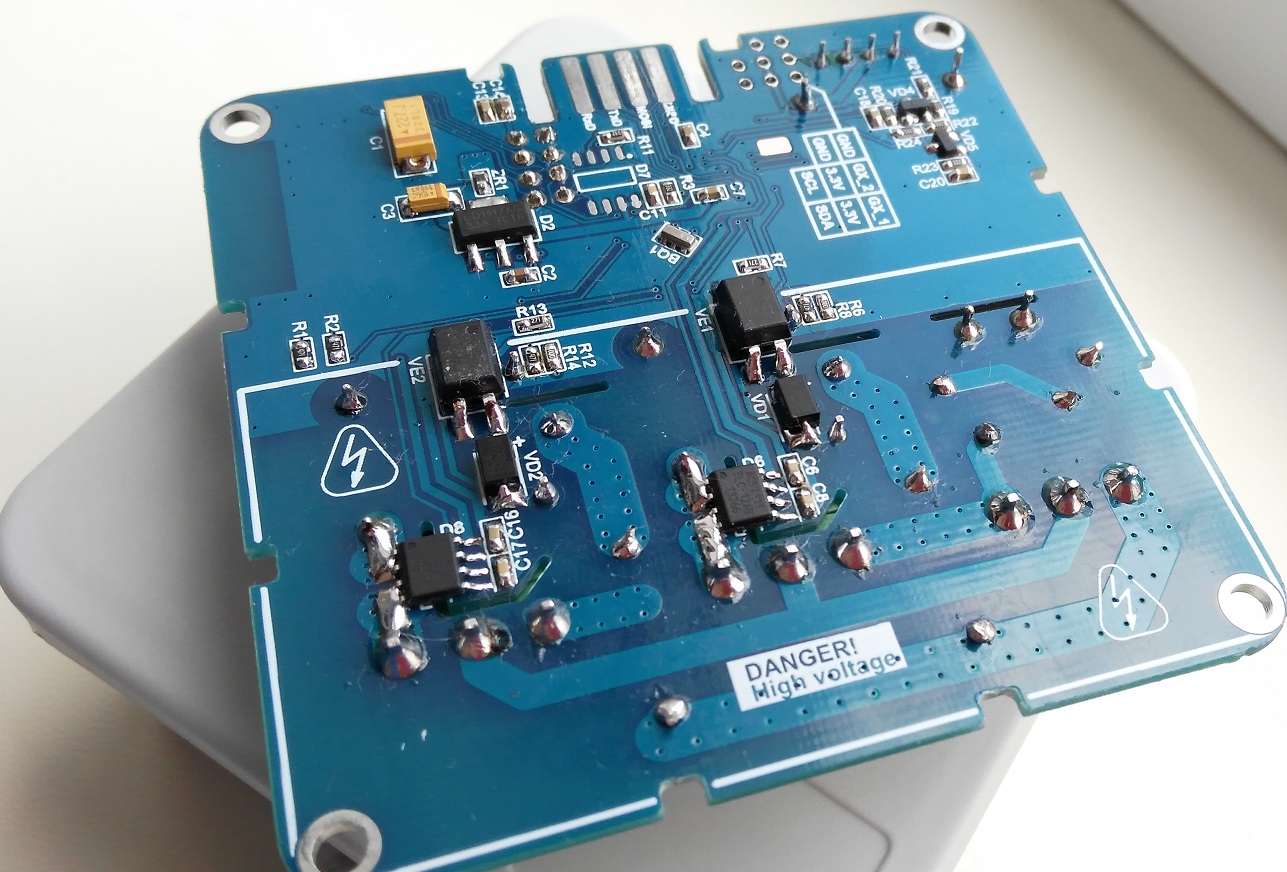

                        I have received pcbs and i am waiting for components now for device testing.
                        PCBWAY.com sent me pcbs in less than 2 weeks, as always super quality, thanks to them!

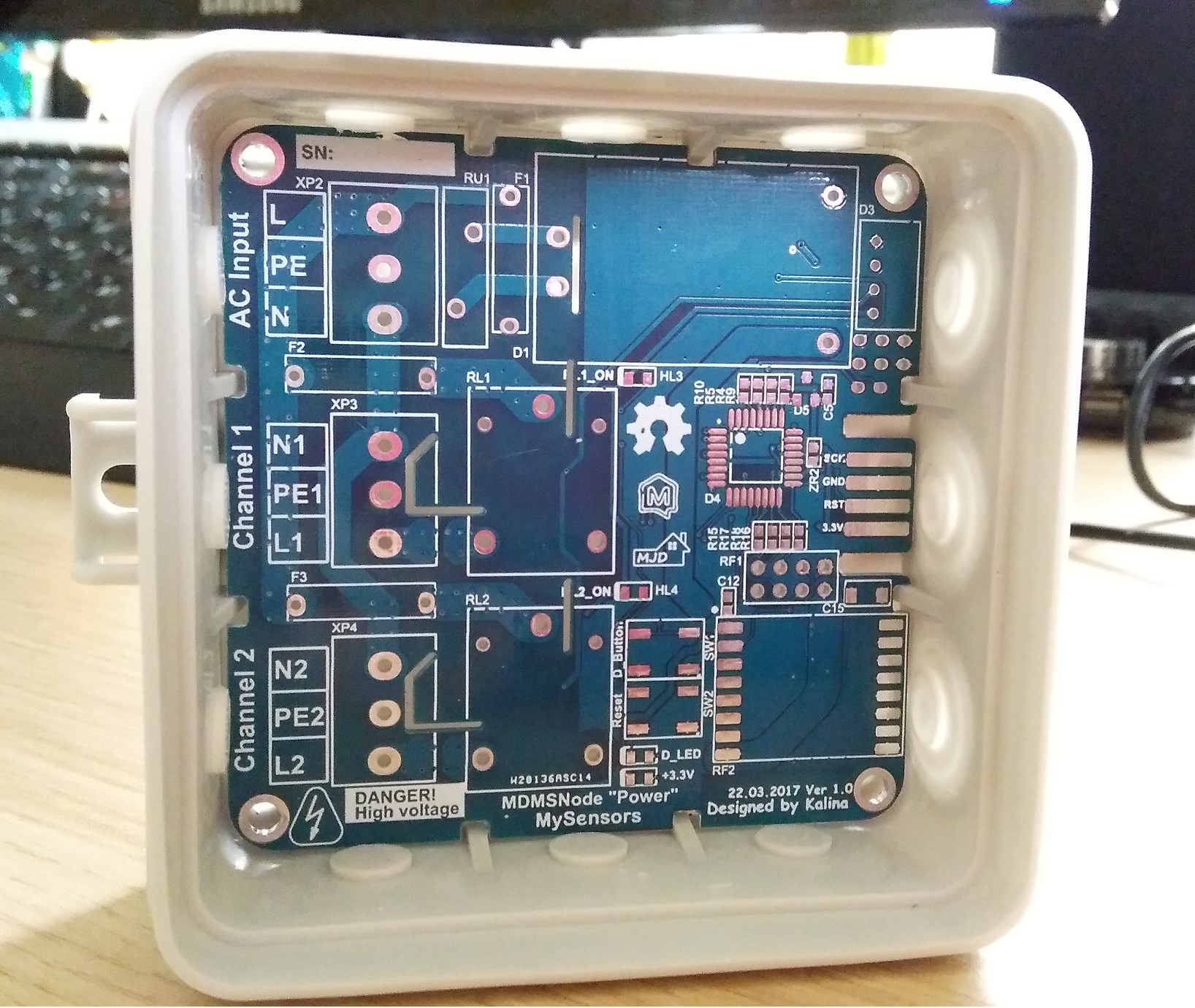

                                Luckily, the device has started up without problems. Yesterday I tested it, even the kettle worked through the device (9A). Now I can share the source files of the project (already are refreshed).
                                3_1495287454163_MDMSNode_Power_11.jpg 2_1495287454163_MDMSNode_Power_10.jpg 1_1495287454163_MDMSNode_Power_9.jpg 0_1495287454163_MDMSNode_Power_8.jpg

                                    @kalina what is the purpose of the vias on the AC traces? Thermal relief from the components on the other side?
                                    kalinaK 1 Reply Last reply
                                    • S sundberg84
                                      kalinaK Offline
                                      kalinaK Offline
                                      kalina
                                      @sundberg84, vias connect the AC traces on the TOP and BOT layers (see picture). This was done for reduce resistance of the conductors and distribute the heat caused by the flow of large currents through them.
